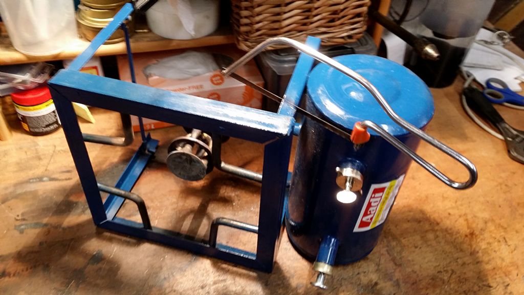

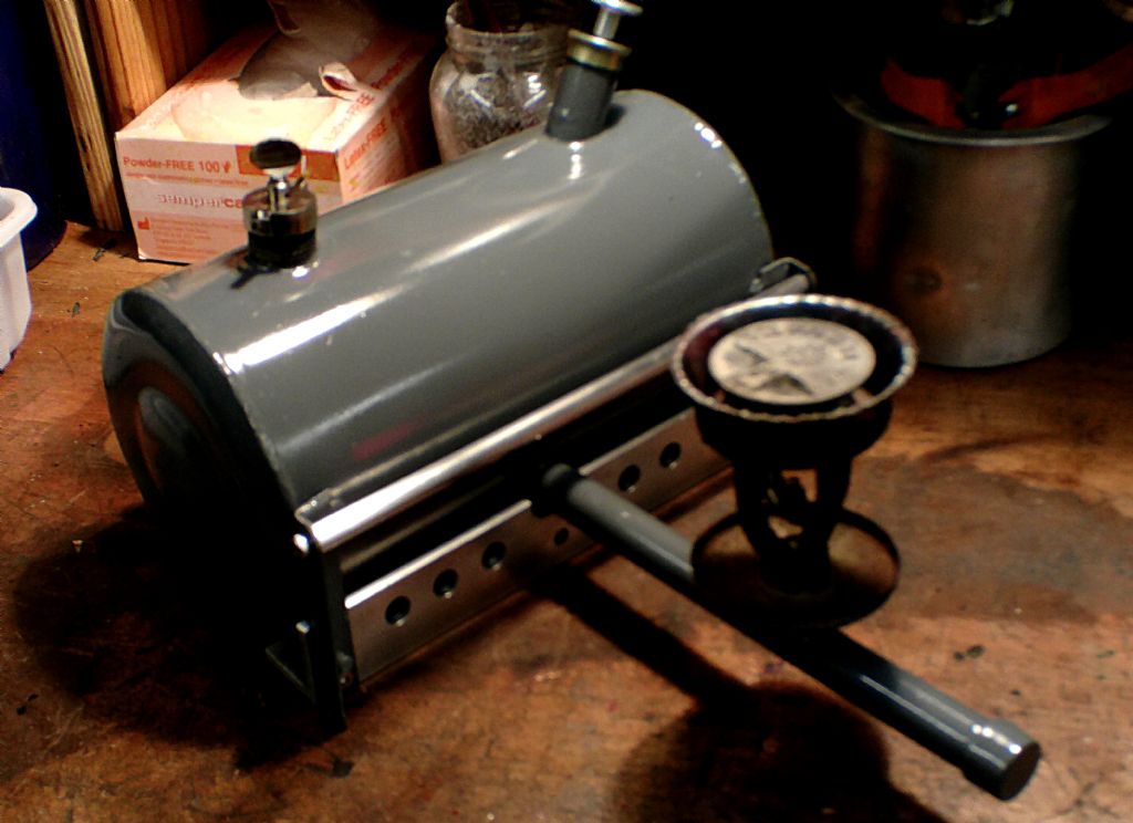

          The customisaation of the kerosene stove starts here:
          #404265
          gary arthur
            @garyarthur48070
            Some progress with the kerosene burner:
            #404392
            gary arthur
              @garyarthur48070
              Kerosene burner assembly and tank completed:

                It might have been a good idea to pause there, but no – I had to go and order this:
                https://www.amazon.co.uk/dp/B00JQ2DG4A/ref=pe_3187911_185740111_TE_item
                It's a multifuel pressure stove which will run on a variety of fuels, including (according to one reviewer) meths if the hole is enlarged in one of the spare burners. Couldn't resist it, even if just for comparison to the Indian pressure stove, though hopefully it will prove to be a good companion or alternative to it. And I think it will look great with the orange paint removed from that bottle and the aluminium polished up…
                Edited By gary.a.ayres on 24/04/2019 23:53:06

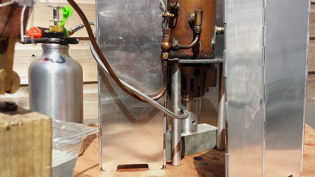

                      I tested the multifuel burner on alcohol with the boiler and small oscillator:
                      The engine ran, but not brilliantly and not for very long. That said, it was quite a windy day and the camping windshield you can see in the photo could only offer so much protection.
                      My fuel tests are nearing their end. At this point I can say vapourised kerosene definitely, gas definitely and vapourised alcohol maybe. I have decided to forget about coal until I make or buy a bigger boiler. The next step is to complete the boiler with a finished stand and proper mounts for the gas and alcohol burners, then to insulate the boiler. I don't think the system can be properly evaluated until the boiler is insulated.

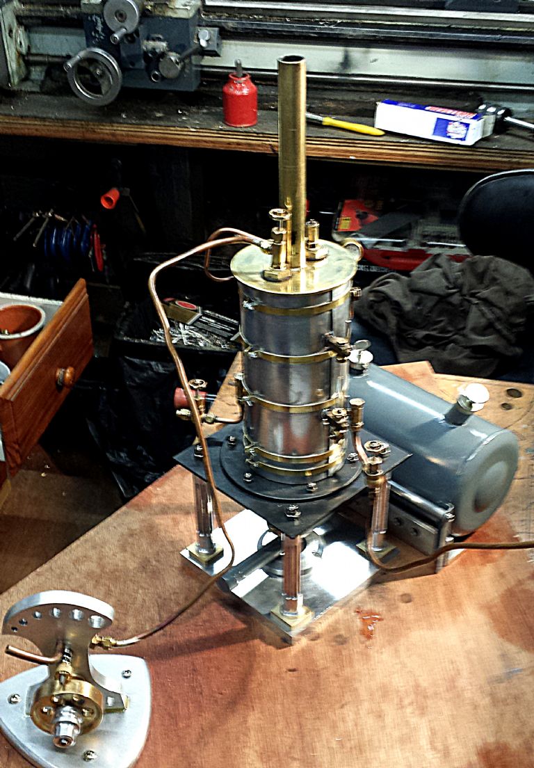

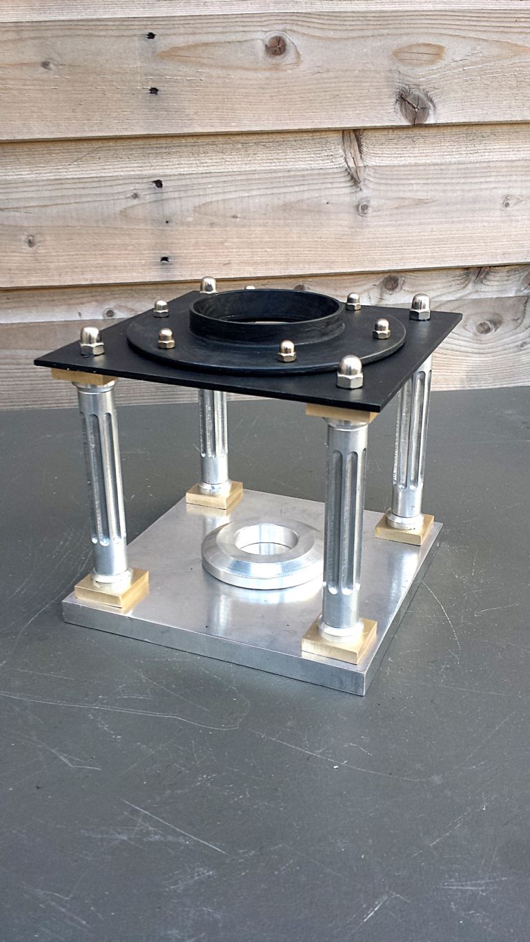

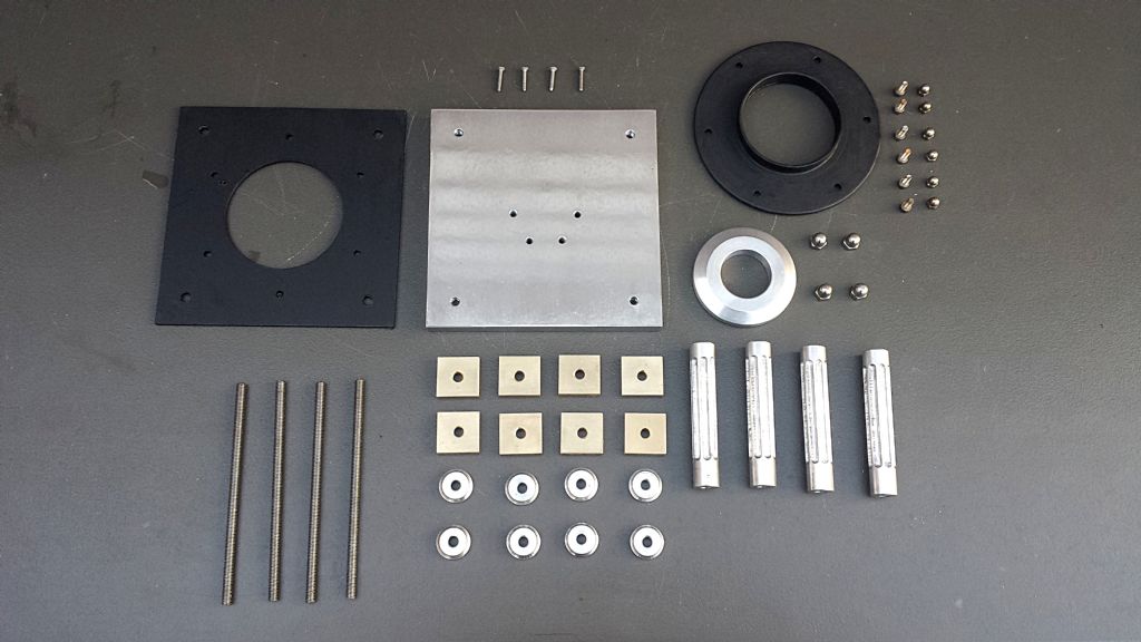

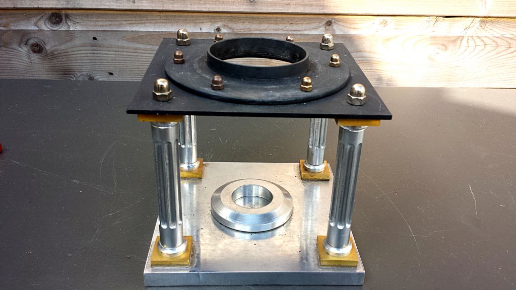

                        After some time out dealing with other things, I got back into the shop and made a stand for the boiler:
                        Off on holiday for three weeks, but aim to start insulating the boiler when I get back.

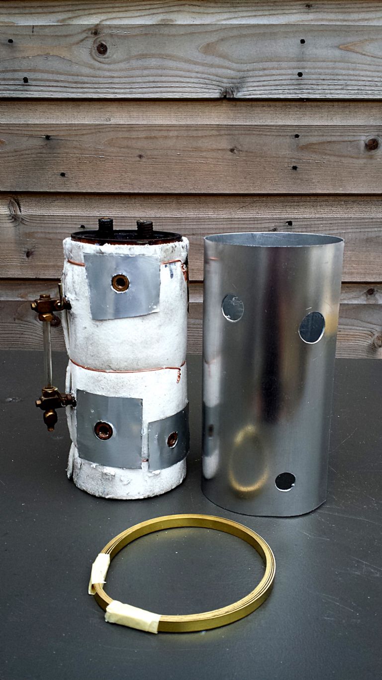

                        #424884
                        gary arthur
                          @garyarthur48070

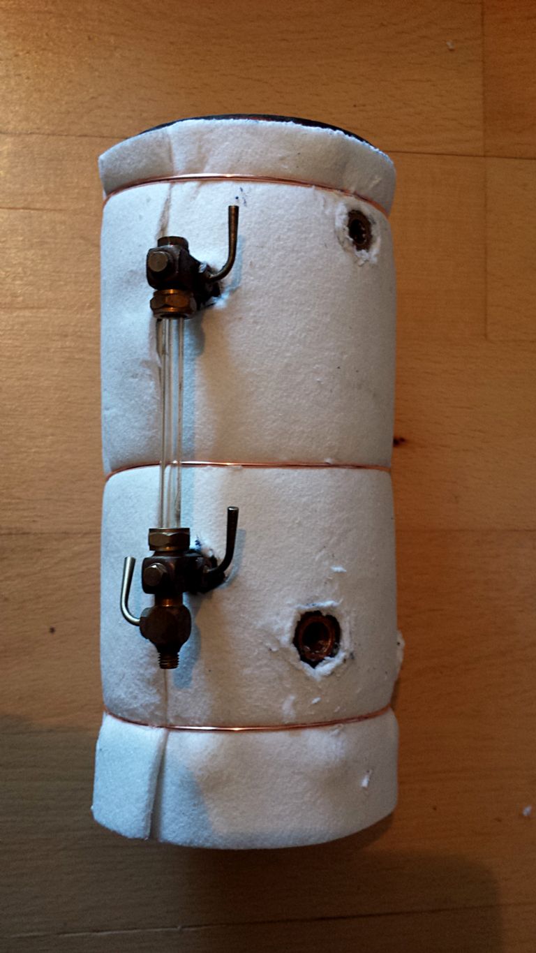

                          I have now begun the process of insulating the boiler. The ceramic fibre sheet was cut to size and holes marked using a cardboard template. It was then secured to the boiler barrel with thin copper wire:
                          The plan is to cover this with an outer shell made of thin aluminium sheet.
                          Edited By gary arthur on 18/08/2019 16:25:09

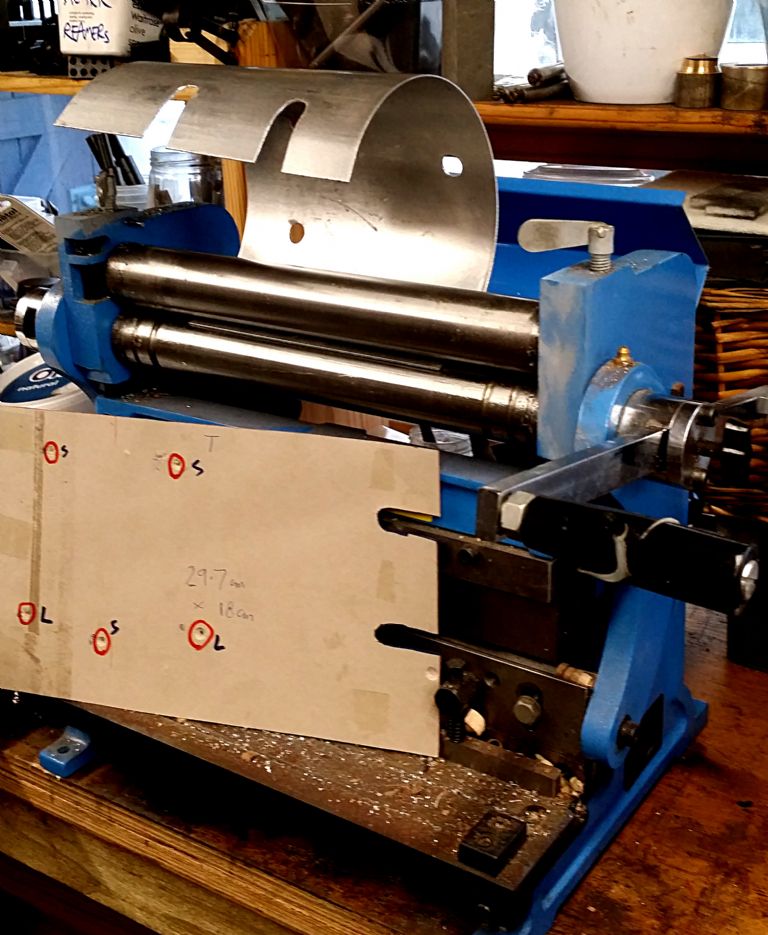

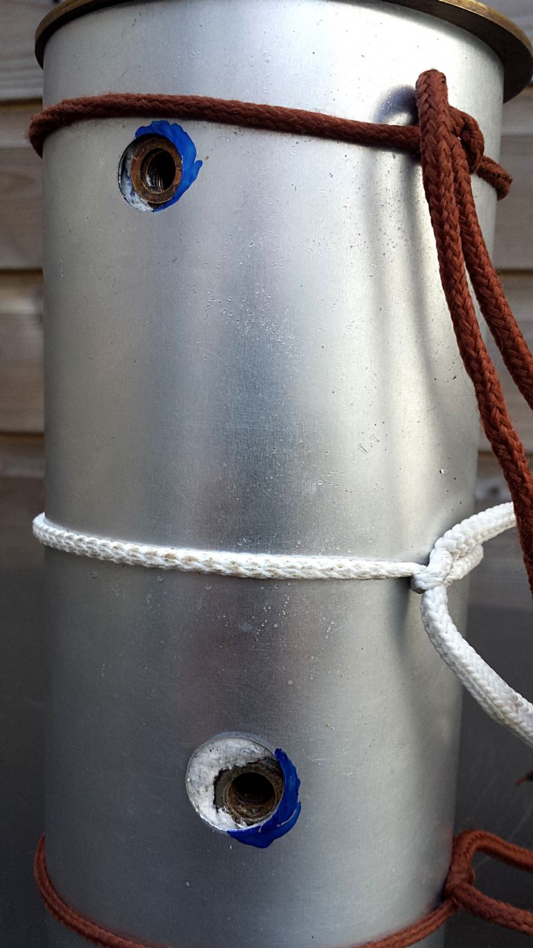

                          #425423
                          gary arthur
                            @garyarthur48070

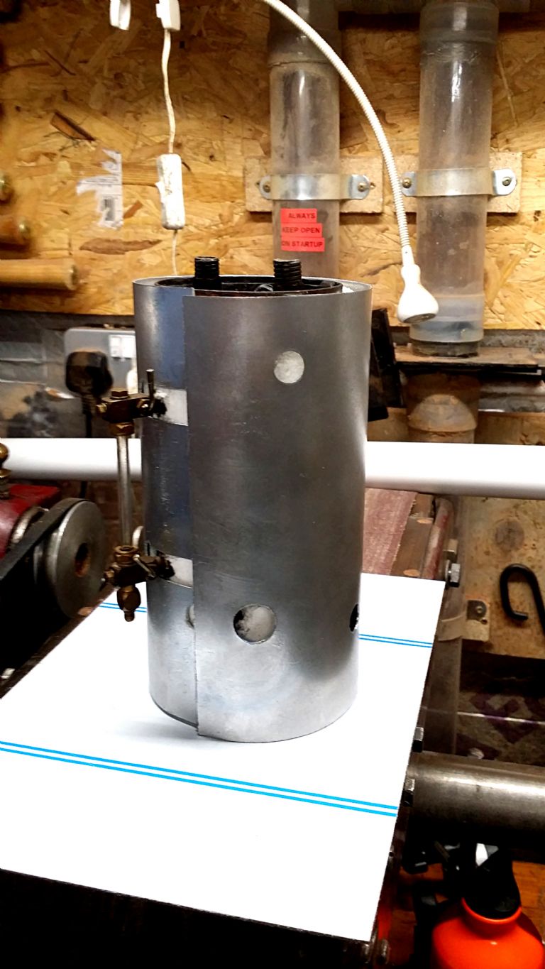

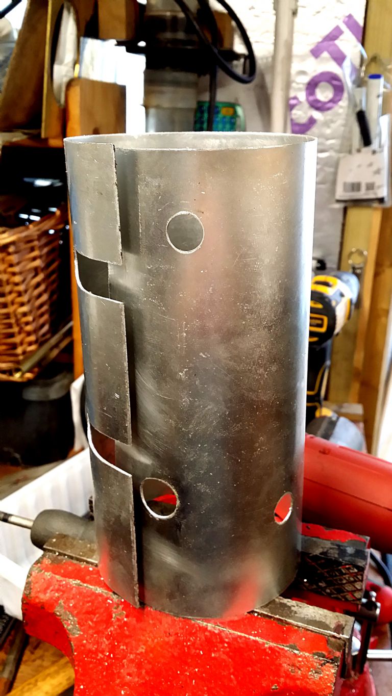

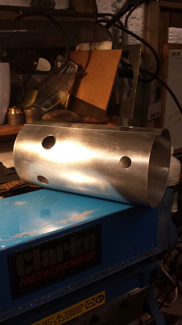

                            Starting work on an aluminium outer shell. The idea is to tighten and secure this with three circular brass bands, and to polish it all up to make it gleam:

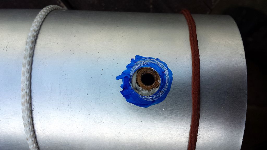

                            #426007
                            gary arthur
                              @garyarthur48070
                              Unsurprisingly, the holes didn't line up exactly with the bushes when I tightened the shell to the boiler:
                              So I sketched a circle around each hole concentric with the bush…
                              … and then removed the shell and opened out the holes using a round file:
                              The holes are now a bit too big, so I plan to cut pieces of thin aluminium drilled to fit neatly over each bush behind the shell to cover up unsightly gaps through which the insulation would be visible.
                              #426074
                              Essm
                                @essm
                                Hi Gary
                                I'm going to be starting the cladding shortly for my boiler and am also considering aluminium.
                                Your sheet looks quite thick – can you tell me the exact size please?
                                Thanks
                                #426075
                                gary arthur
                                  @garyarthur48070
                                  Hi –
                                  it's 1 mm thick.
                                  The supplier also had 0.8 mm thickness and I would have preferred that, but he had a small offcut of the 1 mm which he cut to size for me and charged me a fiver.
                                  If I had gone for the 0.8 he would have had to cut into a full sheet which would have cost more. Normally I'm happy to pay a bit more for the right thing, but I figured that in this application 0.2 mm probably wouldn't make a great deal of difference.
                                  Cheers,
                                  gary

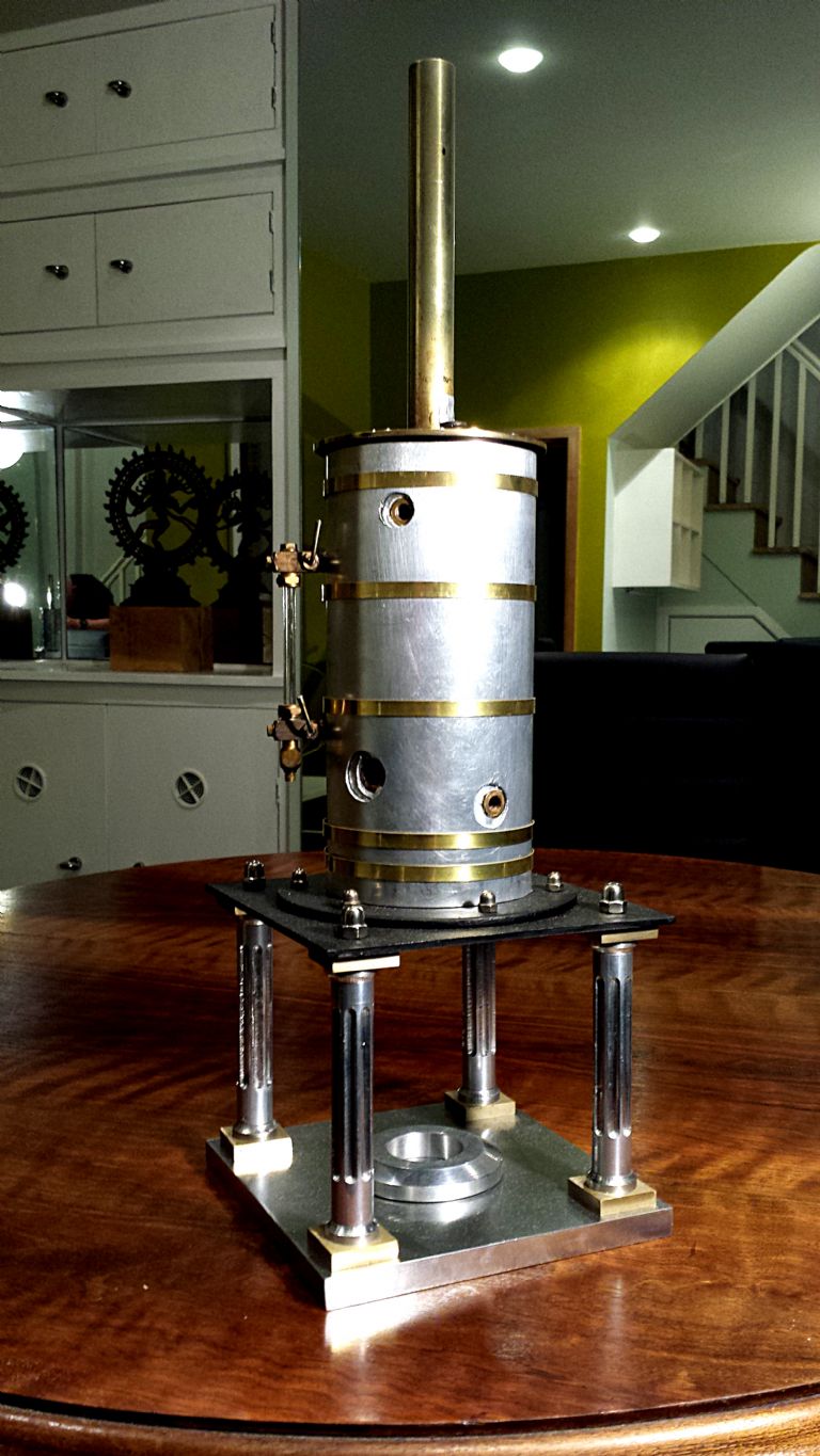

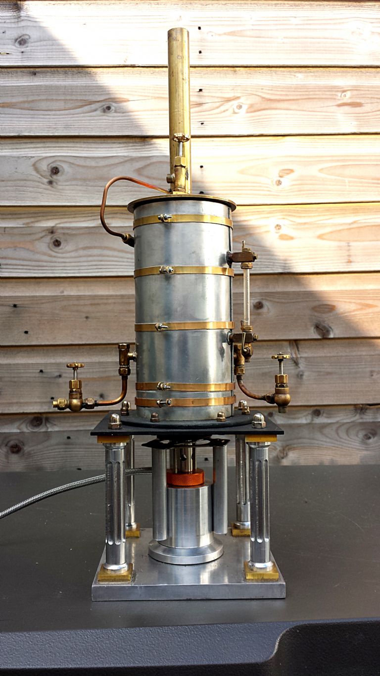

                                      gary arthur
                                        @garyarthur48070
                                        Following on from the posts above, the following is self-explanatory:
                                        And below, assembled and on its stand. The holes and bushes still don't line up perfectly, and the banding could be tidier, but overall I think it's reasonable and aim to keep going forward. I'm looking forward to seeing how it performs now that it's insulated. I couldn't decide which of the two pics below I like best, so I posted them both:
                                        Edited By gary arthur on 26/08/2019 22:04:00

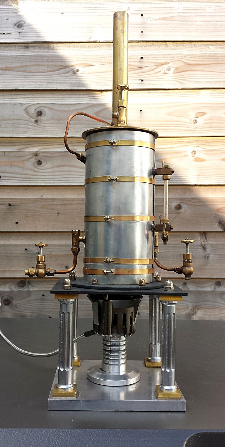

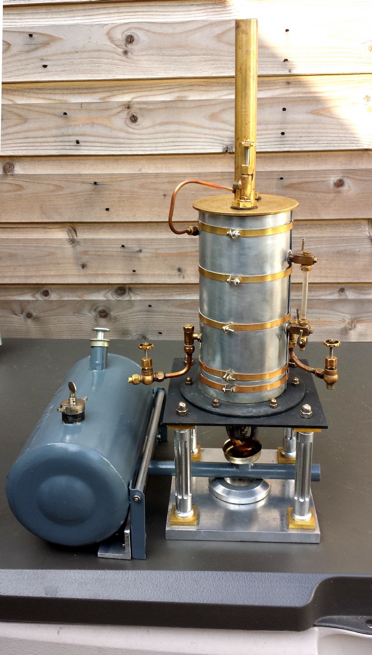

                                        #426986
                                        gary arthur
                                          @garyarthur48070
                                          Sorry about the dreadful picture quality, but you get the idea…
                                          The boiler complete with insulation and outer shell, running the engine on pressurized kerosene. Also ran it on gas and on pressurized alcohol – good results on all counts.
                                          Giving up on the coal idea with this small boiler – that will wait for a bigger boiler in due course smiley.
                                          Just support pillars to make for the gas and alcohol burners and this stage of the project will be finished.
                                          Edited By gary arthur on 01/09/2019 17:17:39

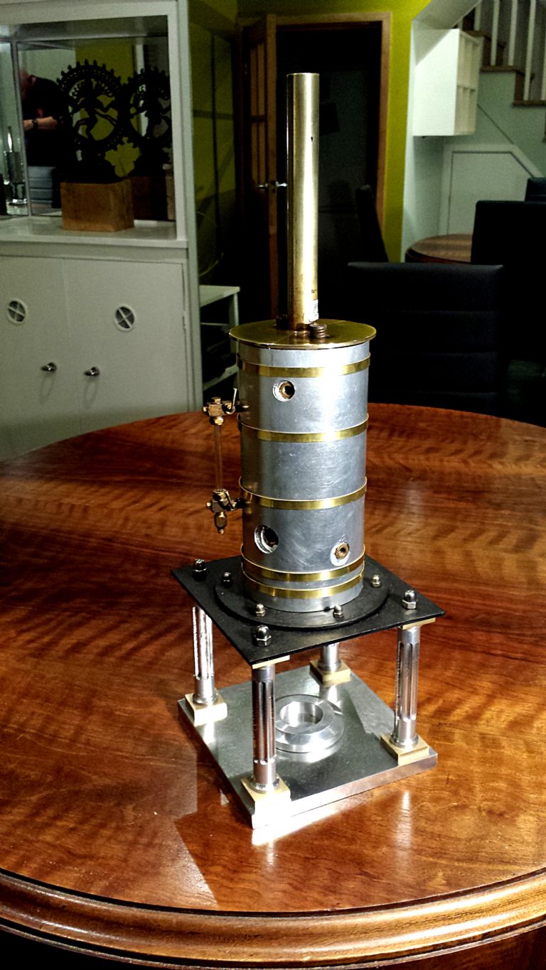

                                          #427353
                                          gary arthur
                                            @garyarthur48070
                                            Up and running, and steaming nicely. Almost finished now…
                                            Edited By gary arthur on 04/09/2019 02:18:31

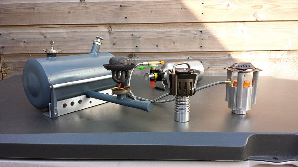

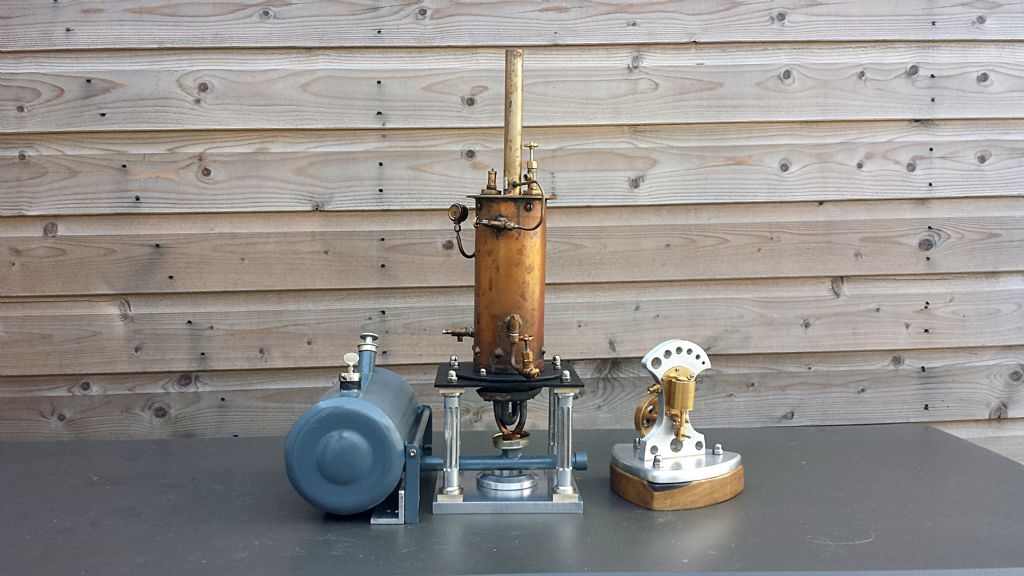

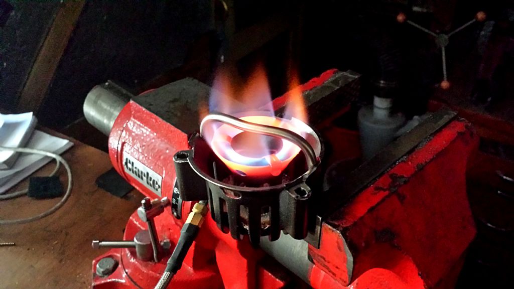

                                              Finally, the three burners of choice for the boiler:
                                              All customised from cooking stoves.
                                              Left: Indian pressurised kerosene burner.
                                              Centre: Pressurised alcohol burner hacked from kerosene pressurised camping stove with the nozzle drrilled out to 1 mm for alcohol.
                                              Right: Gas burner from camping stove.
                                              There is a locating ring fixed to the base of the boiler stand (screwed on from underside):
                                              The ring is superfluous when using the kerosene burner as the burner is self-supporting:
                                              The other two burners, however, drop neatly into the ring, which prevents them from moving away from the central position under the boiler and from toppling over due to drag on the fuel supply tube:
                                              All three burners raise steam effectively, so it's mix and match.
                                              I now consider the boiler to be finished, so – apart from a youtube video on the burners which I shall post in the near future – this thread is drawing to a close.
                                              To everyone who generously offered their addvice (and in particular Duncan, who kindly offered to send me some bits and pieces) – my sincere thanks. Your help has been invaluable.
                                              All the Best,
                                              gary
