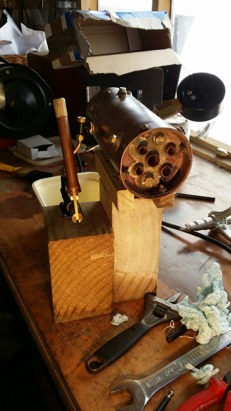

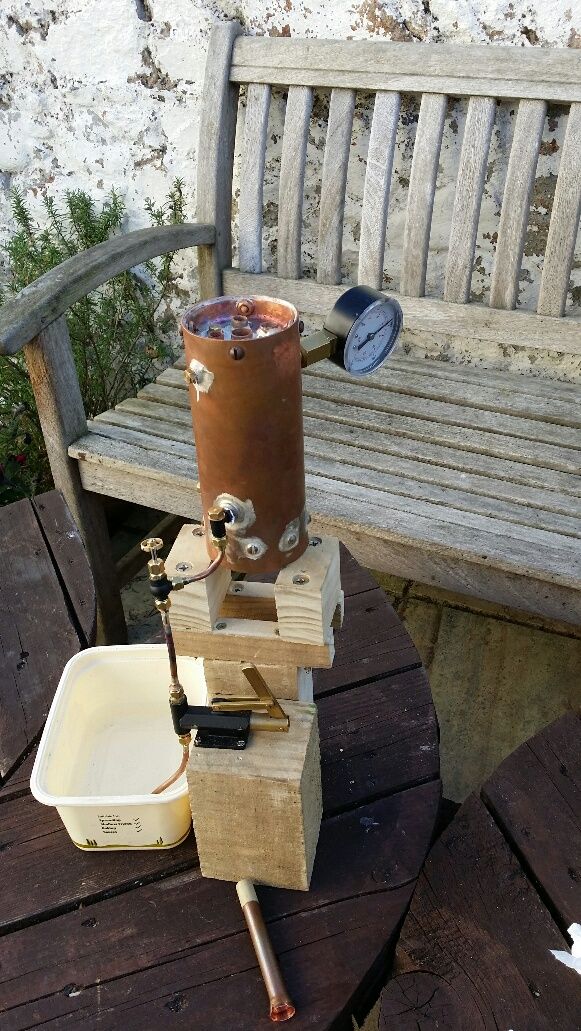

          Hi again…
          here it is all set up and ready for pressure testing with water… tomorrow!
          All I did afer taking this photo was to silver solder on the pipe unions.
          Tomorrow will either be a good day or a bad day for me…

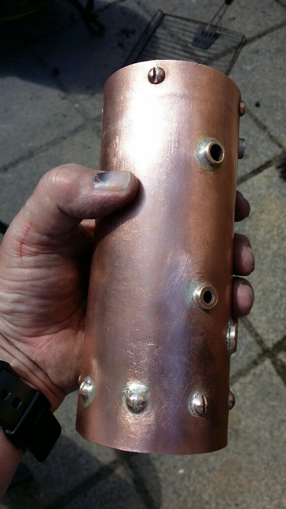

            Well…. not the outcome that I was hoping for today.
            During the initial air test at 15 psi a couple of weeks ago it was apparent that there was a small leak where one of the fire tubes joins the end plate at the top of the boiler. I mechanically expanded the end of the tube which seemed at the time to do the trick as the boiler held 15 psi of air after that.
            Today, however, under hydraulic testing to 90 psi that leak has come back to haunt me. I suppose that given this is my first effort I should be a bit pleased that there appear to be no other problems. However, this leak has to go. Further attempts to mechanically swage the tube end (without heat) have only made the leak worse, and it is now dropping from 90 to 45 psi in 30 seconds. I could fiddle about with it more but I'm afraid of stressing the end of the tube. The photos below show the problem – it's the tube at bottom right, marked in blue. You can probably see the stress marks inside the end of the tube but fortunately there doesn't seem to be any leakage on the inside, just round the outside where it joins the end plate.
            My thought is to try to deal with it by caulking it with a ring of low temperature silver solder round the outside of the tube. I used medium temperature silver solder initially on that part of the boiler so my hope is that if I can do it this way I might be able to avoid disturbing other joins which seem to be ok at the moment. I'm also thinking of using my small portable oxy-mapp torch (instead of the big bad boy) to keep the heat as local as possible.
            Does this seem like a reasonable plan under the circumstances? Or do any of you good people out there know of a better way for me to tackle it?
            Photos:
            Thanks…
            gary
            Edited By gary.a.ayres on 26/06/2018 15:49:43
            #359584
            julian atkins
              @julianatkins58923
              Hi Gary,
              The proper repair would be to thoroughly clean and flux generously all over and re-silversolder the leaking tube. This is not difficult to do on a boiler like yours, though expanding the tube is with hindsight is not the correct procedure, and you will probably not get a penetrating joint, but you should aim to form a generous fillet. A loop of copper wire around the protruding end of the tube might assist in this.
              Cheers,
              Julian

                Julian – thanks for this.
                Now I'm wishing I hadn't expanded the tube, but as you say hopefully a fillet will do the trick instead.
                I did wonder about adding some copper, and will think about the wire idea.

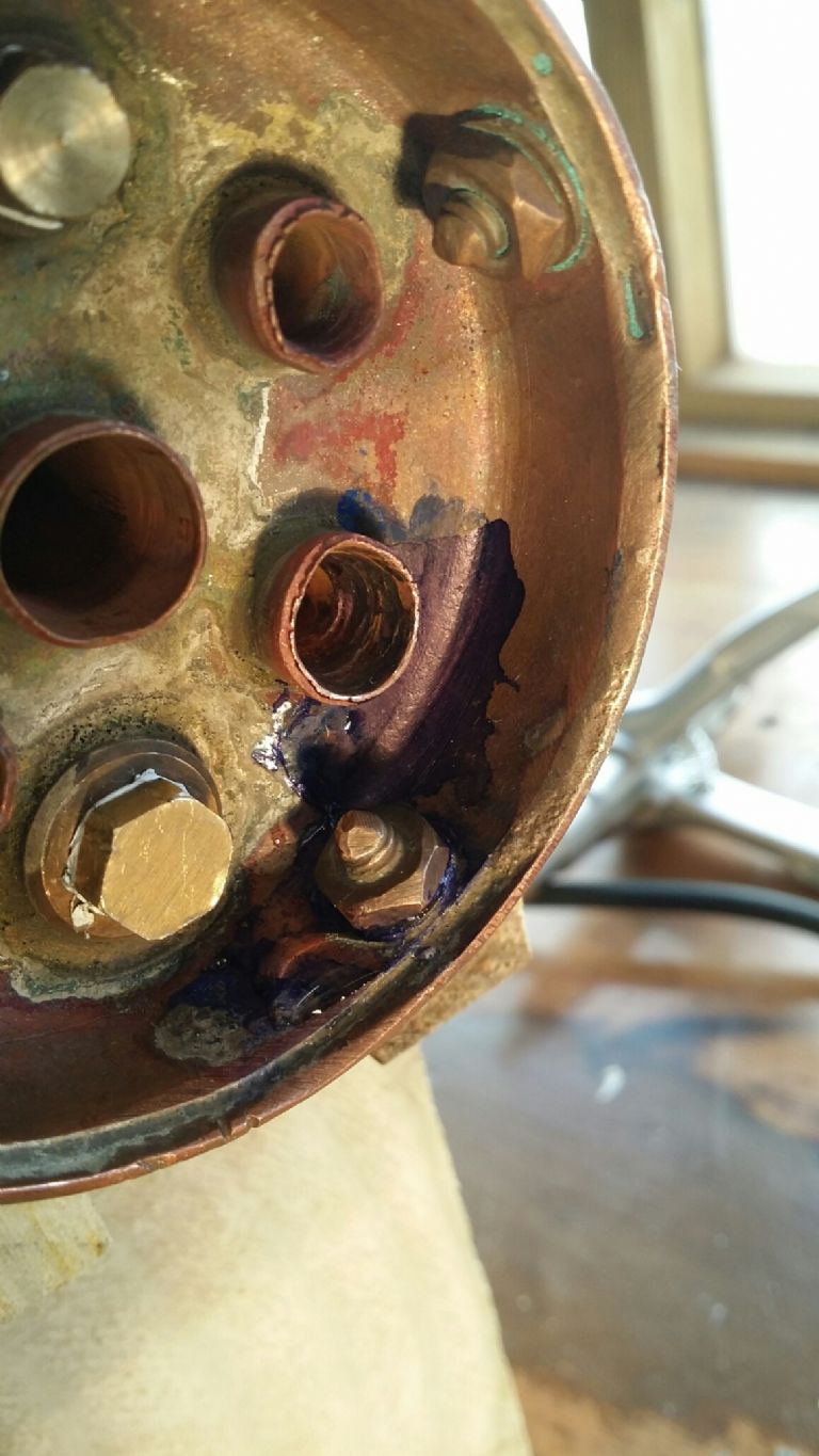

                        Hi –
                        Following an experience with a leaky check valve during my first hydraulic test, I followed advice and took two remedial steps: replacing the steel ball in the check valve with a nitrile one, and adding a globe valve between the pump and the check valve. This really did the trick, and the result was version 2 of my test rig which has no leaks in the water feed system. When that globe valve is closed, it's closed! Photo below.
                        And now the bad news: the improved system showed clearly that what I had thought was a repair was an improvement, but not a repair. The offending tube still leaks, albeit more slowly. During the test, the pressure dropped from 90 psi to 78 psi over a 30 minute period – better than it was, but a leak nonetheless. The photo below (top left tube) shows the problem – there is a gap under the fillet which I added, probably due – I think – to insufficient heat during the attempted repair. My plan is to reheat it and try to melt the solder which is already in place so that it will flow around and into the joint more than it has. The boiler is now back in some new pickle for 24 hours to get it as clean as I can prior to reheating it, hopefully tomorrow evening. I will, of course, use plenty of flux and follow the previous advice on giving the whole thing an overall background heat with propane before focusing on the flaw with oxy/mapp.
                        However, if anyone has any other ideas I'd be happy to hear them.

                          Yep lack of heat in the tubeplate, you have only got the end of the tube upto heat.

                              You will find that once red hot, adding a bit of fresh silver solder will help the existing lump to melt.

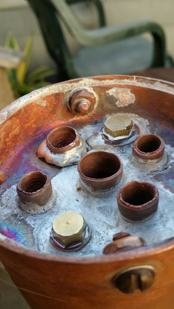

                                  Well, for reasons which I can't quite figure out I had a struggle with my torches but somehow managed to get the joint looking good.
                                  I *think* the boiler may now be intact but am unable to test it as I sheared off the end of my pressure gauge adaptor when I was tightening it! I'll have to make another one but am going away for a couple of weeks on Saturday so it may have to wait until I get back.

                                    At last!
                                    Successful hydro test today! The boiler is now sorted.

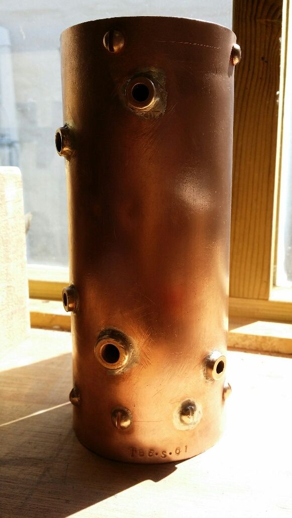

                                        Following an initial cleanup with files, Scotch-Brite and steel wool:

                                          However, I have just taken the black paint off all my fittings with acetone in favour of an all-brass look, and have made a start with Loctite threadlocker. My first experience with the stuff, but it does inspire confidence I have to say.
                                          One slight issue faces me before I can go on to the second hydro test: way back when I was silver soldering in my bushes, I left brass blanking plugs (connected by a steel strip) in the two water gauge bushes in an attempt to keep them parallel. In my inexperience I didn't realise that the brass would be prone to melt, but the plug in the top bush did so. I had to drill it out and for reasons I can't now remember I ended up having to drill and tap it 5/16 instead of 1/4. I then made a threaded sleeve to reduce it back down to 1/4. This seemed ok, but tonight the sleeve sheared when I was trying it out. The upshot is that I'll have to make another one. I'm not overly worried about this as I'm pretty sure that with the Loctite it will be fine, but it's all more time of course…
                                          Will keep chipping away and will post significant developments.
