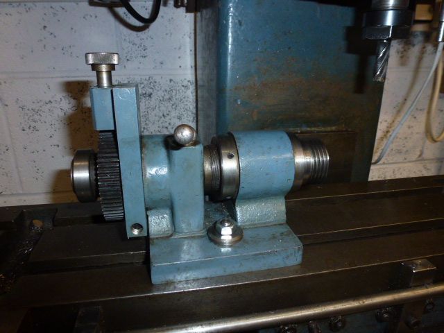

      Hi All,
      Many months ago I saw a drawing or photo of a setup that used a change gear and a plunger on a shaft to index a 3 jaw chuck,on the other end of said shaft by an amount of teeth (I may have imagined this!)
      I've tried the search function but to no avail. Can anyone point me in the right direction please?
      Paul

            That is certainly the same principle but I'm thinking of a 'stand alone' version that I can use on a mill as a crude 4th axis.
            Maybe I saw that thread and and though I could adapt the idea for use on a mill, i really cant remember!
            Regards.

                        p1020823.jpgCouple of photos to show my dividing arrangements made years ago.
                        One shows a detent plunger / change-wheel for my Boxford. The gear is on an expanding mandrel fixed in the lathe spindle bore. The spring loaded plunger mounts on the banjo, thus a wide range of change-wheel diameters can be accomodated. A 60 T is shown but I've used a 180 T to make protractor dials for a telescope mount.
                        The other picture shows a spin indexer I made when I first acquired my Raglan mill. The spindle is 3MT and has a Boxford nose. A 60 T change-wheel is mounted at the other end. The spindle can be locked. I can't remember where the casting came from, but it could also be fabricated. it may have been inspired by something in ME.
                        These items were made when commercial dividing equipment, rotary tables etc. was wellp1020819.jpg beyond the average model makers budget. Different now.
                        Edit; the lathe picture has somehow got flipped, but the idea's there.
                        Edited By Clive Brown 1 on 05/09/2020 11:32:30

                            Clive, the one on the mill is exactly the application i had in mind. Thank you.
                            Thank you to everyone for the comments and suggestions.
