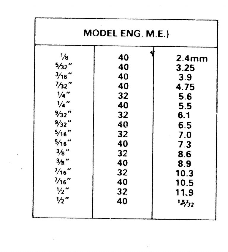

                        Just had a look & I have 2… 1980 &01995. According to Amazon latest revision is 2008 @ £5.20. some reviewers have stated they have 2010 & 2020 version ??.
                        R Johns; if its of help … scan of a chart ME tapping sizes
                        George.
