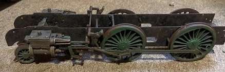

                  s-l500

                    The frames look similar to a D49 but i thought they had walscherts.

                      Might be worth searching for Jackson Rigby who marketed models and castings under the JR models name in the 1920’s. I’ve seen a long time unfinished chassis for a JR 4-4-0 with walschaerts gear and there is a similarity in the cylinder block and valve guides. As stated earlier it was not unusual for builders to swap Baker gear for walschaerts , LBSC was a great advocate of the baker gear.
