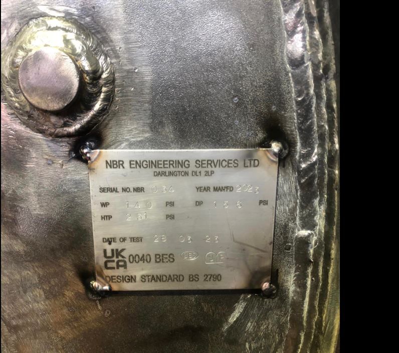

                  #654563
                    Plate from another model boiler maker on a 2023 boiler also shows BS 2790

                      There are several references in the interweb to BS 2790 being superceded by BS EN 12953, but looking deeper, others say it is still current.

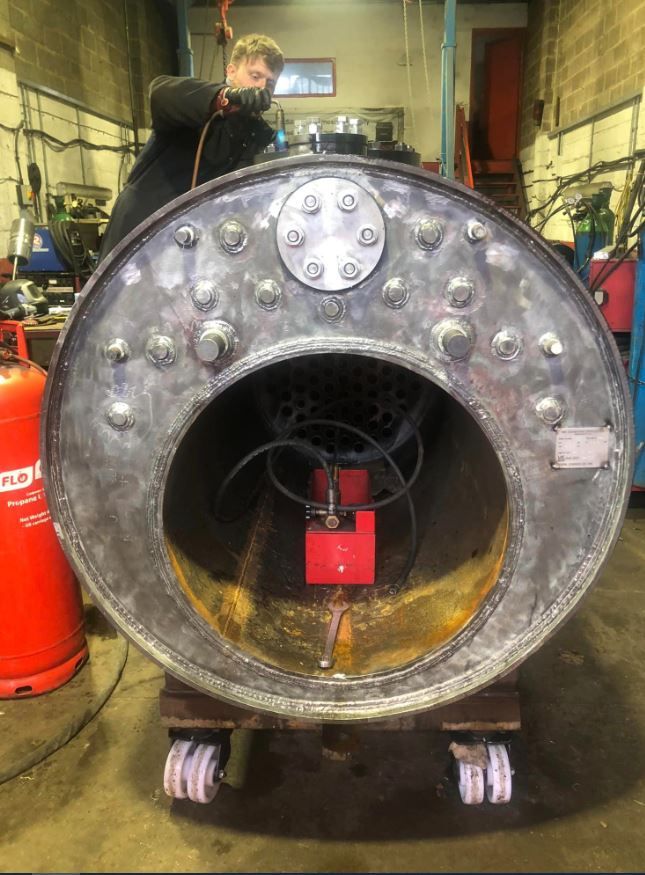

                                              BTW is anybody else underwhelmed by the welding on that boiler shown in Jason's post?
                                              Martin
                                              #654691
                                                Hell of a lot better than my welding!
                                                Whole boiler

                                                    I thought it looked a bit clumbsy Martin. Noel.
                                                    #654818
                                                    Dave Halford
                                                      @davehalford22513
                                                      I just think he needs a bigger blowtorch to fix the leak.
