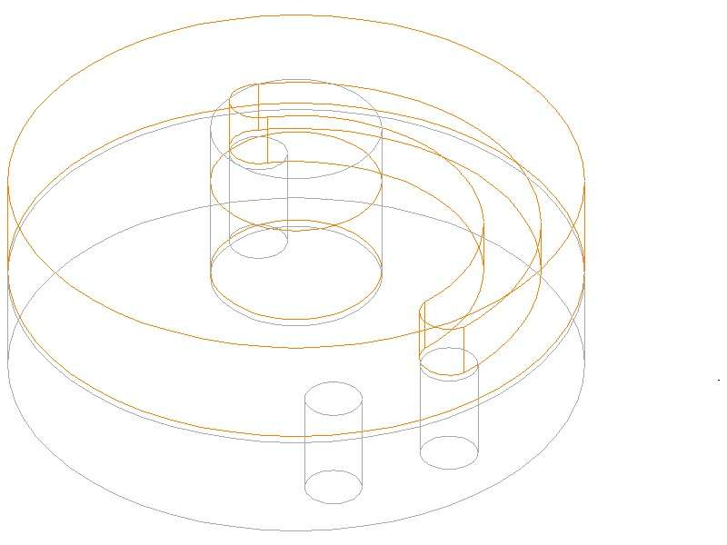

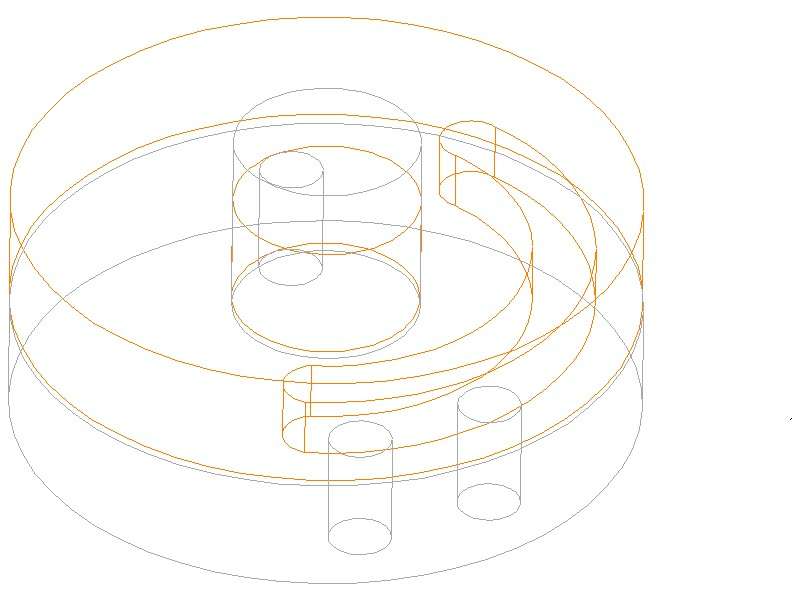

      I had a go at making a 3D image of my Vacuum-Brake Valve, this time in TC: Brakes OFF in upper, ON in lower, images. Far port: vacuum reservoir. Near right: train pipe. Near left: air in.
      In this case I made the static lower disc and the spindle as one piece.
      Assembling something like this in TurboCAD is harder than in Alibre. Nor as elegant as my Alibre effort, which makes the rotor look as if in tinted plastic, because the rendering does not have a translucency setting.
      Tender Vacuum Brake Sys w 3D
      Tender Vacuum Brake Valve ON TC 3D
        Doing this in TurboCAd is harder than doing it in any modern 3D CAD I would imagine Nigel.
        I tried it many years ago and I have no desire to ever go back and try again.   🙂

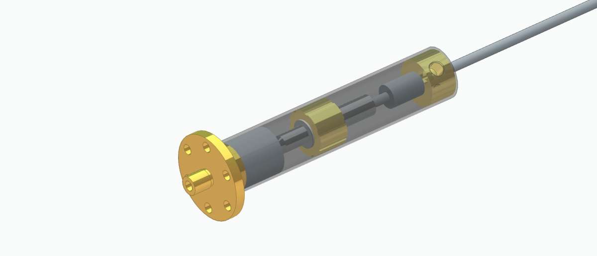

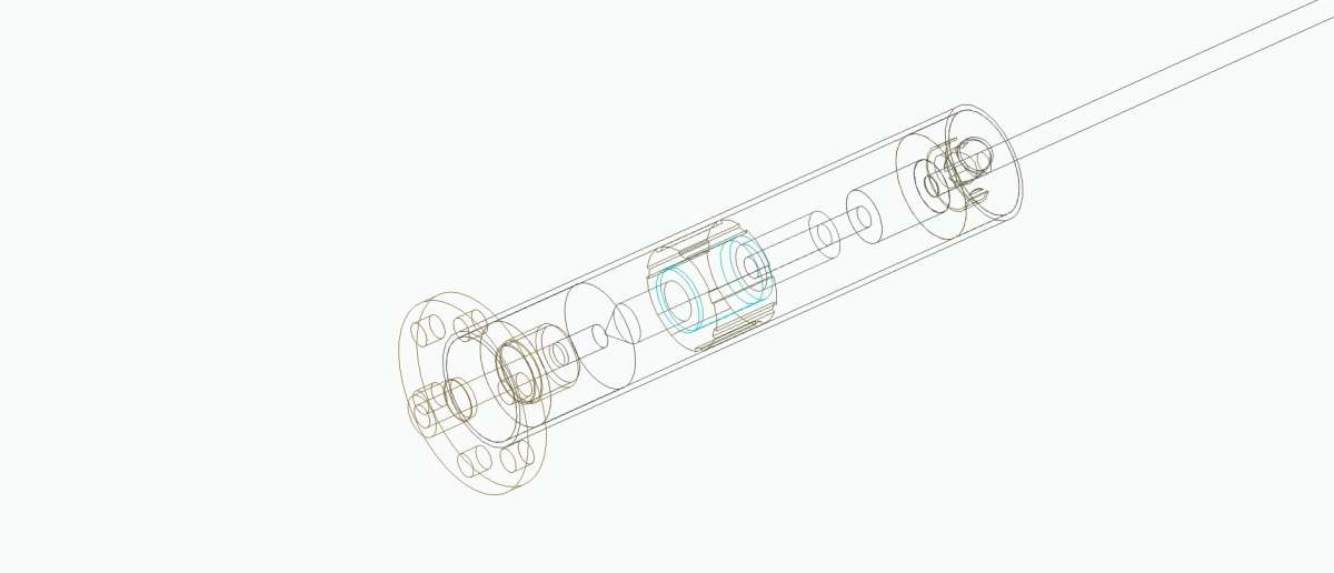

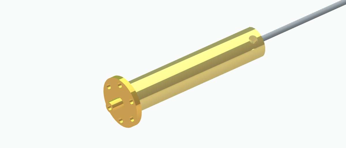

                    RegulatorBR_041125
                    RegulatorWF_041125
                    Regulator_041125
