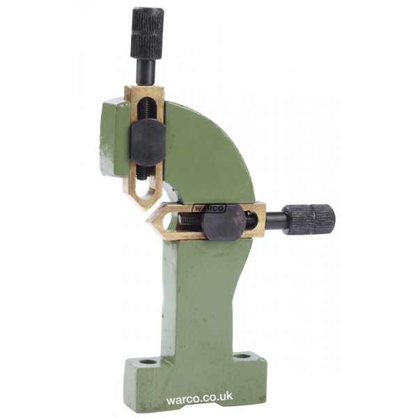

                    I can fit a piece of steel 6mm think and 37mm wide to the underside of the cross slide without fouling the bed. Will this be stiff/strong enough to support a travelling steady of this sort of design:
                    Mini Lathe Travelling Steady
                    The project that I think I need this steady for is to cut a 3/4 inch Acme thread on a 17" long 3/4 inch mild steel bar. This is to replace the screw that operates the vice on the Qualter and Smith power hacksaw that I am renovating. The existing screw and nut are completely knackered. I can't find anyone in Europe that can supply me with 3/4 inch 6tpi Acme threaded rod. I can get it from the USA, but the shipping costs are outrageous. I know that I could buy a metric screw and nut in Europe, but this will require more work on other parts of the machine. Am I right to think that there will be too much flexing in such a rod to be able to cut an accurate thread without a steady?

                            I would find a piece of steel or aluminium to attach to the saddle as an adaptor first. The exposed part of the saddle would have to be drilled and tapped for about 4 X 5mm screws, or 6mm if there is room. Then one of the steadies which come on the market fairly cheap would have to have its base cut off and be attached to the adaptor. For lining up purposes, just bring the fingers of the steady together, and make the point where they touch line up with the spindle axis.
                            Make sure the steady is attached to the saddle, not the cross slide.
