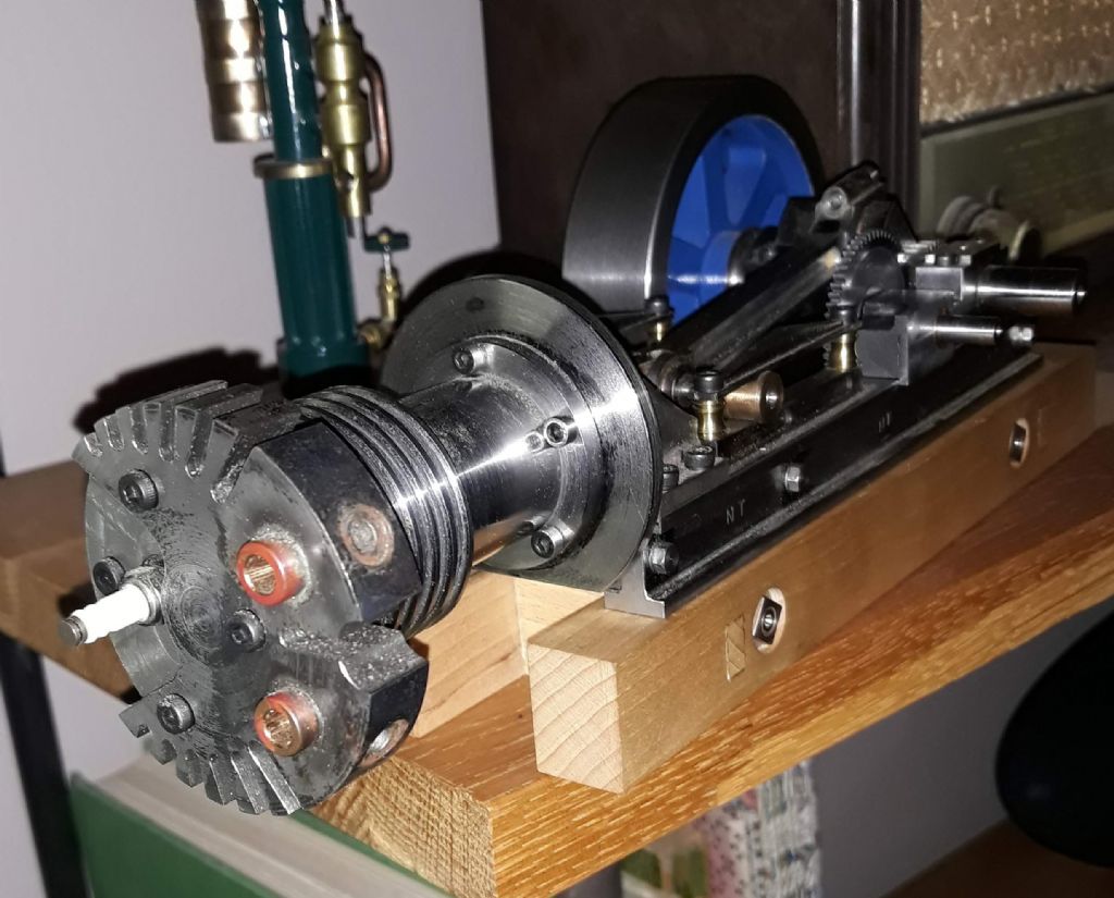

      I'm building a steam engine that has been converted to run on petrol. What I'm not sure about is how well it will run using eccentric cam drives?
      Has anybody tried this before?

          If 4-stroke then it is possible to use a "steam" engine type eccentric but you need a way to half the amount of times the eccentric moves as you only want the exhaust to open every other rev of the crankshaft. A "Star Wheel" is one method that was used on the early engines, an epicyclic gear box inside the eccentric strap is another. Or you simply need to add 2:1 gearing to drive the exhaust valve and a lobed cam.
          The inlet valve is easiest dealt with as an atmospheric one where it is held closed by a light spring and the suction of the moving piston on the induction stroke will pull it open drawing the fuel/air mix with it, again found on most open crank engines so typical of this type of engine.

              The eccentric will result in a sinusoidal motion and simple comparison to a cam profile shows it is close. I will see if I can do a full comparison.
              I have made a 2:1 reduction drive to the camshaft, early picture below:
              Gears were cut using an Amadeal XJ12 mill and Warco HV4 rotary table

                    Simply leave a large tappet gap between rocker arm and valve stem, this will make part of your sinusoidal motion zero where there is a gap and then a peak where the rocker and valve are in contact. It won't give the quick opening and closing times of a lobed valve but will work. I would still make the intake an atmospheric one as then that will open and snap shut faster.

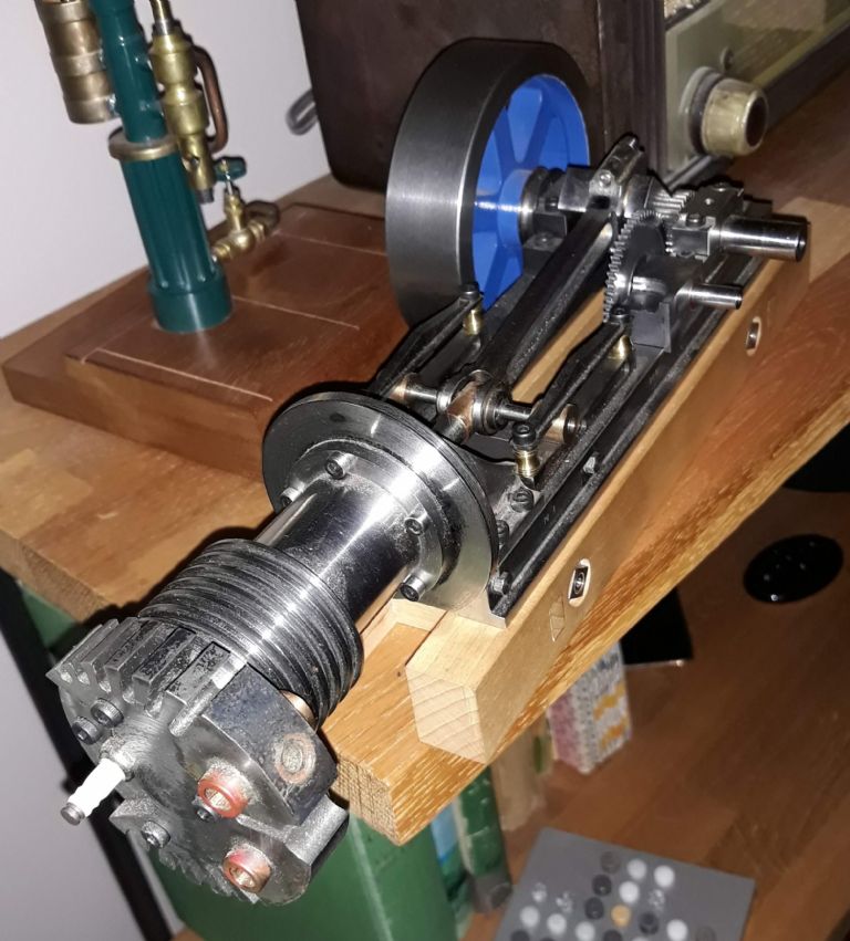

                              I like the idea of the tappet gap, trouble is my current head design is for a sliding valve, with an air-cooled head and cylinder – I might have to change this and make this more "steam-enginish" (happy if you can moderate this to a real phrase!).
                              I'll add some images of the current head and cylinder design.
                              #371901
                              Nigel (egi)
                                @nigelegi
                                An image of the current engine, shows the air cooled cylinder and head, intention is to have sliding intake and exhaust, but based on the exchanges in this forum I might make a different cylinder, head and intake/exhaust system
                                a second image of the engine at a slightly different angle so that you can start to get a feel for it
                                I will post some more images as I start to change the design.
