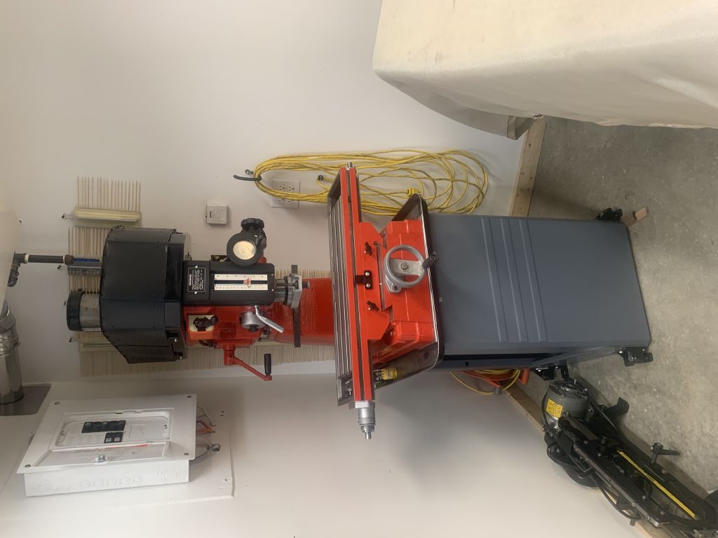

        I just finished restoring a used milling machine, and i am still learning all the ins and outs of the tool.
        how does one tram a milling head like mine? Do i use shims on the base of the post? How often does one need to tram the actual machine?

            Craig Brown
              @craigbrown60096
              Hi Jeremy
              That's how I did mine, by loosening the post from the base and sliding shims in left or right, front or back. It's also how it was done from the factory as I found small shims in there when I first did mine. Its quite a long winded process doing it this way but as far as I'm aware your only real option. I have only done it once but to be fair it's not bang on and could use an adjustment.
              Hope that helps, Craig
              #481364
              ChrisB
                @chrisb35596
                Don't know what type of mill yours is, so it could have a specific tramming procedure. When I trammed my WM18, which is a very common vertical column mill design, I could not get the head nod right and there's no adjustment for that. The only solution was to shim the column as mentioned above or shim the head. I opted for the latter. The only drawback I can think of if you do it this way is you have to re-shim if you need to rotate the head, but I will not be doing that inless it is absolutely necessary.
                How often to do it I think would depend on how you treat your mill, a deep doc with a flycutter might knock it out of tram.
