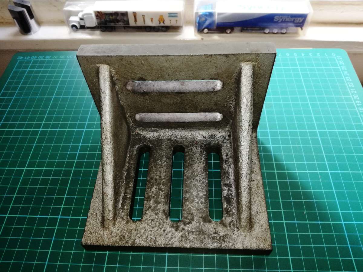

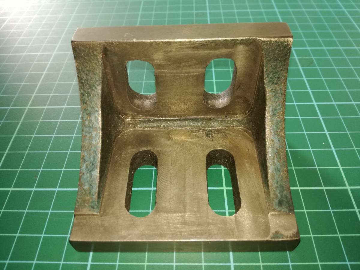

      I want to use this angle plate for bolting something to the cross-slide of my mini-lathe.  Purchased many years ago, but finally found a use for it…after finding it in the bottom of a drawer.
      The backside where all the nuts and washers will go is quite rough and I’d like to neaten things up so that fixings don’t work loose.  (And to keep up appearances with Mrs. Bucket.)
      I seek advice for doing this without destroying my tooling.  I can’t tell if the roughness is cast, or sand that’s been painted over.  Am I going to ruin my Dremel stones on this?

        Your stones will wear out whenever you use them, they are replaceable items. Just get new ones.
        It will be difficult to get a flat, machined type finish with a Dremel grinder. I have a similar angle plate and just use a flat washer to cover the rough rear side.

          You might be better off with one of those “finger” belt sanders to get most of it smoother.

            I fettle all of my model castings with the Dremel, it will remove any sand but I suspect yours is just the sand texture replicated in the iron.
            I use this shape stone mostly which last well but if very hard may get a similar shaped carbide burr out.

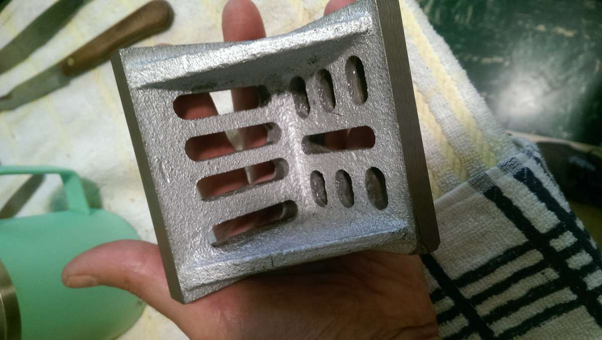

              Hi MikeK,  don’t know why they put four slots in one side, as it doesn’t look very good for bolting down for the two outside ones that are nearly up to the webs. The first 3″ x 2″ angle plate I bought, wasn’t very even on the bolting side, and there was a large radius between the bolting slots and the webs, and bolting it down was a bit clumsy, so I cured mine by milling it, so as to make better room for nuts and washers.
              3 by 2 Angle Plate
              Regards Nick.

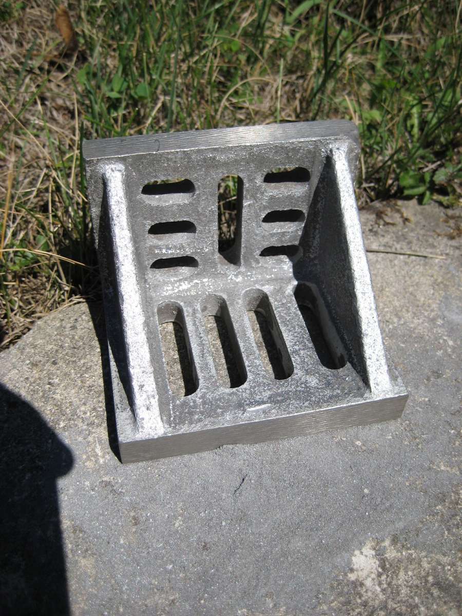

                    Nicholas Farr
                      @nicholasfarr14254

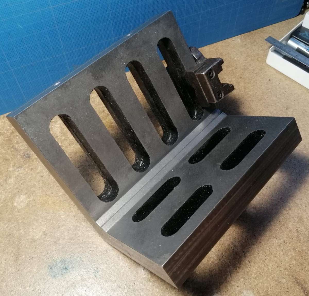

                      Hi, my biggest one is 6″ wide and only has three slots between the webs which gives better room for nuts and washers, and has had a number of large pieces attached to it without any problems of movement, and it hasn’t needed any fettling at all, but I’m not saying there is anything wrong with what JasonB has said, although making an exact copy of an industrial one, doesn’t always work very well on hobby machines.
                      6 x5 x4.5 Angle Plate
                      Regards Nick

                              I used the same stone Jason linked to above.  It’s just a nub now.  They definitely should be sold in three-packs like that.  My local option is 5 USD each.
                              Anyway…During manufacture they must have cast the plate, machined it, and then painted it without removing the iron dust.  So much crumbled off.  I gained a little room near the webs.
                              I still don’t want to risk a HSS end mill on this.  And my 1/2″ carbide insert end mill can only reach if I reduce collet engagement to 3/4″, which seems sketchy.  I may leave it as is.

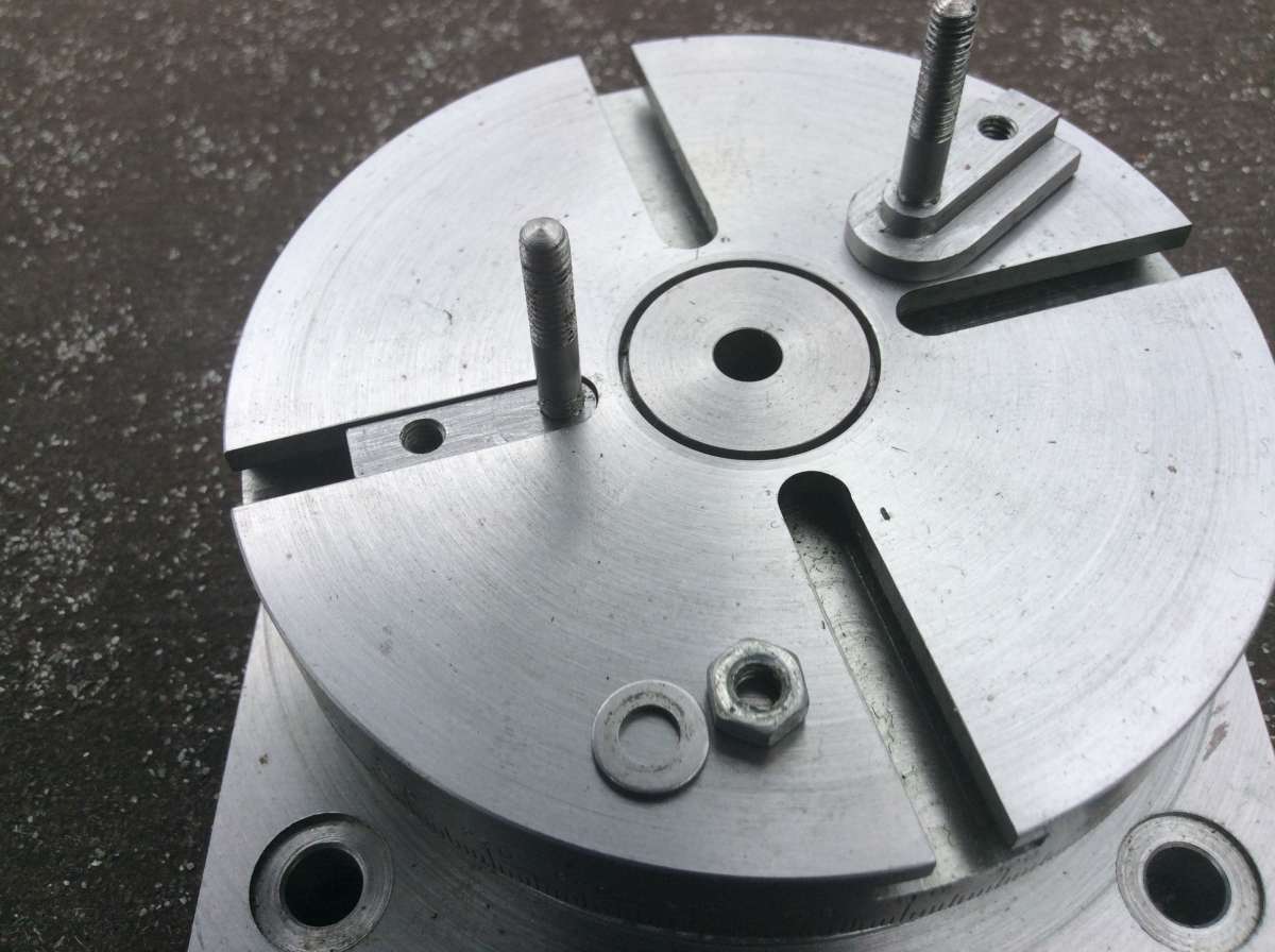

                                      You  could make your tee nuts like this that would allow you to get closer to the end of the slots

                                        What Bernard shows is probably what I’ll make.  The only way I can bolt this particular angle plate to my mini-lathe cross-slide is to use the central slot with both bolts going through it to the cross-slide round-thingie that the top-slide mounts to.

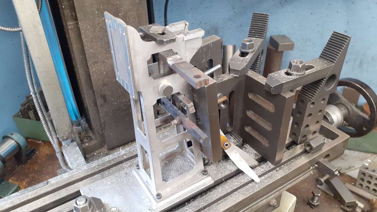

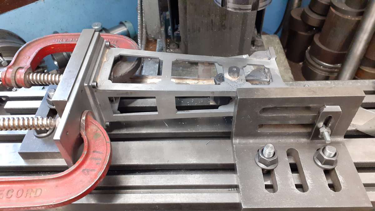

                                                      You wil see my angle plates in use in just about every built thread I post and the vive comes on and off many times in a build but just to expand what I said last night
                                                      Two plates bolted together and to the table with M10 fixings as that is what fits the 12mm slot width of the mill’s table but M6 used to hold work to the plate. Bolted together in a U shape and the upper one angled to suit the job, the U shape is often more compact than the only option of “Z” with webbed plates so ideal for smaller hobby machines
                                                      20231209_112434
                                                      Same job different setup again M10 to table and M6 to work. Note that the flat back without webs allows me to place G clamps anywhere I want if there is no may to use the slots.
                                                      20231210_112333
                                                      Not sure I would have wanted to use just M6 fixings on a job like this . The M10 clamp sets also make good machinists jacks
                                                      DSC01534
