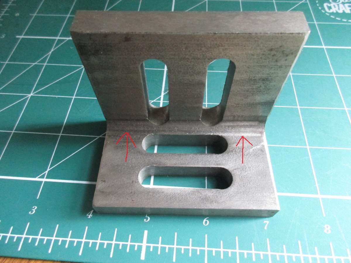

        Hi, I do have a few angle plates without webs, but they can be bent with just a little to heavier cut, just like this one below, it’s only approximately 0.15mm at the top of the gap, and happened on my mini-mill, it didn’t break the cutter, and this was the face that was bolted to the table, and to add insult to injury, it was a brand new 2.5″ x 2″ x 3″long one.

            Hi JasonB, I keep thinking of a way to do it, but the bend is at the edge of the slot, that is next to the other face, so I may use a bit of heavy angle iron with a couple of threaded holes for set screws, and then clamp this onto the other face, with a bit of thick plate underneath, and then with a piece of 4 or 5mm plate between the set screws and the bent face, to force it back a bit at a time, and checking it with my square. Worst case it will snap, but it’s not really any good for its purpose as it is.

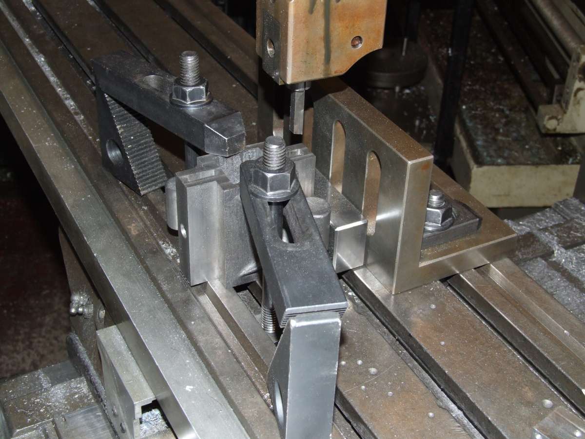

              Anonymous

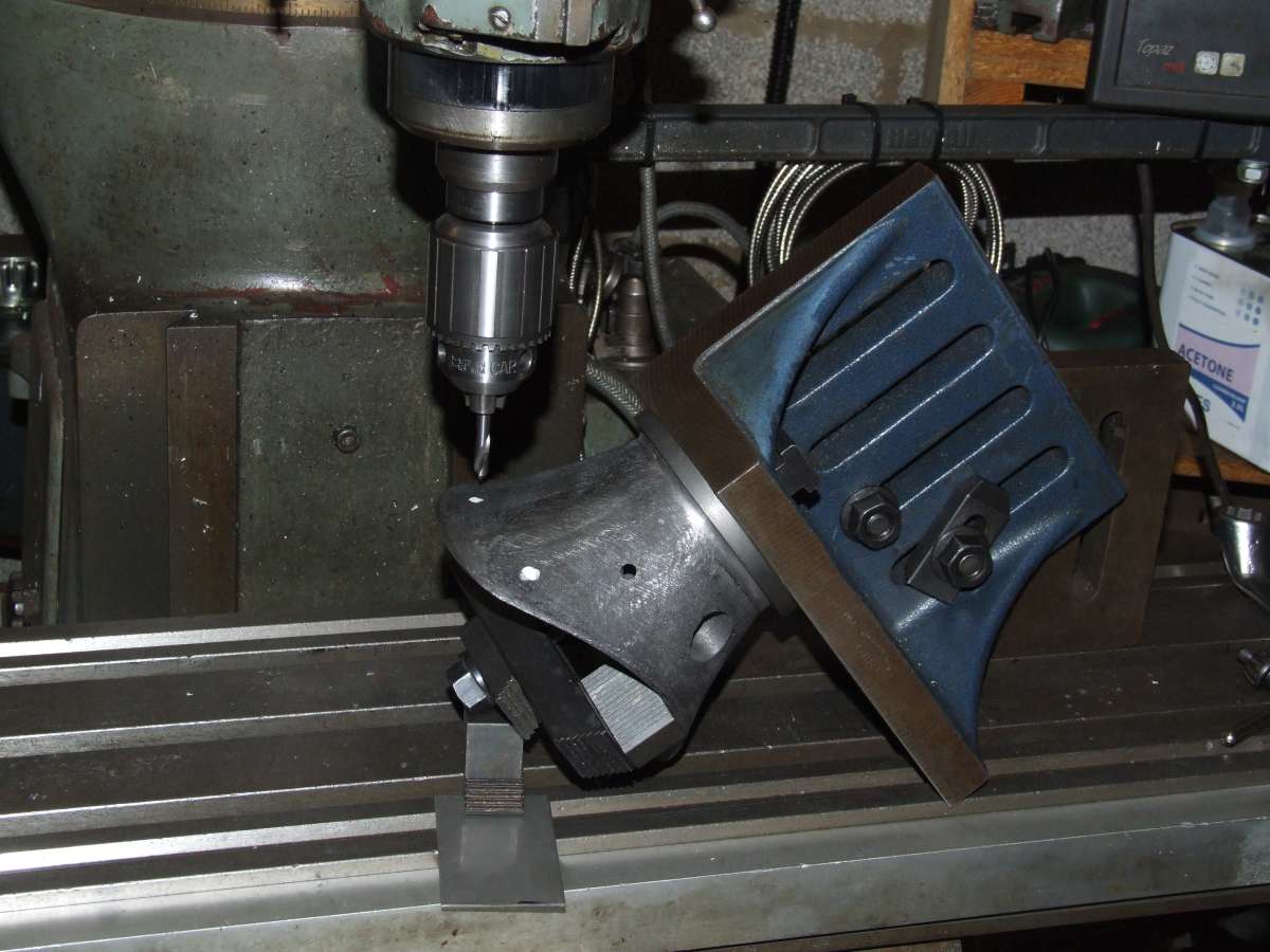

                I’ve got six ground all over angle plates and four with webs. The ground all over angle plates get used for marking out, or to provide a reference surface:
                Crosshead_4
                For general machining I prefer the angle plates with webs:
                2018_05070008
                I normally use the four straight slots for holding the work and the set of short, perpendicular, slots for bolting to the machine table. None of my webbed angle plates are machined on the inside angles. They seem to bolt down fine with studs and clamps rather than washers, which are too flexible.
                Andrew

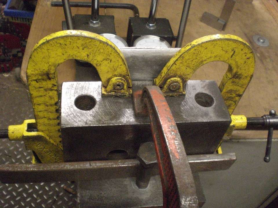

                    Nicholas Farr
                      @nicholasfarr14254

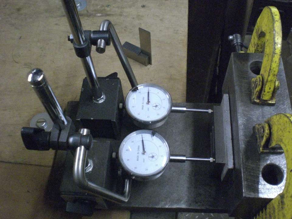

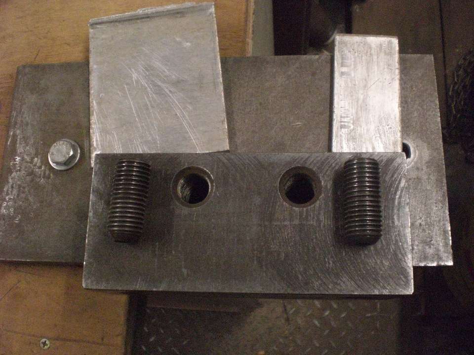

                      Hi IanP, yes I’m aware that the angle plate may fracture, but I’m not that worried about it. So, I remembered that a big block of steel I have, has two 20mm threaded holes through it, which are close together, 20mm is probably OTT, but saves me making something, so this block and a piece of 20mm BMS and two pieces of 6mm aluminium plate, which are used as protection buffers between the block and two grub screws and the angle plate, plus a wide piece of pallet strapping, to stop the grub screws chewing into the aluminium plate, were gathered together.
                      Block and Plate
                      These were set up along with two dial gauges set to zero at the top edge of the angle plate, as in the photos below.
                      Set Up 1
                      Dial Guages

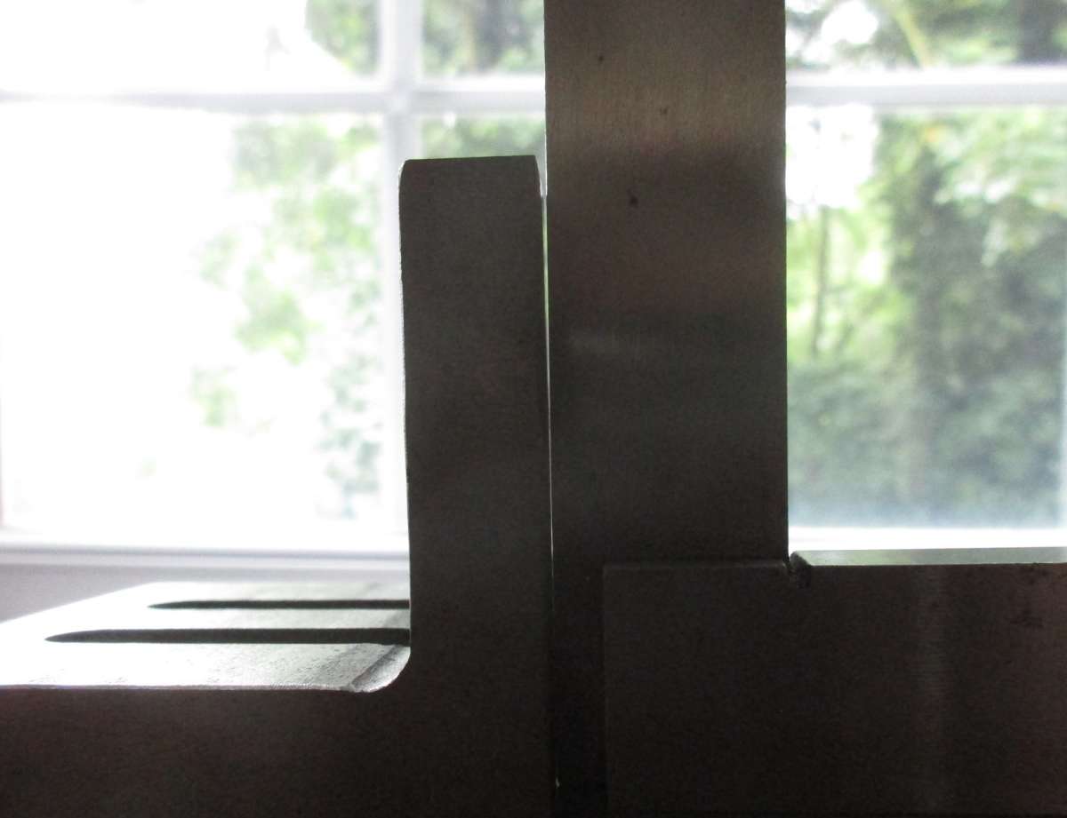

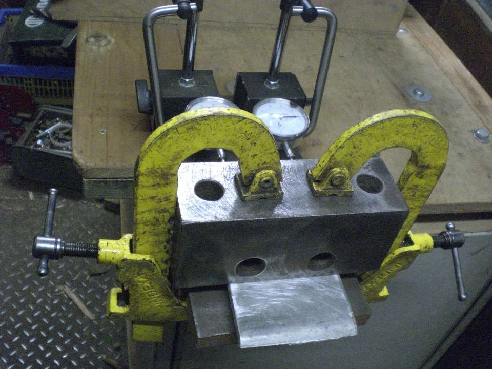

                      Then the two grub screws were screwed in a little at a time, to keep the same pressure on each side. However, the gauges wouldn’t go any higher than 0.006″, although the screws would still screw in quite easily, and it then dawned on me that the block was moving under the clamps. So another set up was made to stop the block moving.
                      Set Up 2
                      The screws could then force the angle plate further, and it reached 0.0115″, and to back off the screws slowly, to check if the angle plate had returned nearer to square. It hadn’t gone back to square, but it is now only 0.05mm between the top and the square, so that’s a movement of 0.1mm, I’ll give it another go, and push it another thou or so an check again, which I may have to do more than once.
                      Regards Nick.
