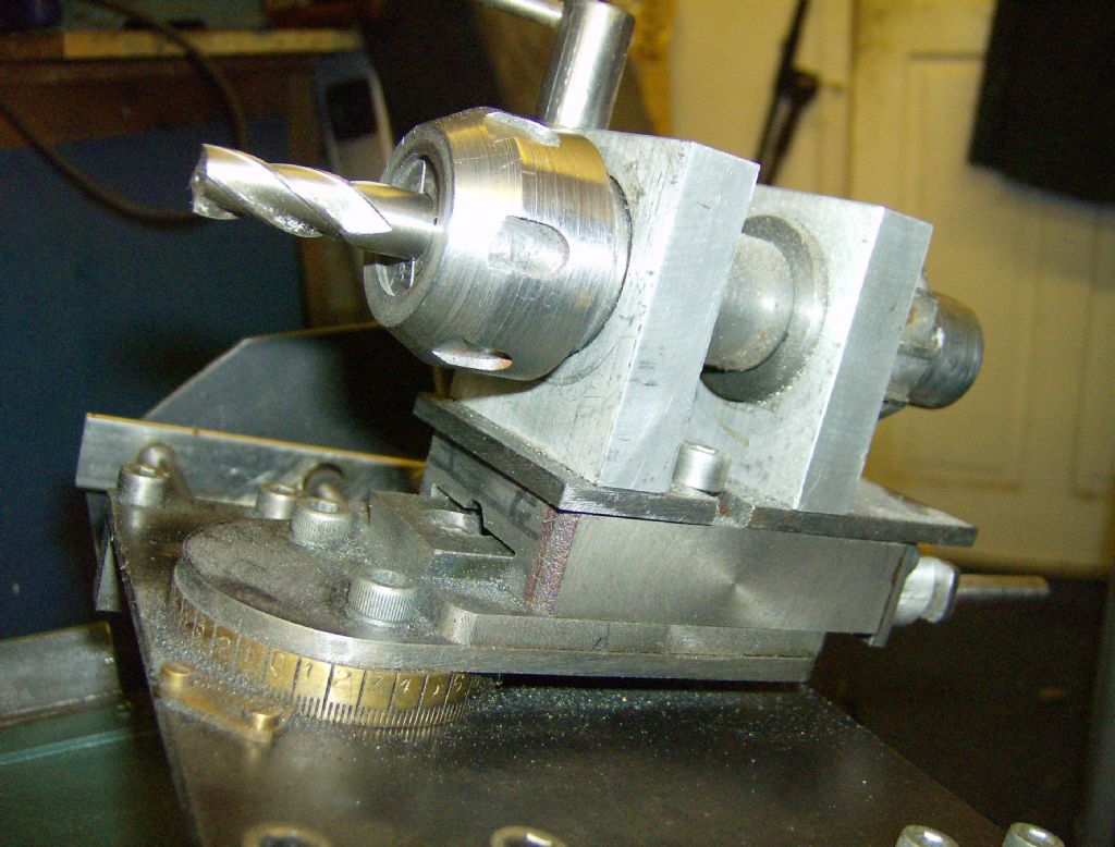

      Hi Adam,
      It's very easy to make your own using a milling machine and a pointed lathe tool as an engraver.

        Hi Neil, I am afraid that I might be able to accurately place the graduation marks (I repeat might!) but I think engraving nice numbers is way beyond my flight range! I was thinking I could use the dividing attachment to place the graduations but I would never be able to draw nice numbers like you have done in that photo. Kind regards,

          The AMA-WEA arrived this morning within 24 hours which is very impressive. The vice feels nicely precise, as does the swivel, but the two tilts are rather loose fitting when unclamped, the paint job is awful (keeps coming off in your hands), and although there are graduation marks on both tilts and on the swivel, the marks are very feint and needless to say bear no resemblance at all to reality of actual degrees of movement. Typical chinese quality I suppose. Checking Alibaba I see this is a popular design made by a number of firms both in China and in India so maybe there are better examples out there. Anyway at £59 all in serves my purpose for sharpening cutting tools more accurately and comfortably than I could ever do by hand. Adam

                  My numbers were stamped. i could have done better now with a simple stamp guide I have made.
                  If I was re-doing that job, I would use photo etching.
                  Note, I had to mark a flat piece of brass, bend it to size, then measure the elongation of the scale and use that to calculate sizes for the final one in order to get an accurate result.

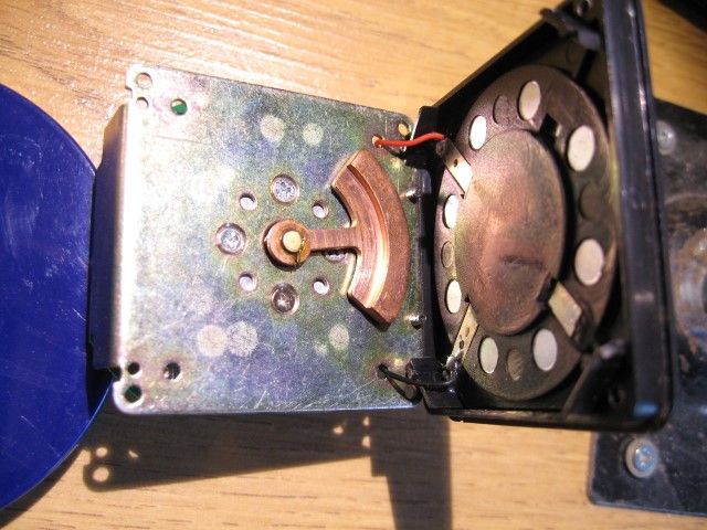

                                                Hi Neil,
                                                They don't use an accelerometer chip like smart phones and tablet PCs do. It uses a pendulum with eddy current damping. I think the position is read in the same way as digital calipers. I think there is a circular version of the PCB that is inserted in to the bar of calipers. I think there are 18 radial fingers of track on the rotating PCB wheel.
                                                This is the pendulum.
                                                The pendulum seems to be made of copper and the 8 disks you can see inserted into the back cover are magnets. (Just like the 3 in the base.) There are some more pictures in my photo album. I have higher resolution photos than in the album and some notes with what I have found out so far about the communications protocol between the two boards. If you are interested in this information let me know and I will email it to you. (I still have your email address.)
                                                Les.
                                                Edited By Les Jones 1 on 22/03/2014 17:17:30
