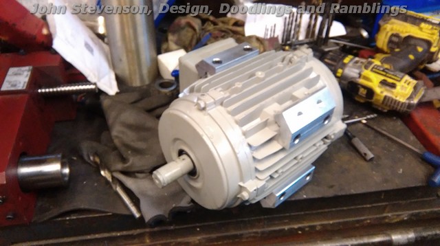

              Simple little job today, job not really of interest as chances are no one will ever be asked to replicate this but posting it for the method and using new toys.
              *Warning* could be a blatant plug or two .
              Job in question.

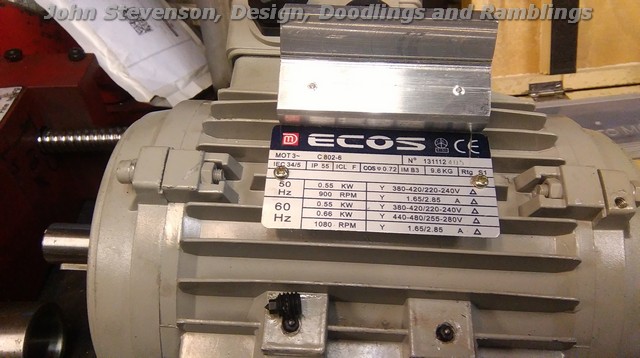

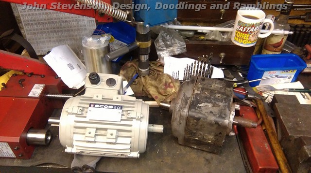

              It's a fan motor that needs replacing with an off the shelf new unit. Now at one time this type of frame was an option.
              They have tapped holes at 4 place on the outside so long studs can hold it central inside a ducting system. However they have long since disappeared off any manufacturers list.
              What they did offer instead were angled feet to basically do the same thing but these have also disappeared.
              So occasionally I have to make angled feet, next picture.
              Now this is the interesting bit. Couple of angled feet milled out sat on the motor at the top and I now need to pick the hole centres up from the new motor.

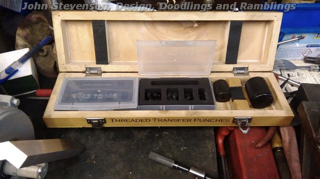

              *Blatant plug *
              Whilst we were in China last I saw these threaded transfer punches and got Ketan at ARC to add them to his list and I thought people would be interested in them, also because I wanted a set as well.
              Up to now I have been screwing an allen grub screw in, wrong way round , putting the bit on and whacking it then centre punching in the centre of the ring it left. Occasionally I get the damn screw stuck though and no way to get it out.
              These threaded transfer punches have a small hexagon on the top and the set comes with a tubular spanner to fit them and remove them so no getting things stuck any more.
              Two M6 punches fitted in the holes and one of the M8's laid on top so you can see what they are.
              So got a couple of sets to do the whole range and fitted them into a nice spare wooden box I had and marked it up. Nice things laser engravers wink
              They don't come in an engraved box, just the plastic trays you see here. i have done the engraving.
              Anyway holes marked, drilled, counterbored and tapped and finished the job.

              #251567
              Pero
                @pero
                Well plugged Sir!
                I have been faced with the same problem on a number of occasions (household repairs rather than model engineering) and have never found a really successful solution.
                I will be adding a set to my next order from Ketan.

                Thor 🇳🇴
                  @thor
                  Nice job as always John. I made a couple of sizes of my own threaded transfer punches. There is a point in the centre and a couple of thin sawcuts at the edge so I can get them out afterwards, using a small screwdriver. Well, I guess I don't have to make more of them anymore.
                  Thor

                  frank brown
                    @frankbrown22225
                    I have made one also. To simplify things, my saw cut (to unscrew the beast) is purposely off centre, so as to leave the central "pip" to centre punch for the hole. The slot is only to unscrew the screw, so does not have to meet the latest NASA spec.
                    Frank

                      Can also be made by grinding a point on an old allen key, cutting of a suitable length and loctiting into a grub screw. Thats blown my xmas present from Ketandevil
                      Edited By JasonB on 20/08/2016 10:20:40

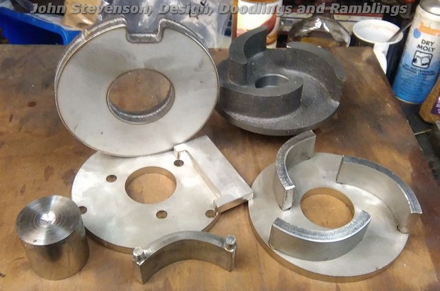

                            OK been a long while since I resurrected this thread but doing an 'interesting' job at the moment.
                            One picture of a before and part way thru shot.
                            Top right is a cast iron impeller out of a pump that pumps ? something ?
                            But whatever it is doesn't need to be in contact with ferrous materials and a stainless impeller or pump isn't available in this size at an affordable price, plus a few are needed.
                            So initially drew it up and was going to machine it out of a solid lump of 5" diameter 316 stainless but with the material costs and machining time on the CNC it was a non starter.
                            So Plan B.
                            Get the laser cutters to cut a back plate and three vanes per pump. At the moment only two sets have been cut until they have been tested out.
                            The vanes are in 8mm 316 stainless and have pegs on the ends at 8mm square which are turned into round pegs to fit the back plate. The vanes are then bent on the hydraulic press so the pins fit the holes and this 'should' give the correct radius for the vanes. A stainless boss will also be welded in to fit the motors.
                            So end of play today, everything is ready for welding tomorrow.
                            The other plate, top left is the wear plate that fits over the impeller, included it in the shot just as an example of what the latest series of fiber lasers can do. This is 16mm thick but they can go up to 20mm. Quality is quite good but the ID and OD need cleaning up by about 2mm
                            #280158
                            SteveM
                              @stevem36008
                              Interesting job indeed John. I've no doubt that your welded solution will have the strength to last the course, but I wonder if the shape of the vanes may cause a problem. It's looks from your picture as if the original impeller has hydrodynamically shaped vanes with rounded ends which will shift the fluid efficiently. Having said that it also looks as if the surfaces have been left rough from the casting.
                              The regular shape and square ends of the new vanes may cause turbulence and/or cavitation which would reduce performance, but the surface finish looks much smoother.
                              It'll be very interesting to see how it works out.

                              John Stevenson 1
                                @johnstevenson1
                                Steve,
                                I have taken on board that the vanes in the original are shaped which is not a lot a can do about without spending a lot more money.
                                But by the same ruling the vast majority of impellers i see on pumps have parallel vanes, some are even built up this way as separate items and welded or riveted.
                                The ends will be radiused before welding to break any sharp edges. Two pumps are being modified and then go into service and these will be monitored. At present the life of a pump is 10 months to a year before erosion wears the impeller out. If these can extend the life then there are more to do.

                                Ian P
                                  @ianp
                                  Couple of points, What is it that the Fibre laser has done to the 20mm wear plate? (It looks like the edge has a step or rebate)
                                  The vanes look to be about 25mm? high, if this is a thickness your laser cutter company can cut in SS then you would have control over the profile solving any possible hydrodynamic problems. The vanes could also be created by stacking 2 or 3 thinner cut parts and be aligned with dowels for welding.

                                    Ian, read again vanes are 8mm material then bent. There is one laying on teh unassembled plate.
                                    JohnS, be interesting to see how your 3in1 welder copes with this jobsmile p

                                    Brian Wood
                                      @brianwood45127
                                      Hello John,
                                      ​I follow these varied exploits of yours with interest and this job is no different.
                                      ​With your eye for efficiency and elimination of unnecessary work, I am though curious as to why the vanes were made with square pegs which you later turned round to locate into the back plate, rather than simply fitting round pegs to them in the first place.
                                      Regards
                                      ​Brian

                                      John Haine
                                        @johnhaine32865
                                        Posted by Brian Wood on 26/01/2017 08:49:25:
                                        …. I am though curious as to why the vanes were made with square pegs which you later turned round to locate into the back plate, rather than simply fitting round pegs to them in the first place…
                                        'Cos they are laser cut at the same time as the rest of the plate?
                                        #280227
                                          Because you can't fit a square peg in a round hole?
                                          #280238

                                              But if the holes were made to suit the across corners size of the square you would be able to fit the square peg in the round holesmiley

                                              Ian P
                                                @ianp
                                                Jason
                                                It was the height (axial length) of the vanes that I was referring to. Nowadays Laser (or water) jet cutting of steel and other materials up to several inches thick is not uncommon so I was speculating that John could have cut the vane profile direct and eliminated the bending stage.
                                                I frequently use the SPiRH technique with laser cut parts, I also use a line of small holes where bends are going to be as I dont have bending equipment (other than a vice). This is only useful if the holes do not matter on the finished product.
                                                Ian P

                                                  John Stevenson 1
                                                    @johnstevenson1
                                                    Posted by JasonB on 26/01/2017 10:12:00:
                                                    Now why didn't I think of that at the time ???
                                                    One hole is right on the edge but it could have been moved in. Note to self to alter the DXF before it goes to the laser cutters for the next batch.

                                                    Ian P
                                                      @ianp
                                                      Was my idea of creating the hydrodynamic profile by cutting the vane out of thicker material not a go'er?
                                                      Ian P
