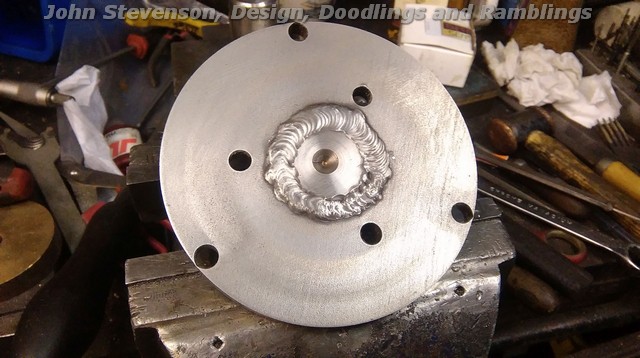

        Posted by JasonB on 26/01/2017 07:21:22:
        Ian, read again vanes are 8mm material then bent. There is one laying on teh unassembled plate.
        JohnS, be interesting to see how your 3in1 welder copes with this jobsmile p
        Negative thoughts Moriarty.
        Have a little faith Baby wink
        This is the 40mm boss welded into the 8mm stainless plate with the cheap Chinese TiG.
        Could be better at the bottom as regards presentation but not that worried as it needs facing off.
        I have recently had two new lenses fitted to my eyes and not settled down enough to get my new glasses so I do have a problem at time focusing up close but once I get the new glasses this should cure things.

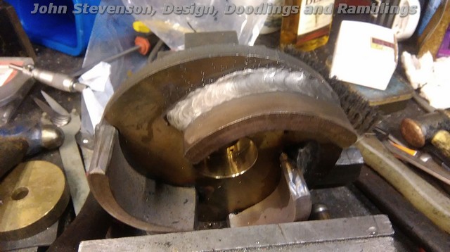

        Outer vane TiG welded. DC @ 110 amps 3.2mm tungsten.
        That was enough to pump enough heat into it to get the whole vane glowing dull red.
        People take the pi$$ out of these Chinese welders but if you buy a decent one and not a budget one they are awesome compared to what we had to weld with 10 years ago.
        I have now sold my BOC TradesTiG as compare to this it was a dinosaur.
        Never touched this at all, just works out the box [ including all the gas fittings wink cheeky ]
        Longest weld I have done with this was in 5mm thick alloy on a pickup tailgate where a digger bucket had swiped it. 40 minutes continual welding, No idea what the duty cycle is on this machine.

          Have to ask, what is the mystery brand of your Chinese TIG. Obviously AC/DC?
          Cheers, Colin
          #280422
          John Stevenson 1
            @johnstevenson1
            Colin,
            Had it about 5 years now so the exact model I have probably isn't made any more but this is the closest I can find.
            **LINK**
            As regards looks and features. The current model is different in that it's all in a sloping case. I paid about £420 direct from China when I was over there, they should have cost about £600 at the time but the newer design is around £750 now.
            The 200 amp AC/DC from someone like R-Tech is just over a grand but you are paying for UK support.
