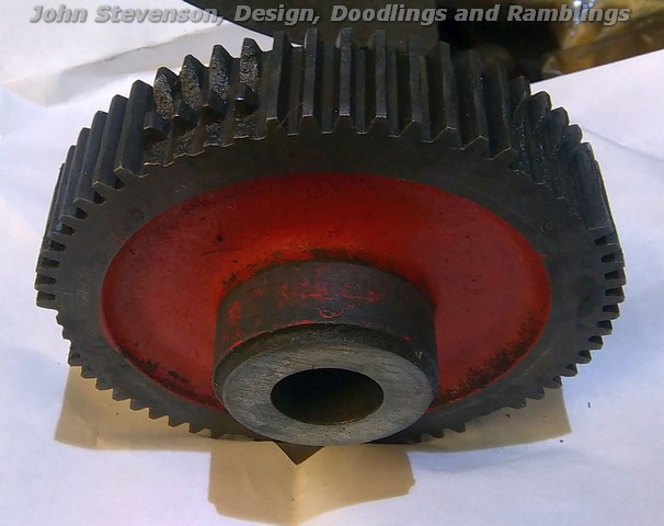

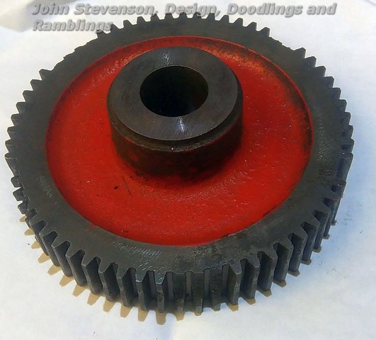

                            Well they came to collect the keep plate this afternoon and dropped the old gear off.
                            Looks even sorrier now it's out than it was fitted.
                            17 teeth out of 63 are either broken or damaged. Some have been half repaired in the past.
                            Not clear from this shot but it's a helical gear, only slight 2 degrees but is is helical. No idea why anyone would want to put this slight an angle on ?
                            Wondered at first if someone had cocked up and not put the hob lead angle on but the mating gears are the opposite hand so it's definitely been designed this way.
                            Won't get a chance to get round to it until late this week or early next week as believe it or not got a shed load of rotors to convert from metric frame to imperial frame.

                              Perhaps someone bored the gear centres wrong.

                                    Perhaps the gears were cut that way so that to buy a replacement, it had to be an original, not just one the same size off the shelf.

                                        The angle on the gear is probably to ease the transition of movement, giving a slight twisting to the motion.
