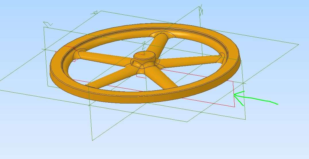

                  Don’t know tinkercad but if I only want to use part of an item I simply sketch a rectangle and then cut  extrude in Alibre or F360. This removes everything that teh rectangle was drawn over. Usually do it to produce top and bottom pattern halves. Then use “save as” so the original is not lost
                  You can see the red rectangle here which has cut away the bottom half of the flywheel to leave a hanf pattern
                  top1
