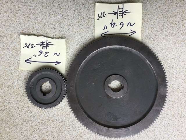

                            I’ve arrived here because I’ve recently been clearing out some of my old dusty boxes with a view to ‘rationalising’ the stuff I have. That led me to wondering what the current thinking is on the age-old ‘cutting metric threads on an imperial lathe’ question.
                            l’ve been in the electro-mechanical fix-it business during my working life but have never worked in a shop or trained as a machinist in any way. Thus, when my Uncle’s Atlas 10F was passed to me some 35 years ago I was starting from a true ‘amateur’ status. To think, he had this machine for 30 years so it’s now been in the family for 65 years – astonishing how time flies.
                            Way back then, when the whole idea of metrication was much newer than today, and with, more or less, only imperial machines available for the amateur, ‘metric threading’ all seemed a bit of a black art to me. I had mastered ‘ordinary’ threading (gear trains etc.) but I remember the terminology of the time to be confusing in often referring to ‘conversion’ gears or ‘converting’ the lathe to cut metric threads. This was, until I spoke to a retired neighbour of ours who was an ex-Molins engineer.
                            He said to me “what you need to understand is that you can’t cut a metric thread on an imperial lathe”.
                            Of course I’m “yes, but, yes, but….”
                            He said “what you can do is cut a non-standard imperial thread of 25.4 tpi”
                            With that one golden nugget of wisdom, everything fell into place as all the standard calculations still apply. He and I became good pals for more than 30 years. Sadly no longer with us.
                            I have been interested to read the various opinions on the forum regarding ‘approximate’ threading using standard gears. Those seem to vary from not particularly favourable to the other end of the scale suggesting that a 127 combination isn’t even needed. I wondered why that difference might be. Could it be down to which machine you have. I.e. the combination of lead screw pitch and the standard gear-set supplied? I have to say that I never found the approximate ‘metric’ threading, using the Atlas recommendations to be satisfactory. Yes, it sort of worked, but either a bit loose, or tight depending upon the approximations.
                            I thought salvation was at hand. When my Uncle passed away my Aunt asked me to pick up a couple of boxes of Uncle’s ‘stuff’ to sort through and keep or dispose of. Lo and behold! In the bottom of a box was a 127/50 gear pair in what I’m sure is 20DP. They had obviously been adapted for the Atlas. Problem solved! …..Until I tried to use them. Even at 20DP they were far too big to mount on the Atlas banjo and have any room left in the gear case to do anything with them. At that moment I realised two things. Firstly, my Uncle had probably gone through the same exercise in getting these gears, adapting them to the Atlas and then realising they were impractical – hence ending up in the bottom of the box and secondly, it became clear why Atlas didn’t offer a 127 gear for the 10F. In the standard Atlas 16DP it would be approaching the size of a dinner plate!
                            All was not lost, however, because eventually I was able to use these gears as indexers to make myself a new 127/50 pair in 26DP which would fit. I therefore use this pair to run together as a ‘fixed ratio’ and use the standard Atlas gears to multiply or divide the fixed ratio to give me the pitches I want. I can’t say this would give me any pitch but I haven’t yet found anything I needed which I couldn’t do.
                            If anybody has bothered to read this far, they might be wondering what this ramble has to do with clearing out the workshop. The thing is that I have, again, come across this original 127/50 gear pair. I had actually put them on the ‘next trip to the dump’ pile. Sitting with a thoughtful cuppa, it occurred to me that they might be useful to someone?
                            Anyway, that’s the ultimate point. If anyone can use these gears I would be delighted to post them FOC to the first raised hand. If I get no takers, that’s OK too because it would ease my conscience considerably over throwing them out. As said, they are adapted for the Atlas, but I’m sure a happy hour’s project time would see them sleeved to fit anything.
                            As a final aside, another piece of wisdom I wish I’d had years ago is what to keep and what not to. I have stuff I’ve kept for years, never used and never will use. Why do we do that? I can only think that 30 years ago I didn’t know if I needed something. It’s the wisdom of years which allows you to realise you didn’t need whatever it was and never will. Even so, it’s still hard to fathom. Two extreme examples in my case. One is a dinky little Bunerd 3 in 3 jaw chuck. Nice little thing. No perceptible wear. Probably had little use, if any, but a 3” chuck on the Atlas? I doubt it! At the other end of the scale is a No. 36 Jacobs drill chuck. This thing opens out to about 3/4”. A 3/4” straight shank drill in the Atlas? Sounds like a recipe for disaster to me! But still I’ve kept this stuff for decades??
                            Anyway, the time is now! Two more items for the chuckout pile. (Did anybody spot that one? The ‘chuck-out’ pile?…..Oh, please yourselves…)

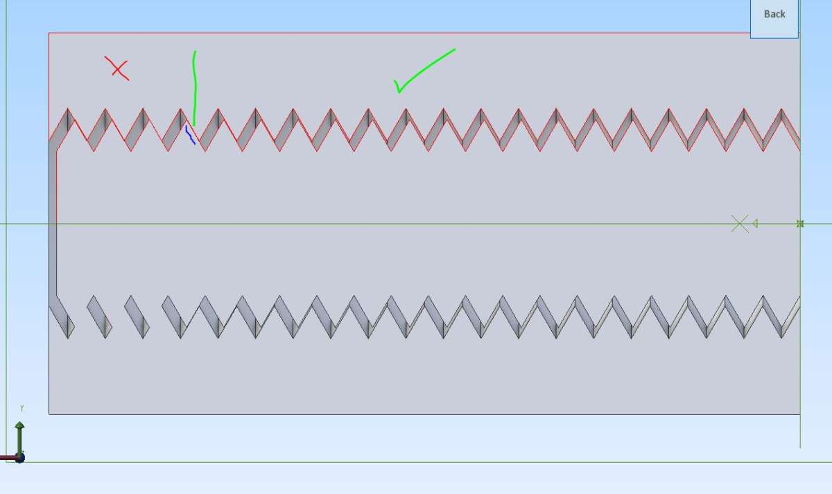

                                                  Charles how does altering the diameter work when it is the flanks that will be in contact?
                                                  This is why it is often said that a thread with slight pitch error will fit a nut which is relatively short but if you want to screw that same thread into a deep tapped hole it will bind
                                                  Quick stetch here, plenty of clearance between roots and crests ignoring any rounding over. Screw in the middle is 1mm pitch and the nut is 1.01mm pitch.
                                                  You can see that there is clearance on the right until the point marked in green so a short nut would be OK but anything longer will bind
                                                  thread hit
                                                  If you are saying reduce thread dia but keep thread depth the same you will get the parts to fit for a longer length but introducing more slop to compensate for the wrong pitch means there is a lot of clearance and the actual point in contact is small (blue line) This is 6mm x 1mm pitch into what would be a 6.4mm x 1.01mm pitch hole
                                                  thread hit 2
