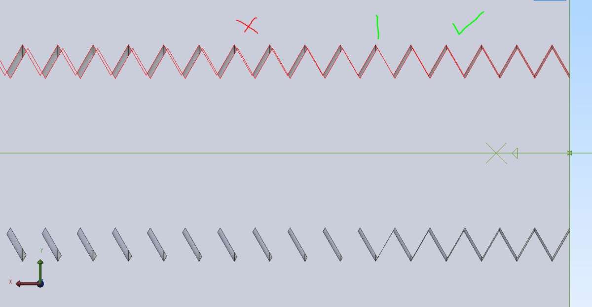

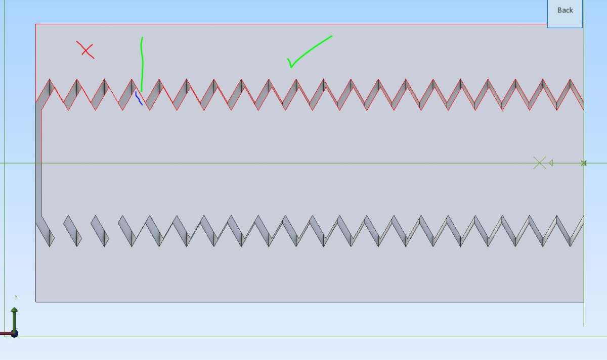

      Jason, I see no sketch. In an effort to give some sort of answer to Martin, I was trying to give a mathematical indication of just how much sloppier a fit a nut would need to be to accomodate a given pitch error. I think you have answered your own question, but to be clear, you get more axial clearance because the thread flanks are sloping. It would not work for a square thread.
      That is the geometry.
      Next is the strength of materials or solid body mechanics. For a reasonably small pitch error, when the a spanner is applied the points of contact will sort themselves out by elastic and plastic deformation to whatever extent is necessary to accomodate the applied axial load.
      Moreover, as the bolt is in tension and the nut in compression, making the nut thread pitch the right amount greater than the bolt pitch would actually result in a more even stress distribution.
