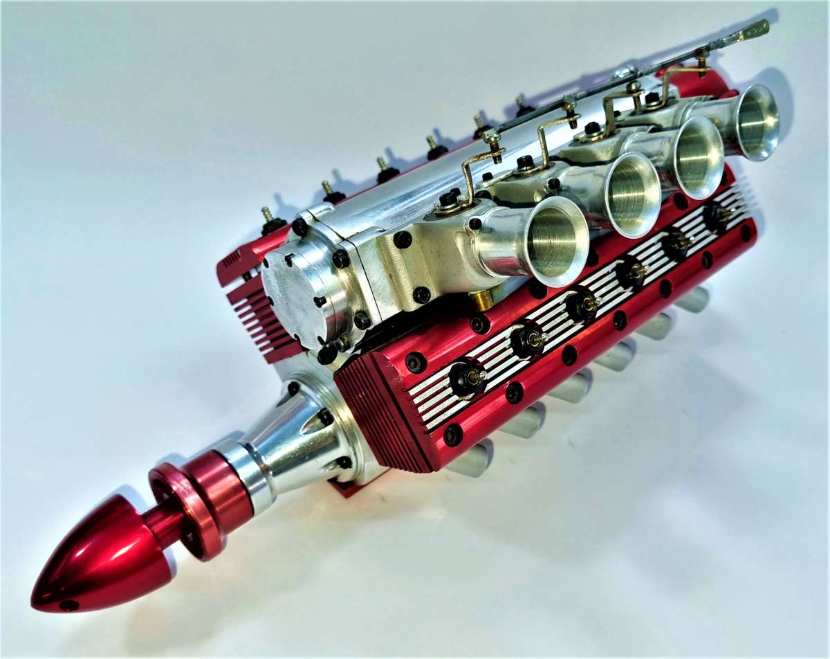

                    Well as its been quite some time since my last little model engine confessions and even longer since updating this thread I thought it high time i pulled finger (as they say) and posted a bit more on the V12 project. I decided to do a bit of a rethink with this engine and went ahead and made some sand casting gear and cast up a couple of new cases for the V12. photos below show the depths of insanity that some will sink into if left alone long enough.
                    So hears the end results
                    Yeah I know I said a couple but if I want to end up with at least one good engine I should probably allow for so oopsies, lol
                    cheers for now
                    Dean

                          So………..been a little busy over the last few years and sorta sidetracked. I have however stumbled across this engine sitting way back in the workshop languishing in a sad state of neglect and have brought it forward to the front of the que once again. I stripped it down to check out the inside and give it a big clean and found a broken piston so am now in the process of remaking a set of pistons to slightly improved design. I'll update with photos in the next couple of days.
                          Cheers
                          Dean

                                          CLAMO Wraithe
                                          Still working on getting this engine back together with a new crank with a shorter stroke. the original crank will be going into a second V12 with a slightly different block.

                                                    New crankshaft is under way for this derilect project. The reason is to destroke this engine in order to do away with the slipper type pistons and return to a more conventional “square” type of design. By shortning the stroke I can reduce the deck height which will put the exhast back where it was originally designed to go and therefore eliminate the need of the slipper piston skirt to keep the port closed over TDC.
                                                    There is nothing wrong with the old crankshaft so it will be fitted into another V12 block also under way which will have a higher deck height to fix the problem that was present in the first engine.
                                                    P.S. also the flat 12 project is back on the bench and will be updated soon, pics for all following shortly ish.
