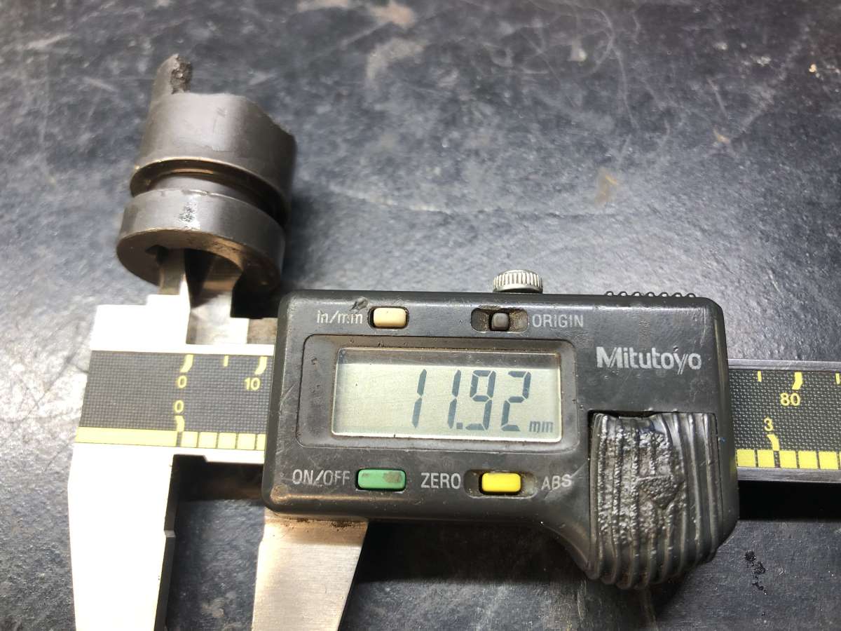

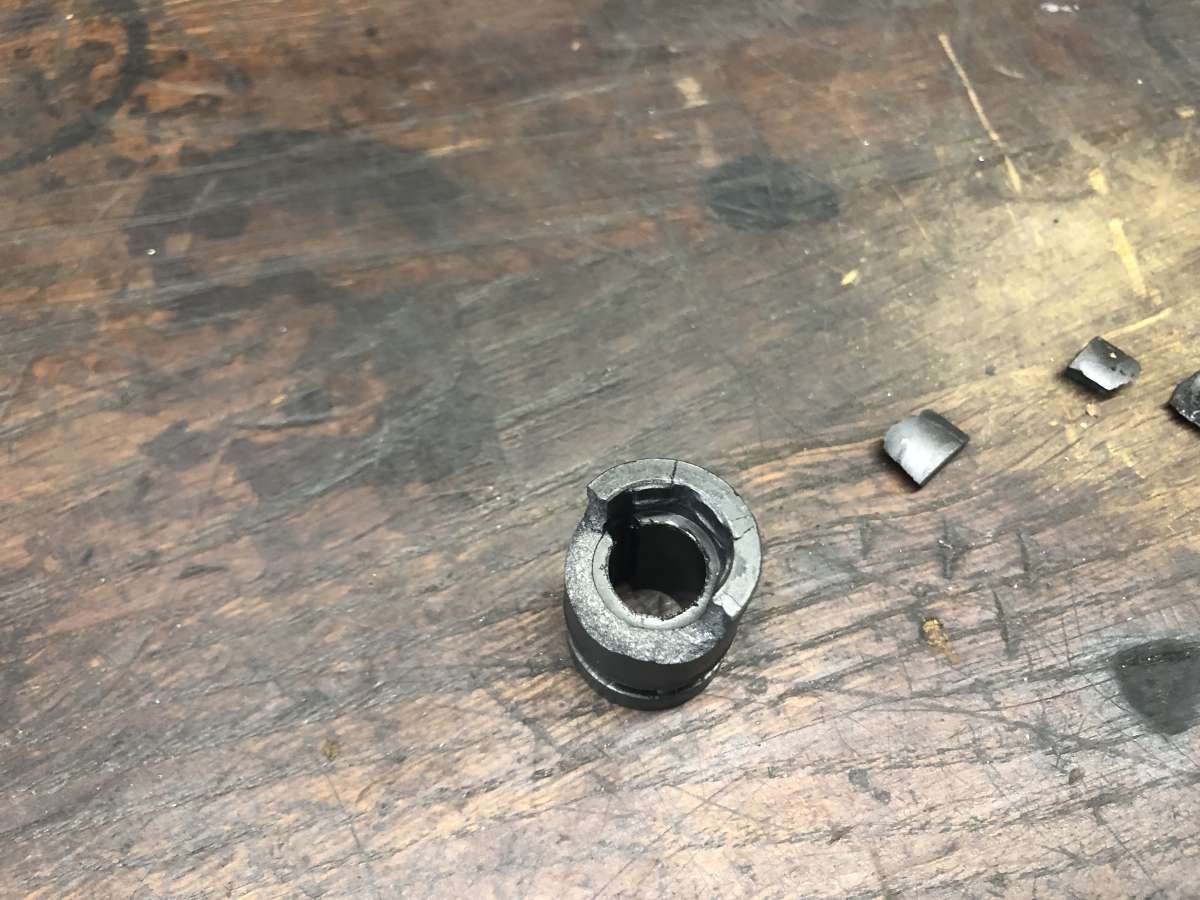

      Hi guys done something stupid I’m always wanted a lathe and bit the bullet and bought a little Clarke cl430 lathe 5 months ago. Not used it yet but thought I’d oil up the ways etc as it’s sitting in the garage and slid the tail stock back and turned it on so I could activate the power feed to oil under the tool post area, but unfortunately because I’d slid the tail stock right back it stopped the power feed rod from rotating and shattered the power feed coupling 🙁I’ve  contacted Clarke and no parts are available.
      Im sure I’m not the 1st to do this does anyone make this part or know of anywhere I could purchase the part, upset with self for making such a silly mistake,any help would appreciate. Sorry new to the group I can’t see how to upload pics
      #724261
      daz996
        @daz996
        IMG_3866IMG_3867

            How does the part transmit the drive ? – looks like it has a hex-shaped recess?
            #724323
              I thought I could see a recess Hex  too, can you take a photo of the mating part and are there any balls or springs involved making it a slipper clutch rather than a direct drive coupling.

                The CL430 (and the CL500M) was discontinued some time ago.
                The original couplings might be sinters, so more liable to shatter,than plain steel.
                This feature might act as a fail safe, to protect other parts in the power train.

                #724330
                  Howard, I think it is actually part 18 “Hex socket Sliding Bush” The leadscrew has a keyway and key so no hex for that part to engage with.
                  Part 15 probably has the male hex and a rack cut into the bottom that is then moved by the lever to engage 15 into 18.
                  Part 18 also needs the keyway that can be seen in the photo a swell as the hex.

                    Thanks Jason
                    So part No HT300030018 then.
                    The key way is probably the stress raiser that led to the breakage.
                    If available, might be worth buying in an extra couple of spares,  in case of problems in the future.
                    If  no spares obtainable, in some ways a key way might make manufacturing a replacement easier, in that it could be a circular sleeve with a key way filed in, and a key made  to fit each end.

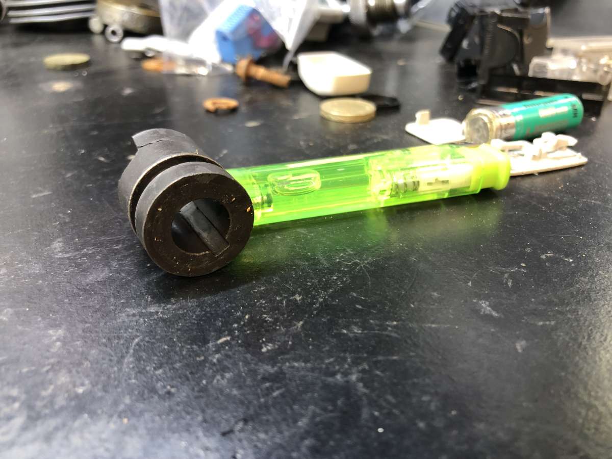

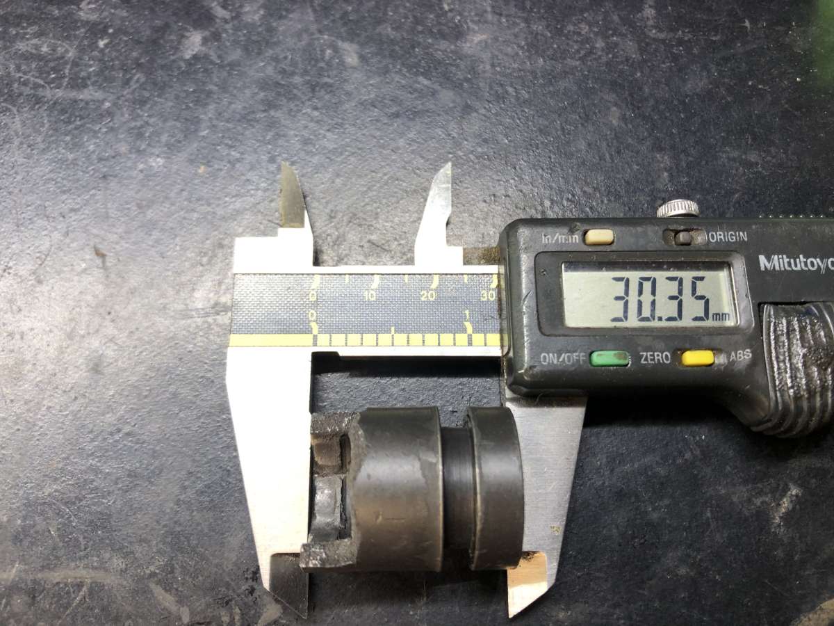

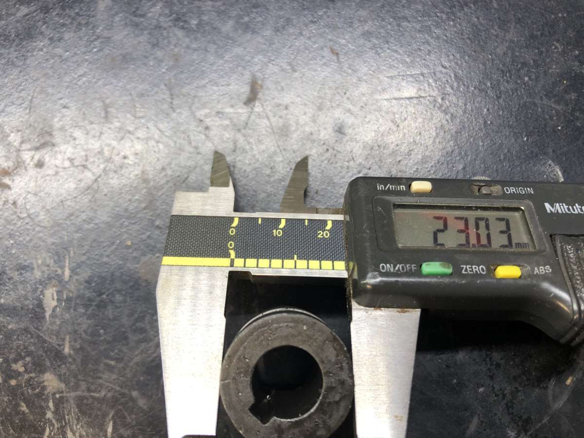

                                #724522
                                daz996
                                  @daz996
                                  IMG_3876IMG_3886

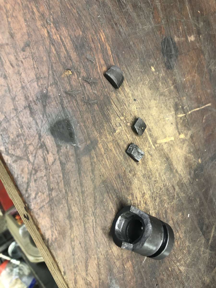

                                  #724523
                                  daz996
                                    @daz996
                                    IMG_3888IMG_3887IMG_3889
                                    #724524
                                    daz996
                                      @daz996
                                      Sorry guys all notifications was going in my junk folder, I was thinking of buying a 14mm impact(soft)3/8 socket and trying to bore out the centre and file in a keyway

                                        I guess it was made of cast iron so that it would shatter in situations like you had. If you make it out of steel, it may be too strong and break something else in the headstock drive ??
                                        #724529
                                        daz996
                                          @daz996
                                          Looks like cast iron but the funny thing is on dismantling I found a pin in the feed system that’s about 3mm I would of thought that would of sheared first unless this was already damaged or the pin has been replaced for something stronger?
                                          #724539
                                          bernard towers
                                            @bernardtowers37738
                                            Pin is likely to be from too hard a material and your hex bit is almost certainly a sintered product which when broken looks like cast.

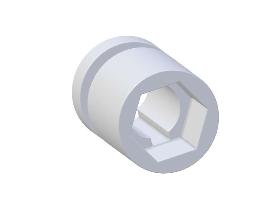

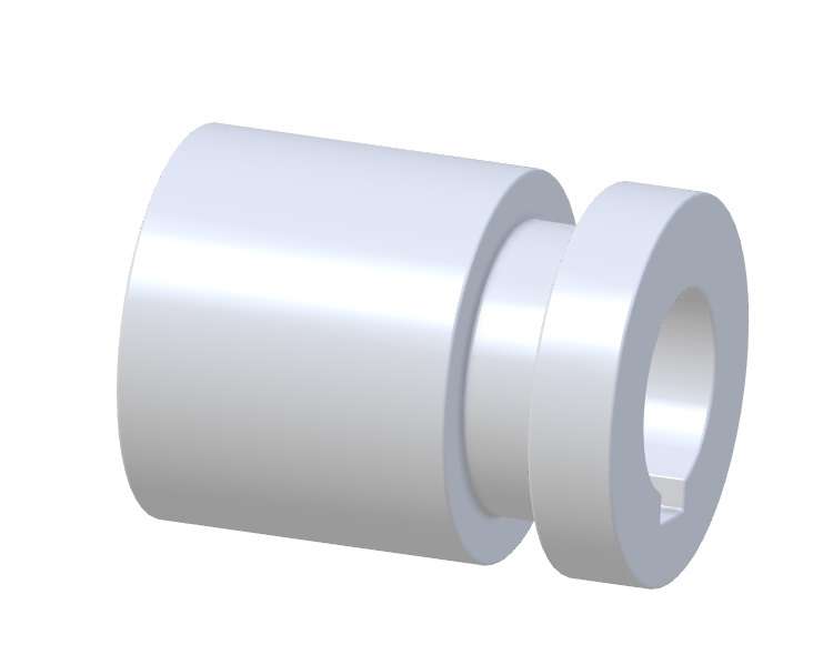

                                                John Hinkley
                                                  @johnhinkley26699
                                                  Daz996,
                                                  Is this the sort of arrangement it should look like?
                                                  Clarke couplingCoupling view_2
                                                  I’ve had to make some assumptions for a few dimensions, e.g. size of keyway, hex and hex depth and the dimensions of the groove.  I’d be happy to print one in PLA-CF for you to try, if you’d like me to, I’d just need confirmation of the missing dimensions and your address (by PM).  Permissible tolerances on dimensions wouldn’t go amiss, either, as the PLA tends to shrink diameters very slightly, although I’ve found that with sufficient wall thickness, it will tolerate a light skim.
                                                  I’m assuming, also, that you are in the UK, to judge from your electrical wall sockets.
                                                  Edited to adjust picture size to fit.
                                                  #724641
                                                  daz996
                                                    @daz996
                                                    @ John Hinkley, yes that’s what it looks like, I’m got several leads to chase up this week but I’ve got a funny feeling I’ll be taking you up on that offer, thank you
