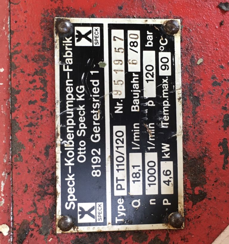

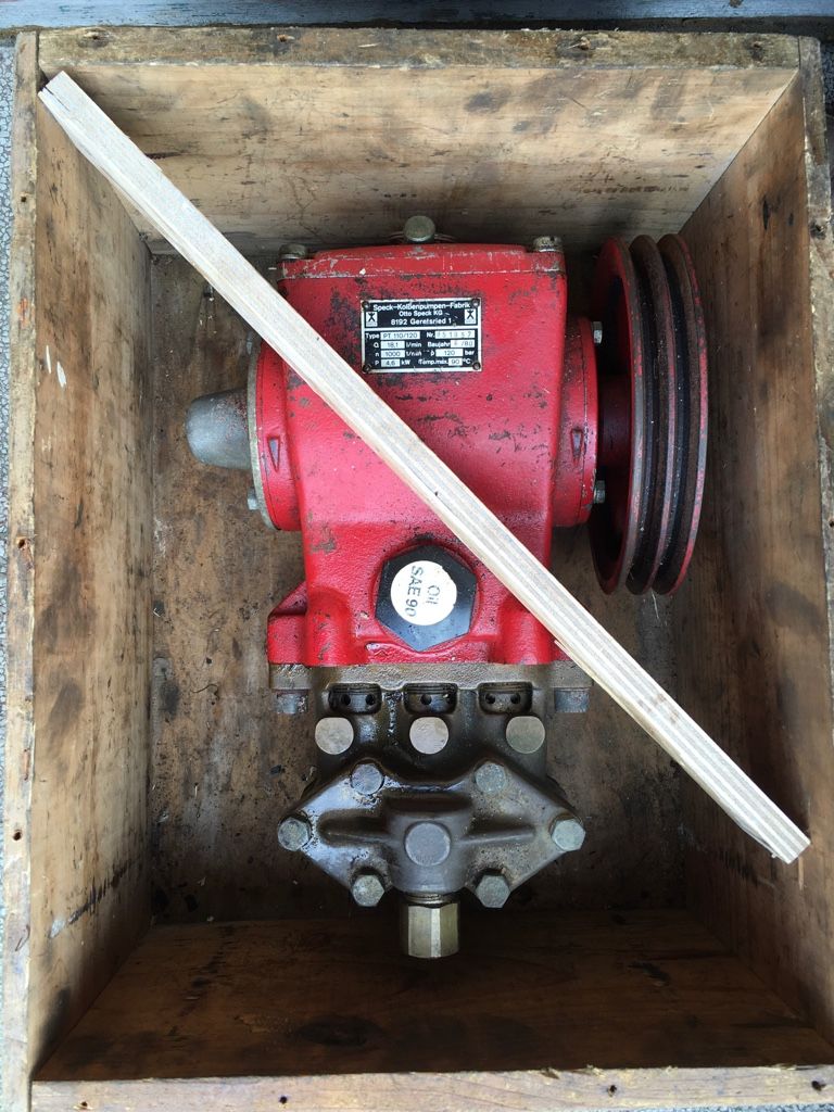

                #244036
                  Posted by Michael Gilligan on 23/06/2016 09:12:48:
                  I'm almost sure that I have one of those pumps tucked away somewhere [condition unknown!]
                  Paul,
                  Here is my pump … is this the sort of thing you are looking for ?
                  As stated, the condition is unknown: but it does turn over nicely with finger-pressure applied to the pulley.
                  For scale: The wooden box is about 11" wide.
                  Total weight is about 18kg
                  Sorry … Main picture file size seems to be too big … I will re-size and post later

                    #244058
                    Windy
                      @windy30762
                      Thank you very much for the pictures and information I think the pressure might be not be high enough for my applications and weight is bit too high.
                      Looks like I will have to make my own maybe incorporate it in main body of the power plant to keep compact.
                      Thanks again for going to all the trouble finding it for me to consider if suitable..
