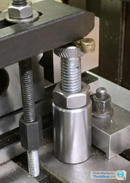

                Didn’t do much on the engine yesterday, but made a small machine jack (as per Martin's suggestion) to support the rather flexible eccentric strap end:
                I might make another, just in case I ever need two, and perhaps a couple of stepped, threaded studs so I can screw secure it into a T-slot if required.
