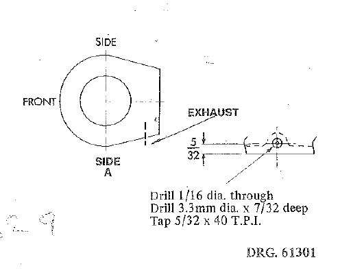

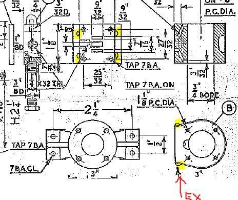

                    Just building the 10h cylinder. And trying to figure out the two holes on the same face as the inlet threading. What are they for?

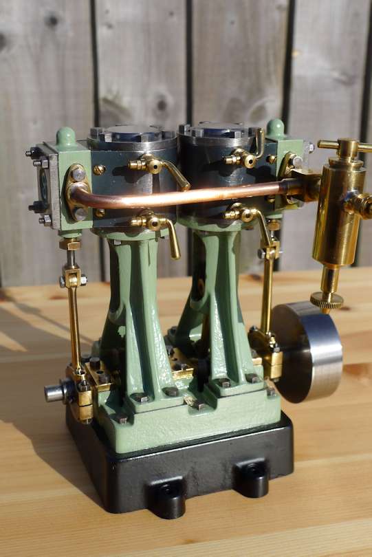

                      @richardsimpson88330
                      My 10H does not have two holes on the same face as the inlet threading.  Are they possibly an alternative for the threaded hole in case you prefer to use a flanged pipe, as they do with the manifold on the D10?

                      #820415
                        There is no inlet drilling on the 10 series cylinders the steam goes into the valve chest casting’s side.
                        You are probably looking at the exhaust which is best exiting  the bottom of the cylinder when it is horizontal on the 10H then the two other drillings are likely to be the drain holes which are also placed at the bottom  (side A below) when the cylinder is horizontal (not vertical as shown above)
                        Stuarts don’t show glands studs being screwed to any castings, they have a screw in flange that uses the single threaded holes shown on the drawings.Evenb then only needed on teh D10 and Score.

                        #820417
                          If the holes are smaller than 5/32×40 then you may be looking at the two screw holes for retaining the cylinder lagging, tapped 8BA on some drawings.
