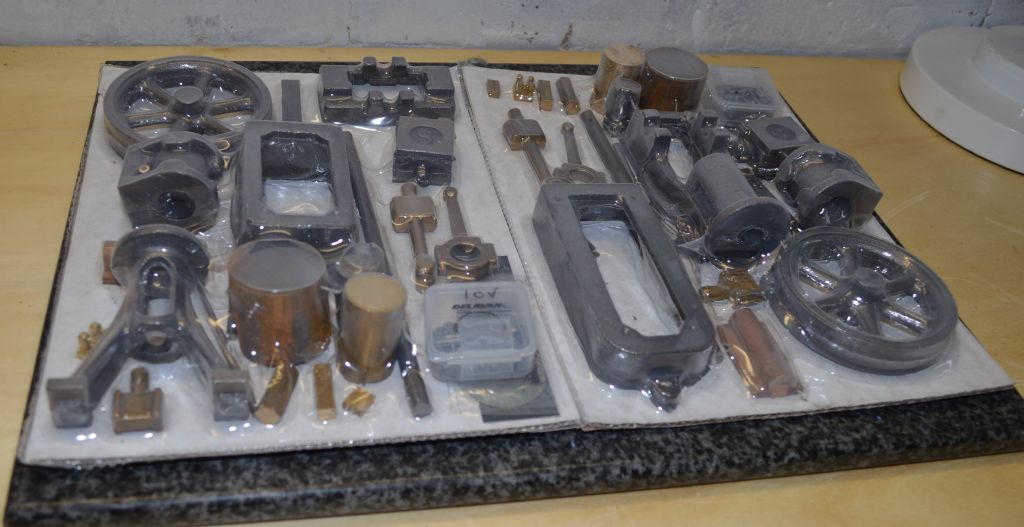

      Welcome to the build thread for a Stuart 10H and 10V. This thread is all about how to build the two engines using a small home workshop.
      I have a Warco WM180 lathe and a Warco WM14 milling machine. Also available are a Warco bandsaw, a Clarke variable speed pillar drill, a bench grinder, a Clarke vertical linisher/ disc sander, a power scroll saw, an engraving machine and an Oldak production tapper.
      The engines will be made using the Warco lathe and mill and the vertical drilling machine. Photos of the machines will be added as we go through the series.
      You may comment as you wish, I have a thick skin having been editor of both ME and MEW for many years.
      You are welome to copy the posts and photos for personal use only.
      The 10V casting set is on the left and the 10H set is on the right.

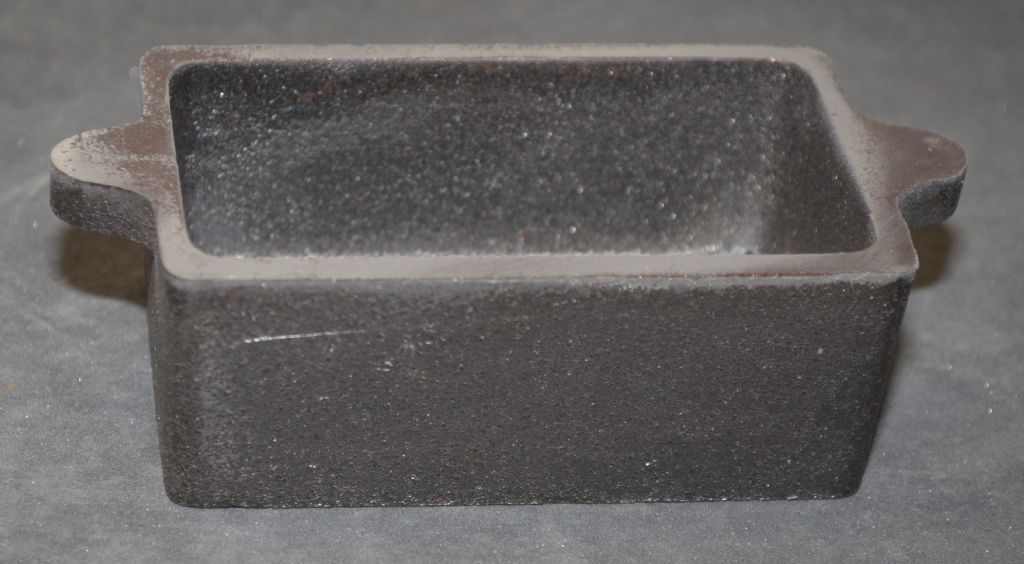

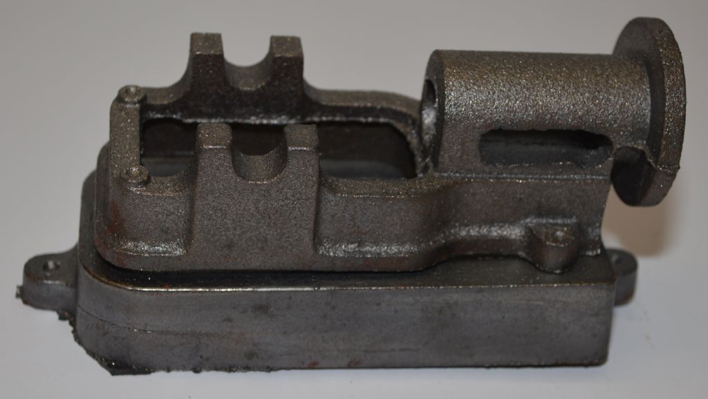

      First I have to clean off any flash and remove the casting feeds on both engine bases and bedplates.

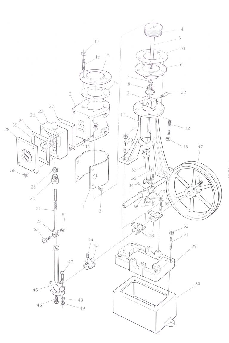

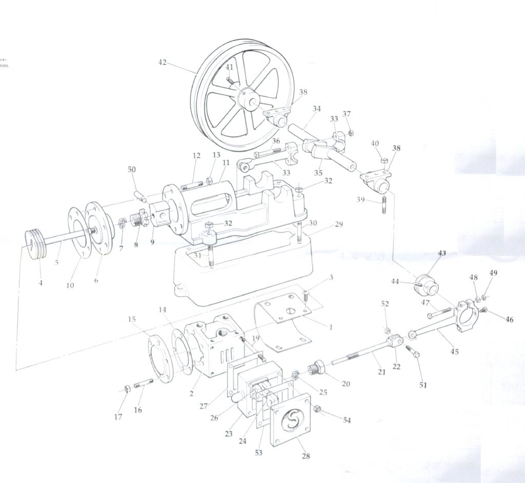

      Andy at Stuart Models has kindly given me permission to include copies of the 3D exploded diagrams of both the 10V and 10H engines.

      Exploded 3D view of 10V vertical engine above.
      Exploded 3D view of 10H horizontal engine above.
      If you click on the drawings they should enlarge to enable easy reading.
      I will use Stuart's part numbers if I need to refer to parts..

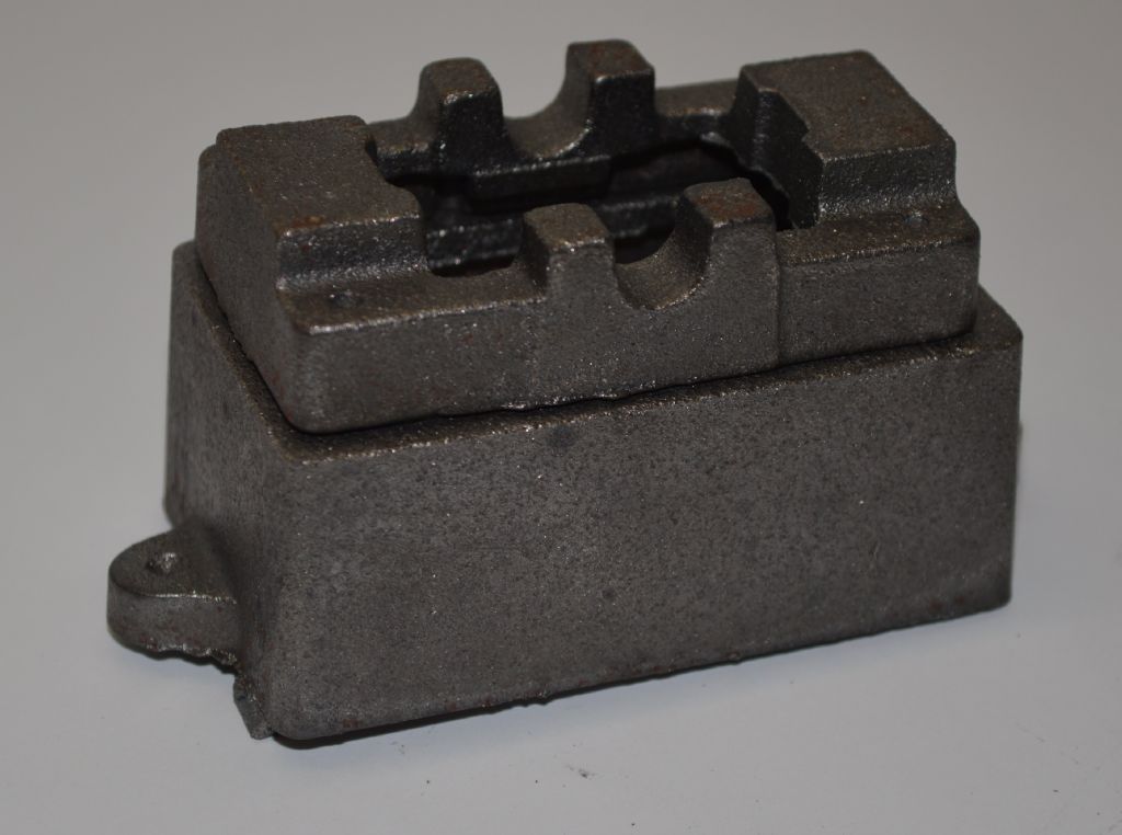

                              When refering to the Stuart exploded views, I will use the Stuart part Nos suffixed by either V for vertical or H for horizontal.
                              The photo above shows the 10H box bed part No 29H and the main casting 11H. There is a fair bit of flash to remove but this does not take very long.
                              The photo above shows the 10V box bed part No 30V and the bedplate part No 29V. There is some flash to be trimmed off as well as a casting lug to file off.

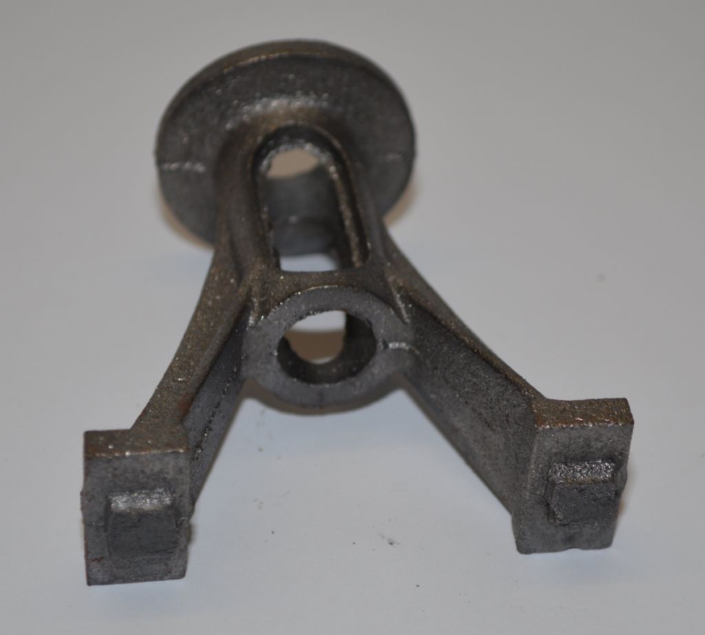

                              The photo above shows the main trunk guide part No 11V. This is a separate part in the vertical engine but is an integral part of the main bed casting in the 10H. Note the two large casting lugs that will need filing off later.
                              Three missing "V" suffix added by JasonB

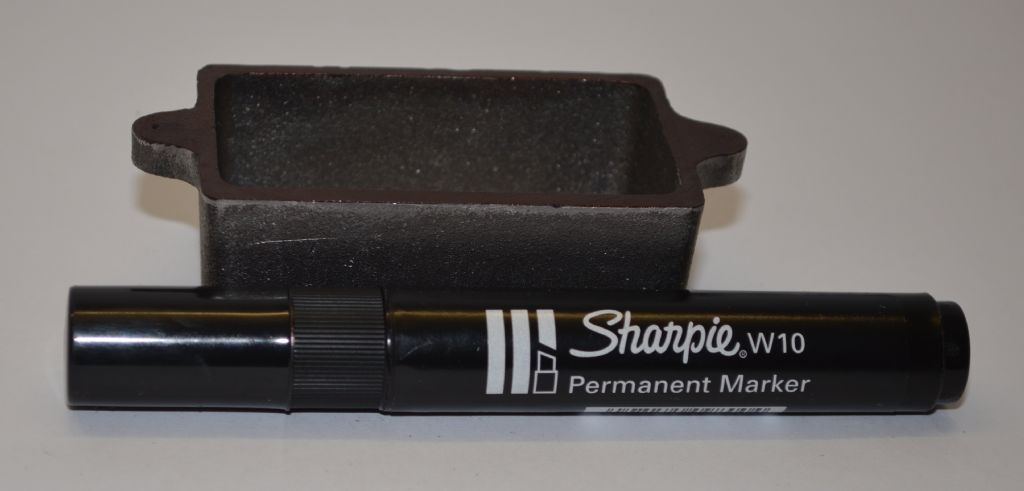

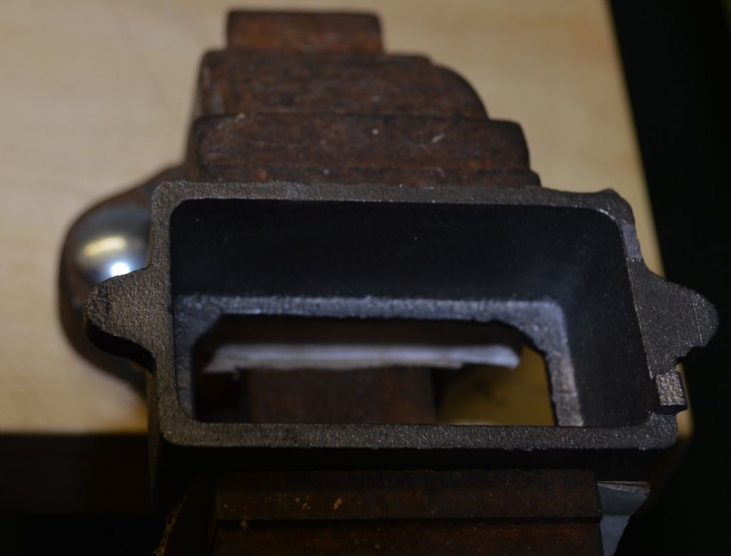

                                Cleaning up the 10V box bed.
                                I held the 10V box bed in the vice to file off the lug and true the bottom up. I used some cardboard in the vice to protect the casting. A better bet would be some aluminum angle soft jaws which I will get at the weekend. I completely removed the lug and filed the base fairly flat.
                                I used a flat file on the base and sides of the casting and a round file on the sides of the mounting lugs,
                                After filing the base flat I coated the lower face with black permanent marker. (A sharpie marker pen.)
                                Then I rubbed the base on a piece of wet and dry paper to remove the marker pen from the high spots. Repeat this sequence, lightly filing away the shiny high spots, until the base is completely flat.
                                You could rub the top surface down flat and end mill the underside instead if you wish but it does not take long to rub the bottom face completely flat.

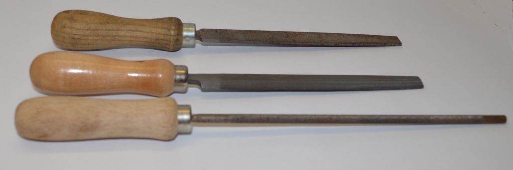

                                    I have deleted several posts.
                                    It is worth remembering that beginners may never have been taught how to use a file as metal working is not taught in schools, one only needs to read Brian John's posts to see how little some beginners know.
                                    As this is not the magazine and you are not paying to look at it there is no problem with David using as many photos as he likes.
                                    Now back to the build, considered comments still welcome.

                                                    Looking at the bed plates of the 10H and 10V- The 10V looks like it has a really rough, large grain finish (I have a Stuart kit which is the same) and the bed plate for the 10H looks like it has a very smooth, almost shiny finish. (I have a bed plate for a 10D which has that very smooth finish). The castings in my Victoria kit had a very fine grain finish, like the 10V bed plate above, but very fine (and very nice too).
                                                    So that feels like three different casting processes or specifications – The Victoria castings appeared by far the best and most realistic, but not sure Stuart produce that standard of casting any more. My Victoria castings are about 2008/9 vintage.
                                                    Can anyone explain the differences? The three forms are materially different – to the extent they could be considered different products.
                                                    Steve
