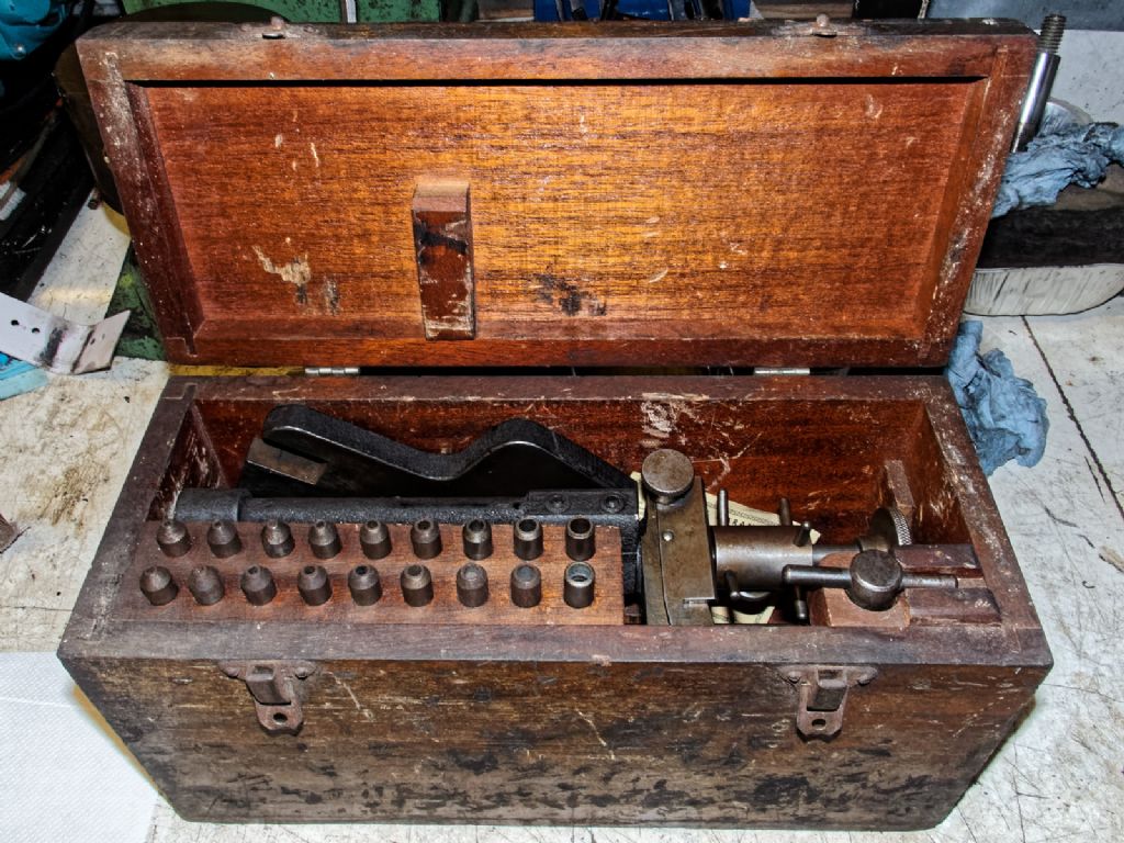

      A well used wooden box contains a set of guides engraved for BSW from ¼" down, and BA from 0 -12.
      Speetol jig in a box

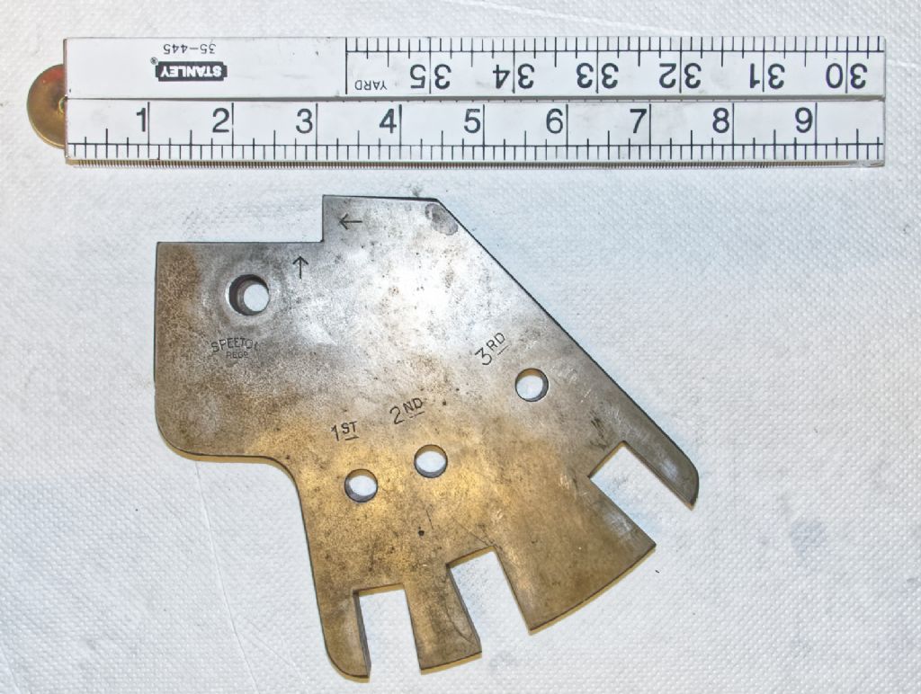

      This also contains a baseplate, with holes labelled 1st, 2nd, & 3rd, each with an adjacent slot, presumably for each of the three normal tapers in a set of taps.
      There is also a rectangular cutout with a couple of arrows, which I guess are to point to the corner of a grinding wheel.
      I'm not sure if the idea is to grind on the corner, or on the wide cutting face, or what shaped wheel it's been designed for use with. It looks to present the tap at an angle to the rectangular cutout, so I'm guessing the plan is to use the corner of a wheel. Maybe the arrows point to the point in space where the corner of a wheel should be aligned at centre height.
      The actual end of the tap protrudes beyond the plate, which would make sense, as it's above centre height, so that part of the wheel would be further away. I guess i could play with a few different diameter wheels to see if that looks likely.

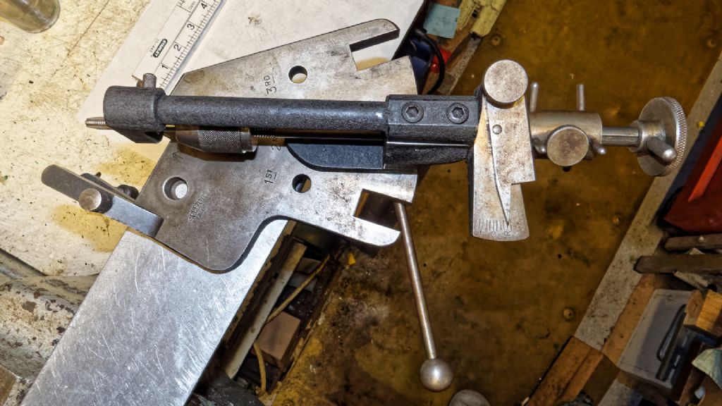

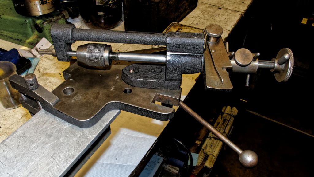

      Speetol base plate
      There is also the actual business part, with a sliding rod, and chuck, which fastens in each of the three holes. There is a cam which engages in the relevant slot in the plate which, when the ball ended lever is moved, swings the whole assembly about a pivot point concentric with the round holes.
      Speetol swinging arm

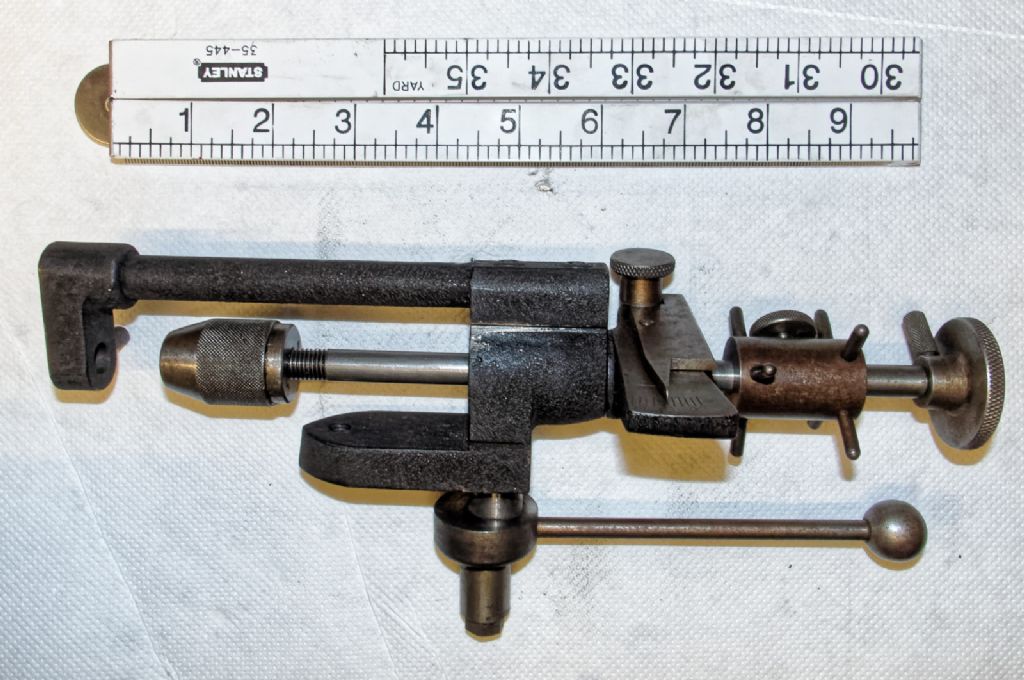

      The very right hand corner of the box contains a little Tee handled bolt which forms the pivot point as well as attaching the arm to the baseplate. Seen here assembled with a ¼" BSF tap and its associated guide bush
      Speetol assembled

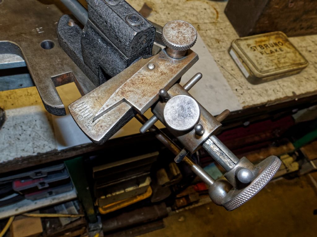

      There is an adjustable guide and 3+4 legged indexing collar, which slides the main bar and chuck back and forth as it is rotated. The knife edge guide is adjustable for right and left handed taps.
      There doesn't seem to be any way to index the orientation of the tap in the chuck; no detent to point to, or set, the cutting edge of a flute or anything like that.
      This also seems odd as it's one of those chuck that rotates the jaws as it's tightened, unlike a keyed chuck.
      Speetol relief adjustment
      And finally a plan view showing the ball ended handle, which rotates the eccentric in the slot.
      That in turn swings the whole arm about the chosen pivot hole; 1st, 2nd, or 3rd.
      There are no stops for the ball ended handle, to limit the angle of the arc, and thus the cut.
      Swinging the handle of course, will alter the angle as well as the cut, which i find a bit odd.

                Looks very much like the forerunner of the Clarkson drill and tap grinder. The three positions on the baseplate would give taper, second and plug angles, the protractor thing sets the relief angle and the thing wilt four pegs is for four flute taps, you may have a two and three peg one somewhere. If you send me a PM i will send you a copy of the Clarkson booklet, can’t get pics to work on here.
