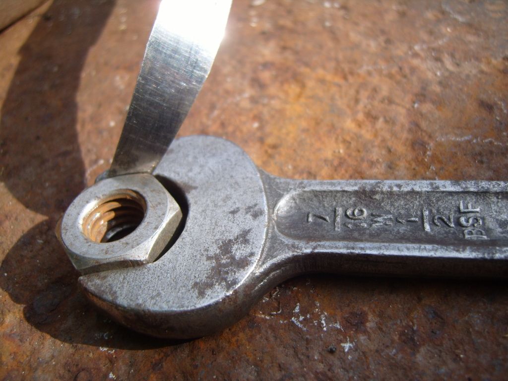

              Hi Capnahab, spanners don't normally fit exactly snug on the size nut they are made for and there is always some amount of slack. The slackness varies from one manufacturer to another and ring spanners very often have a little tad more than open ended ones. A 13/16" AF spanner should fit a 9/16" unified (UNF & UNC) nut/bolt, however it will fit a 1/2" BSW or BSF nut/bolt. On an old spanner, you may well see the spanner marked as 7/16" BSW/1/2"BSF as shown in the photo below.

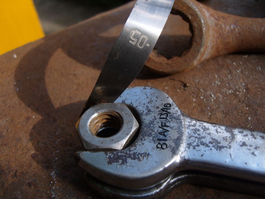

              In this photo is a 1/2" whit bolt with a clearance for a 0.2mm feeler gauge, but in the next photo is the same nut in a 13/16" AF spanner but it will only accommodate a 0.05mm feeler gauge.
              So if you can only get a similar feeler gauge or smaller or none at all in with you 13/16" AF spanner, then your nuts are most likely 1/2" BSW or BSF, you will need to find out the diameter of the bolt and the TPI.

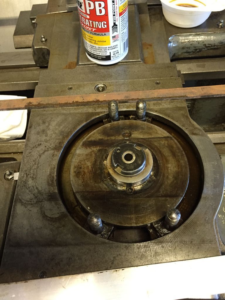

                        Thanks , I am renovating this DSG lathe. I cannot get the nuts out (which are rounded) without disassembling the topside (- my next problem) , Any tips welcome. I have been avoiding tackling the brass/bronze nuts holding the topside screw captive as there is so little room to get a spanner at them. Its the reassembly I am fearful of. I do need to do it tho because there is 58 years worth of castor oil crud in there which is now staining everything and making the topside very stiff to use.

                                    img_6311.jpgI have resorted to taking the topside off. Much old castor oil everywhere, – before and after. At least I can see the thread and have liberated the nuts.

                                              OK guys they are 1/2 inch , 12 tpi, so BSW. Have to get all the staining crud out and top half of the topslide off without disturbing the relieving mechanism.
