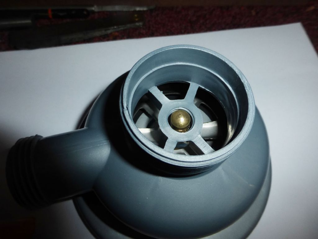

      Hi , Im putting a new sink in for my mother ,this one :
      **LINK**
      As you can see it came with the tap and tails for underneath.
      My mind is getting confused as to what i need to connect it up.

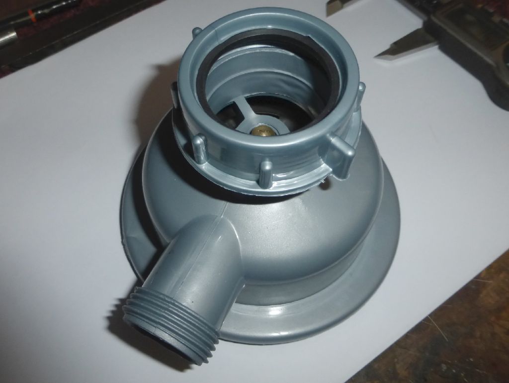

      Ive fitted waste traps before but this one seems backwards as usually on the ones ive fitted the trap underneath just screws onto the bit under the plug hole. It says in on the webpage 45mm waste connection.40mm waste pipe fits into the hole if thats any use.
      What i want to know is what type of trap do i fit as it already has a plastic nut on it????

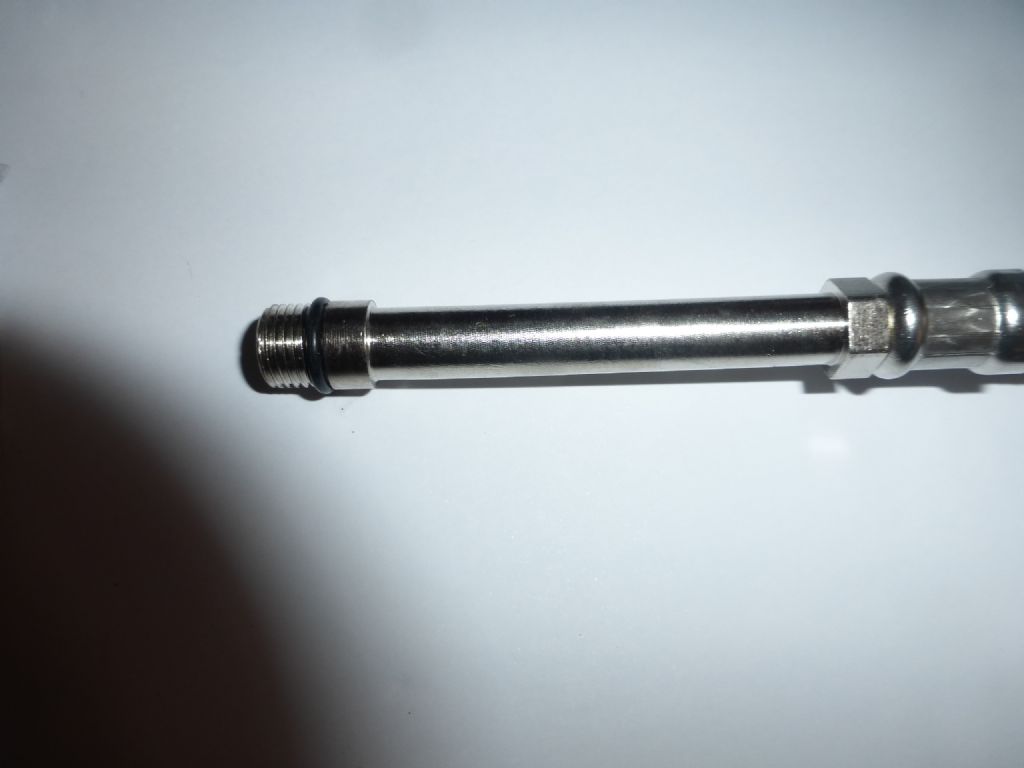

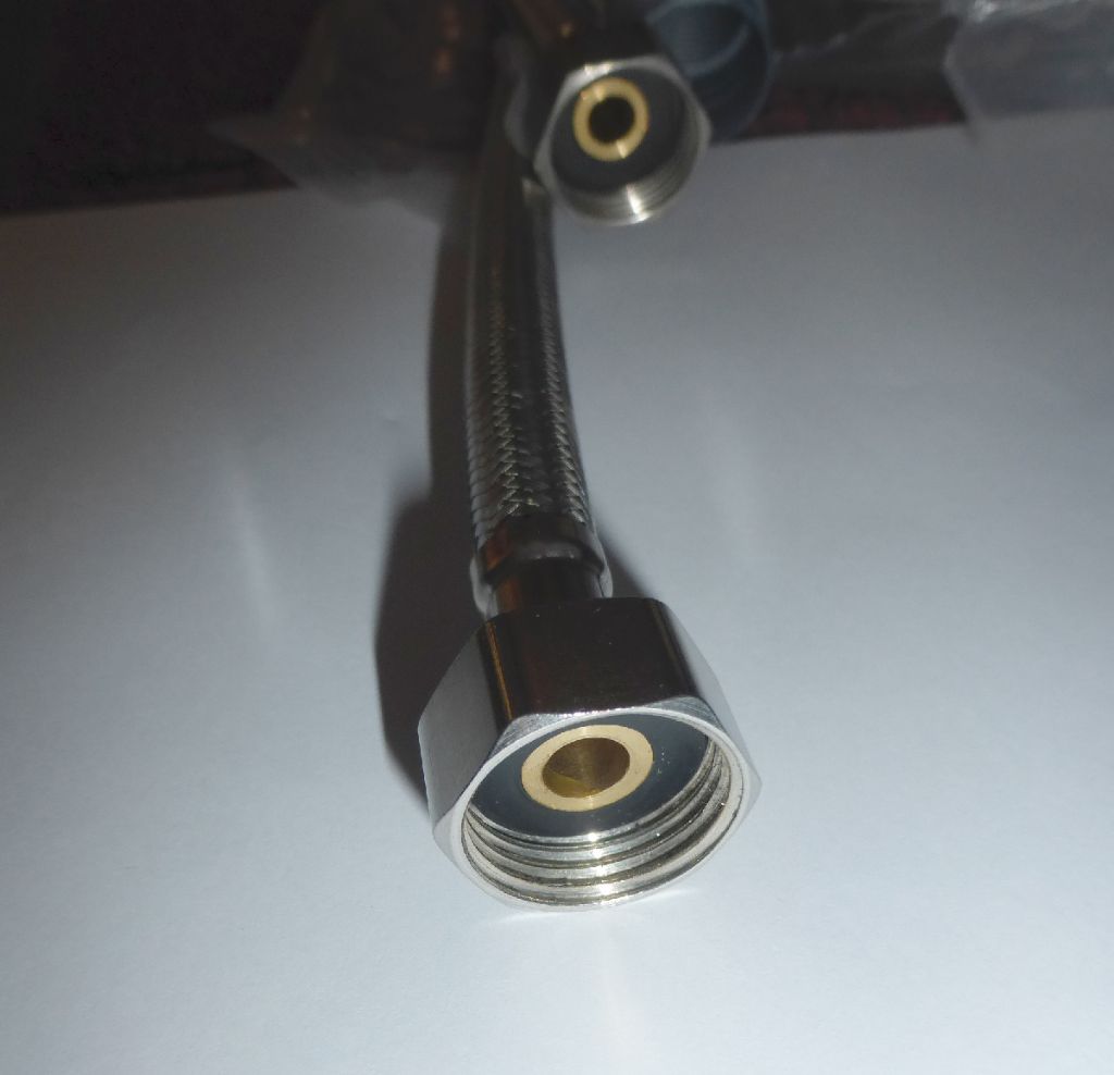

      The other thing is the tails ive used before are usually a male threaded end that connects to a standard tap connector underneath which always usually have a female nut on. ?????
      Help please.

          I think you need to put in a short length of 40mm pipe as that is a compression fitting on the bottom of the waste outlet. You can then fit a "P" trap either shallow or standard to the pipe stub. The 10mm (presumably or possibly 1/4"bsp) male end of the tail should screw in directly to the new tap base. The female end will fit the end of a 15mm compression ( or soldered on ) to 1/2 bsp stud straight connector on the 15mm copper water pipes. If you need to connect to a standard old fashioned 1/2" bsp tap you have the wrong tail. You will need one with 1/2" bsp female on each end.

            Did you not get a bag with some other bits in?, these wastes usually come with their own trap and a few bits for connecting things like dishwashers, The first bit goes into that compression socket. Used to get them on Ikea sinks and franke do similar. Personally I tend to bin them and use one with a standard 1.5" male thread which will take the usual loose nut on a P or S trap. Our waste pipe is too loose in that compression nut.
            The two large 1/2" BSP nuts will fit onto a 1/2" x 15mm fitting. Don't be tempted to screw it onto a compression fitting as the 1/2" end has a flat edge to the thread for the washer to seal against not the sharp edge due to the taper for an olive
            The other end with the O ring screws into the bottom of the mixer

              Thanks , if i fit a small piece of pipe 40mm , how do i fix the female nut screw end of a standard trap onto the pipe??
              Also wondered if the large plastic nut already on there already could be removed and a waste trap could then just screw on ? Or are the threaded nut on the top of a standard trap likely to be a different size?

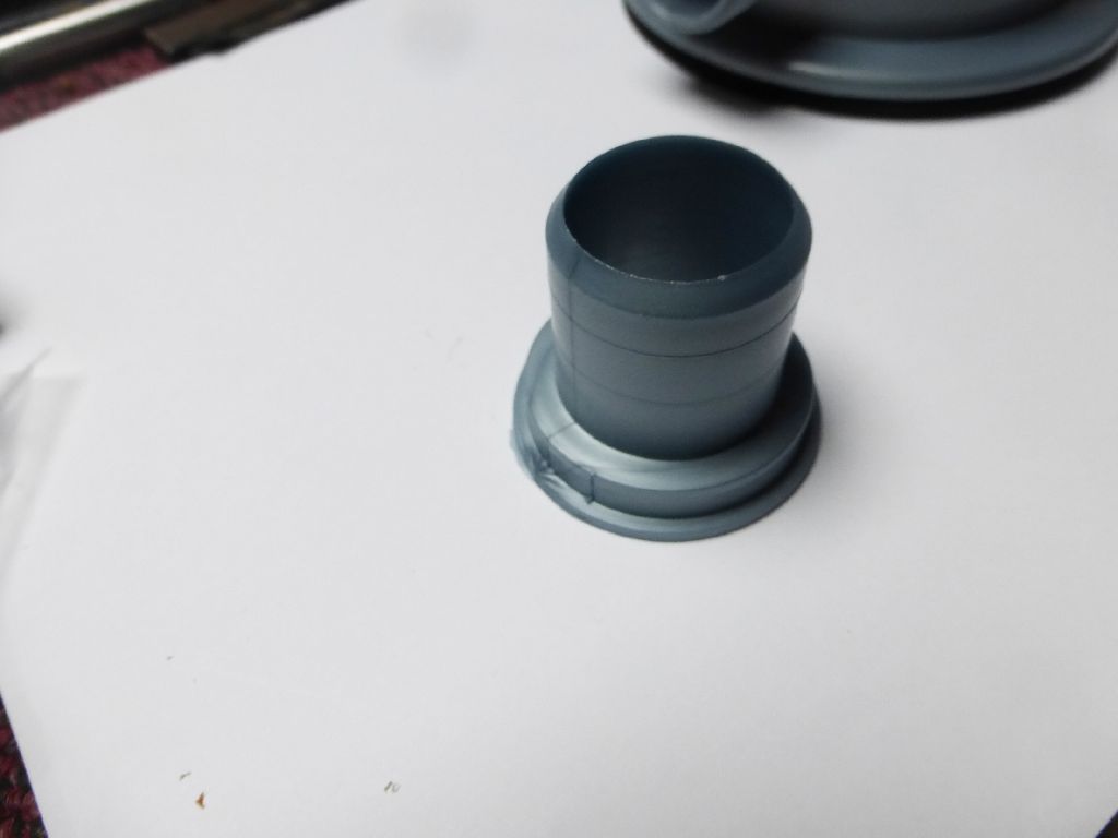

              mark smith 20
                @marksmith20
                Just a sort of flimsy plastic bush thing which im unsure what its for.

                  Problem is these days there is a mix of 1.5" and 40mm fittings. You can get an adaptor to join the 2 but you may have to search for it. As JasonB says it might be simpler to go to Wickes or B&Q and get a standard sink waste then every thing will fit together. I do not think your standard trap will fit the waste.   regards

                      Pipework is now all 40mm or 32mm and if threaded then that is 1.5" BSP or 1.25" BSP or G thread as they call it in Europe, don't get any 1.5" waste.

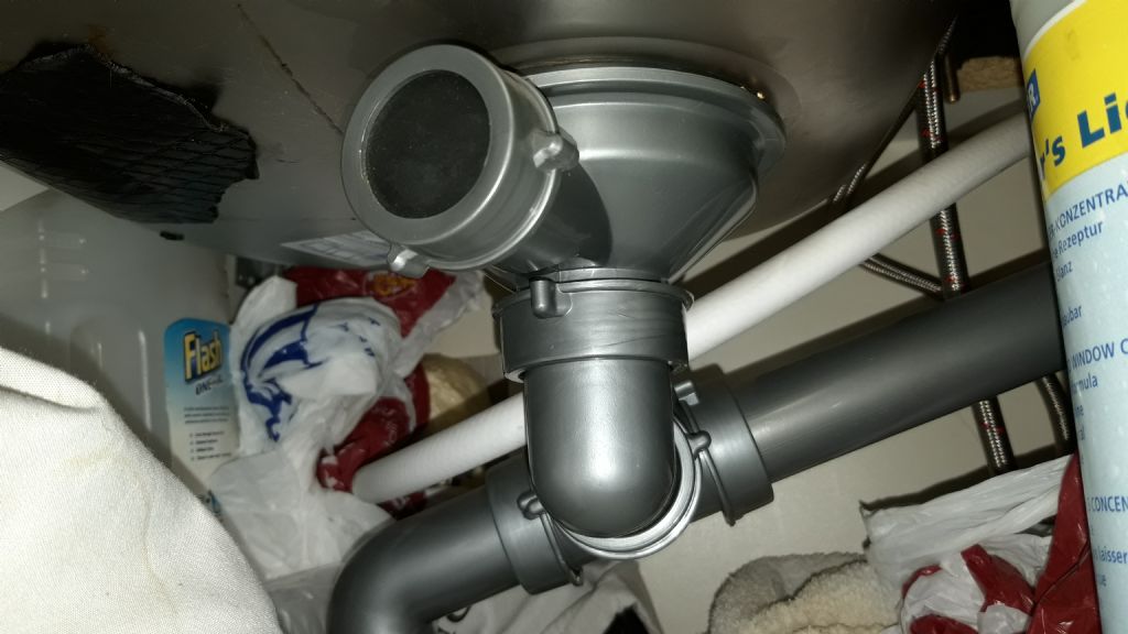

                          Hi Mark is this any use to you? It's under my sink and looks similar to yours, although mine is a one and a quarter sink. The trap (out of shot) is screwed to the pipe going to the left, it is actually on a slight angle but has worked just fine for the last 13 years. You could probably screw the trap directly on the thread where mine has the bend. Your little plastic bush thing looks like a spigot for a washing machine, this usually fits in the outlet which you can see on mine is blanked off, because the washing machine is on a separate system.
                          Here's a photo, ignore all the rubbish under the sink! who put that there?

                            I should have added that the two tap tails, I usually fit direct to isolator valves. Dead easy as they just screw together. Makes life easier for future maintenance and they are really cheap from Toolstation etc.

                                The missing part is a flat, hard rubber disc to block off the overflow neck. Putting an appliance that close to the sink can cause waste water to enter the sink or even spit it in you face.

                                  Posted by mark smith 20 on 19/09/2019 19:59:46:
                                  Doesn't that step down the outlet so you can fit an ordinary trap with a compression fitting at the top?

                                  mark smith 20
                                    @marksmith20
                                    Neil,
                                    It does look like something like that ,i`ll have to wait to my trap arrives to see if i can fit it on somehow..

                                        I think 1/2 BSP female is intended to be fitted to a 15mm isolator service valve on the 15mm copper pipe, these are available in various configurations so make sure you get the correct one. For the trap/sink waste you can buy a short plastic pipe with a male thread at one end, just cut to length, fit the plain end into your waste then the trap fits as normal.
