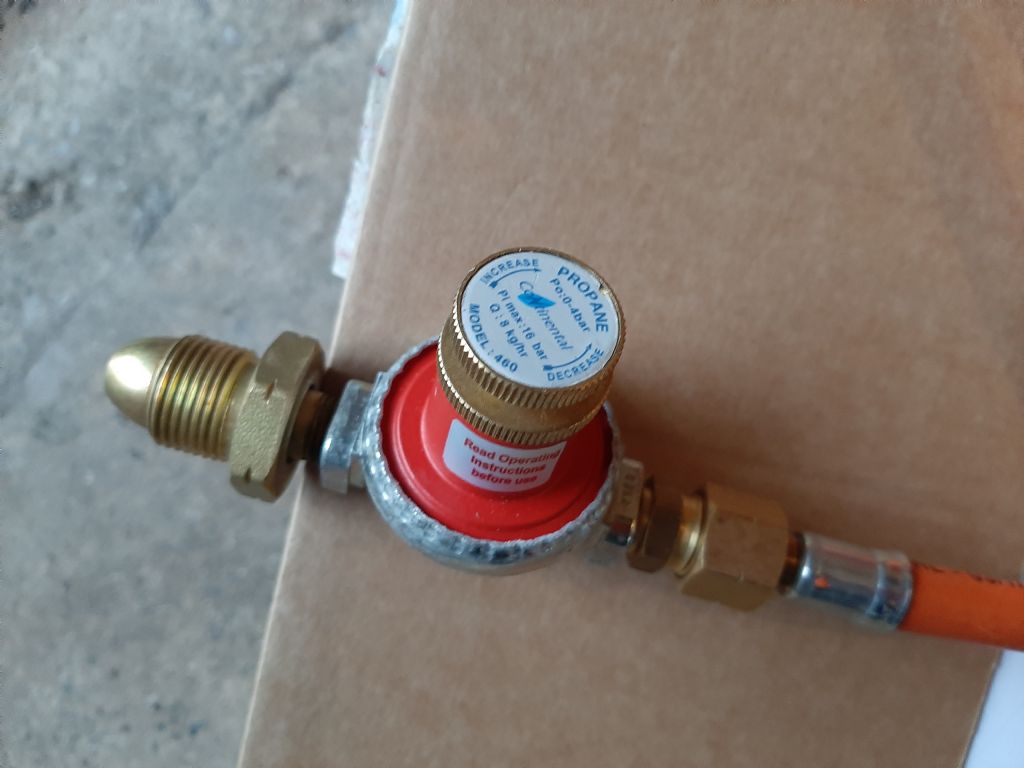

      I have just purchased a sievert gas torch kit which came with an adjustable gas regulator with a view to trying my hand at silver soldering.
      My question is how do you set the regulator which is variable between 0.5 – 4 bar when there is no gauge or other markings to suggest what pressure you have, all you have is a knob on top marked increase / decrease.
      Any help would be very much appreciated as my other half is getting very anxious at the thought of me experimenting with it.

          Experiment away, it doesn't really matter. So long as you have enough gas to be able to light it and get a nice stable flame you're on a winner. It's not going to go bang.
          Screw the adjuster on the regulator in half way or thereabouts, light the flame keeping your fingers out of the way. Now vary the torch control and see the difference between not much and Crikey!
          Twiddling the regulator at the bottle only really affects the magnitude of the "Crikey (that's hot)" setting – otherwise the control at the torch handle throttles the amount of gas reaching the nozzle, So the regulator acts mostly as a maximum control.
          The thing that really affects how much heat you get is the size of the burner nozzle. Which burner have you started with? There will be a four digit number (e.g. 2942) marked on the side of it. This describes the size of the burner orifice jet and hence the amount of gas it can pass.

              Jason no marks on the reg at all apart from the increase decrease on top.
              Simon thanks for the explanation on how it all works will do as you suggest and screw the reg half way in and experiment from there.

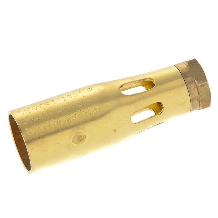

                What size burner have you got? As Simon says the number is stamped on the side and will determine the necessary pressure..
                Not all burners will run at 4 bar. Some are designed to run at 2 bar and trying to run them at the higher pressure is going to be, at best, counterproductive. At worst, the flame will be extinguished and you start to fill your workshop with propane!

                      I bought the torch as a kit and the regulator is a Continental model 460 and the burner is a 2941

                            Is this the regulator you have.
                            If so I have the same as you including the torch.
                            Like you I'm unsure about how to set it up so please keep posting I'll be very interested in your observations and any further help you get.

                                I got the same regulator as Geoff shows with a Sievert kit from Hamilton Gas Products (sorry Keith!). The kit came with a 7.7kW 2941 burner:
                                Worst that happened was was that yellow flames shot out of the air intake slots when I had the regulator pressure set too low. What I do now is open the torch valve fully, crank up the regulator until the flame is nice and roary (but not blowing itself out) then throttle back on the torch valve. Seems to work!

                                  This is the Sievert regulator. The write up says " Certain Pro 86/88 burners, such as cyclone burners and most Promatic burners, require a steady pressure of 2 bar to ensure best performance. Other burners can also operate under high pressure, but it is an advantage to be able to stabilise and obtain the same pressure on both warm and cold days. The pressure in an LP-gas cylinder varies with temperature. If the gas output is high, the gas cylinder will be cooled down and the pressure will drop. "

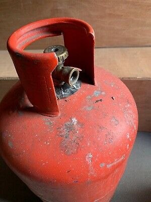

                                          When finished, I always turn the gas off using the valve on the top of the cylinder.
                                          Hi Anthony
                                          So you have a valve, like in the photo below screwed into bottle and the regulator screws into the tee.?
                                          Is it correct to say the regulator should NEVER be screwed directly into the bottle. Always via a valve?

                                              Things will get very exciting very quickly indeed if you manage to remove the right angled valve directly on top of the cylinder, shown in Geoff Walker's post above. It would be prudent to review your life insurance before trying.
                                              The regulator the OP has pictured – and the similar one also shown – all have a 5/8 BSP LEFT HAND thread which screws into the female outlet of the right angled valve on top of the propane bottle. The valve is intended to be a simple on/off valve so the gas bottle can be isolated safely for transport etc.
                                              Always close the bottle valve after using the system, or leaving it unattended. It's the ONLY valve in the system which will function as an isolating valve preventing leakage or gas escape. Neither the regulator nor the control valve on the torch are specified for this essential function.

                                                  With a screw in plastic plug.

                                                    The screw-in plastic plug is not there as any form of isolation.
                                                    It is there to protect the threads and mating surface for the outlet pipe/regulator when in use by the user. Nothing more.
