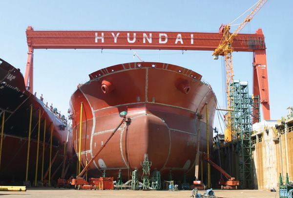

Posted by Bob Brown 1 on 15/05/2015 20:46:23:
In modern construction it is all built on the shop floor in modules and craned into position.
Bob
A lot of modern ships are built in a dry dock or a floating dock; as Bob says pre-assembled modules are craned in, welded together and internal fitting proceeds as soon as some modules are in place. So by the time the ship is floated out, or off, it is ready for sea trials. The question of building on the slant doesn't arise.
Andrew
