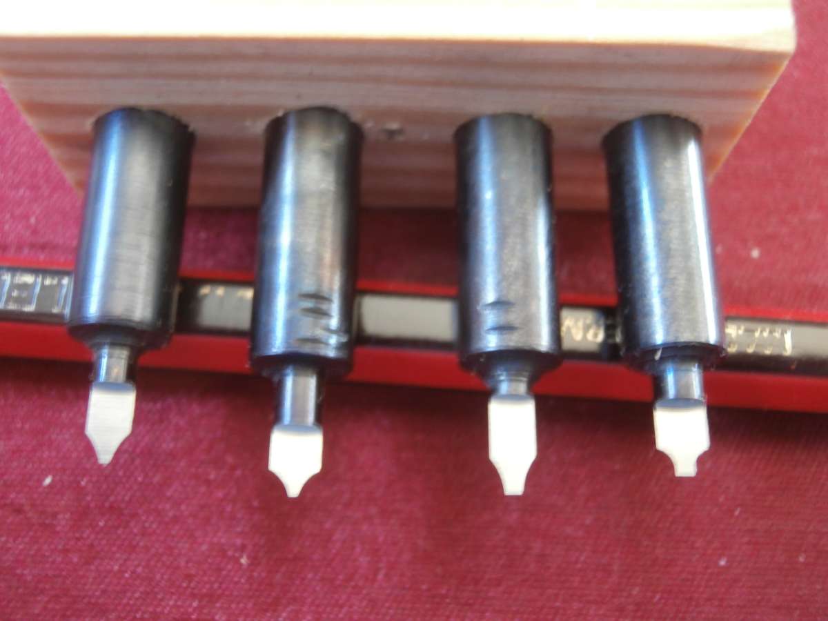

                                                    Fly cutters for cutting clock wheels are simple and cheap to make and work very well. Essentially you turn the profile on the end of a piece of silver steel (drill rod) for those of the American persuasion. The profile is a parallel section and an end of specific radius. The embryo cutter is filed to a little over half diameter and hardened. Finally it’s taken to exactly half diameter by grinding and honing. The form tool to shape the radius can be made by drilling a hole in a piece of gauge plate and filing away the bits you don’t need and then hardening. If the tools are made with care and nicely polished you get a very good result. Fly cutters can be used to create pinions in steel but it’s more of a challenge so I would recommend commercial pinion cutters.
                                                    regards Martin
                                                    #723239
                                                    Martin Kyte
                                                      @martinkyte99762
                                                      P4191107
