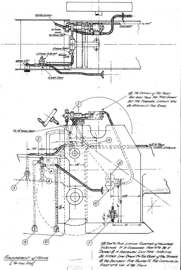

                        Piping layout for 6" RP SD.
                        Note that this has a steam operated pump and uses lifting type injectors. I have made the pump according to LSM drawings but am not sure if it will work and I am not going to use positive feed type injectors instead of the lifting type,
                        Paul

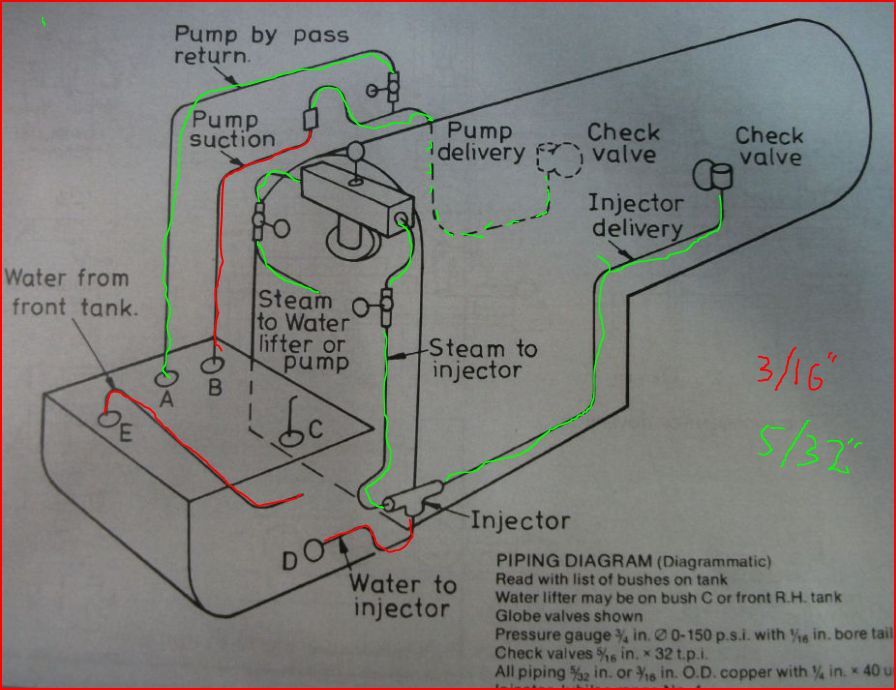

                            really struggling understanding the plumbing on the 2 inch ruston..i am new to traction engines so im sure i will get it soon.
                            its the fact there are different size fitting, but they say to use the same size pipe work thats confusing me.
                            it says to use 5/32 size pipe on ALL fittings, but i have water lifter bushing with a 5/16x32tpi fitting..do i use the 5/32 pipe still and order a fitting with a 5/16×32 thread and a 5/32 size nipple and union fitting?
                            I wasnt sure if the water lifter pipe should be of a bigger size..dscf1305.jpg
                            #166555
                              To me it says 5/32" or 3/16" pipe.
                              Its quite usual to have say 3/16 water feed to water pump with a 5/32 from that to the clack or back into the tender via the bypass. Being anything after the pump is being pushed it does not need such a large dia.
                              Water lifter steam feed could be 1/8" or 5/32" you are unlikely to use it anyway unless you have a liking for filling the engine from puddles. I would use a standard 5/16 x 32 nut and make a nipple with a smaller hole to take the smaller pipe or just solder on a sleeve to step it upto a larger nipple.
                              Injector I'd say 5/32" steam feed to it then 3/16" for water feed to it and the same from injector to clack
                              If its just gravity from the pannier tanks to teh tender than 3/16"

                                #166558
                                derek blake
                                  @derekblake72550
                                  so what you are saying is that its better to use the larger pipe 3/16" on the injector side and into the check valve on the right hand side of the boiler, but with the left hand side use the 5/32" from the pump into that check valve?

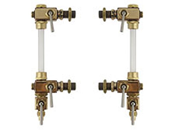

                                                      Water gauges for model engines can be purchased if you do not want to make them yourself. Also clack valves (check valve) , pumps and injectors, etc.
                                                      Note that this is the preferred position for the valve levers when in the operating position. (all levers pointing down).
                                                      Steam valve (top) – Open
                                                      Water valve (bottom) – Open
                                                      Drain valve – Closed
                                                      Regards, Paul.
