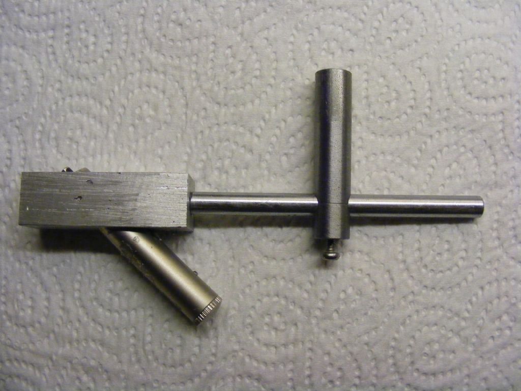

                            This is a prototype of a laser centre finder that I have been playing with. It works on exactly the same principle as the Gelbart version. It is designed for mounting in a collet on the mill spindle. The small plastic collar on the laser pointer is just for holding the on button in the on position.
                            It works very well but it is a little too sensitive because the angle of the pointer is too steep. I shall build another version will angle the beam at around 45 degrees.
                            Mike

                                  Hi Michael,
                                  Your version looks simpler (and cheaper ?). Is the angle between the laser and the centre line of the mill adjustable?
                                  Thor

                                    Hi Thor,
                                    On the prototype gadget shown above the angles are adjustable. Everything can swing about the two pins in the blocks. I made it this way in order to investigated the effect of the angle. I thought that it would work best with a steep angle so I cannot pull the angle to much less than 70 degrees with the arrangement shown. In fact I think that the angle should be much shallower.
                                    I have built a really simple version with an angle of 45 degrees and this seems to work well. I will photograph it and post a photo soon.
                                    Mike

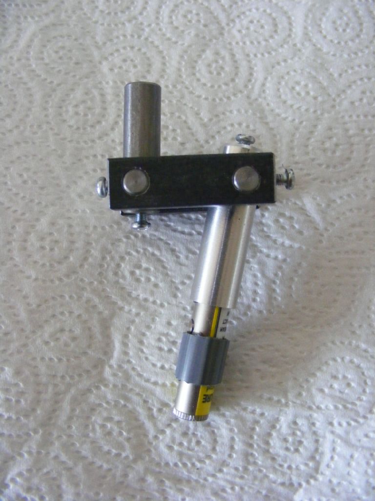

                                      Hi Thor,
                                      Here is the Mk2 version:dscf2687.jpg
                                      The aluminium block is 14 mm square and drilled through at 45 degree angle, 9.5 mm diameter, for the laser pointer. One end of the block is drilled out and tapped M5. The sliding bar is 6 mm diameter and reduced in size and threaded M5 at one end. This screws into the aluminium block. The spindle is 10 mm round steel cross drilled 6 mm for the bar and drilled and tapped axially for a 3 mm screw to retain the bar. In use the working distance can be increased by sliding the bar out from the spindle or decrease by sliding it in. The only other adjustment is to twist the aluminium block to make the laser beam line up with the axis of rotation of the mill. This is adjusted to give the smallest circle of light projected onto a surface.
                                      I hope this helps
                                      Mike
