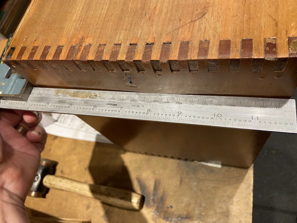

      Not model engineering but I could do with some woodwork advice.
      I have an old wooden toolbox that I would like to restore.
      It looks like it has had a really bad coat of varnish at some point in its life which I guess I can just sand back and re-varnish (?)
      The problem I have is the side of the box has bowed across its width, and the finger joint has come apart.
      Is there any way I can flatten this or should I just leave alone?
      Thanks for any help

            Once you have stripped back to bare wood damp the side down over a period of time (put it in a bin bag with some damp newspaper for example and then clamp up to some strong straight battons and allow to dry out again.

              Thanks Martin, Steve.
              I have added some photos to my album in the toolbox folder.
              Looks like the joint is not glued and will come apart ok so i could try that.
              #497717
              Steviegtr
                @steviegtr
                Ah yes i see now. So some wood glue or cascomite & a battern, plus a sash cramp should do the trick.
                Good luck & i hope it turns out well.
                Steve.
                #497721
                DMR
                  @dmr
                  I second Cascomite and you need 2 sash cramps and some strips of timber under your clampings to protect your box sides and hold your joint/s. Don't remove the varnish first. Leave it on as it will help stop the glue adhering where you don't want it. Plan ahead. Do some experimental clampings without glue so you don't get into a situation where the glue is seting on you. The point where you need most pressure is not necessarily at the worst bowing point and you cannot put 2 clamps, 90 degrees apart, at the same point on the corner so experiment without glue.
                  Work the Cascomite in with a Stanley knife or an old hypo syringe (no needle). Anything that will get the glue right through the joint/s. If you have it right it will ooze out when you clamp it up and you need some wet rags to wipe off all the oozings which should be most of what you have applied if you got it right in there.

                    A couple of suggestions:
                    When straightening the bow, I'd be inclined slightly over bend it to cater for "spring back". How much is subject to a little experimentation.
                    As for getting glue into joints, an artists pallet knife does a fine job.
                    Good luck, and be careful of spelching/breakout when finish planing/sanding.

                              What we don’t know is what is on the inside of the box, possibly expanding with the weather? I would not use Cascamite for this job – there are better, more modern – alternatives that may actually be waterproof.
                              Unless it is easily pushed back into place, there may me considerable sustained force on any glued joint to end-grain. Just look at the surface area of the joints (which would be glued when made), compared to the ends where you can get glue into the joint.
                              A stretcher, inside the box, to form a compartment, is likely needed to keep it in place. Unless the box is dismantled and re-glued.🙂

                                    As above with such a small amount of bow re-gluing and holding in place should do the trick. The only thing will be that the old joint if previously had glue on it will need cleaning off to allow the fresh glue to stick to the wood making a stronger joint.
                                    Oak will hold tannin for many years even after it has dried so be aware of that a coat of varnish will help prevent some of the staining of the wood as well as metal tools

                                            I took the option just to re glue the joints and clamp which seems to have worked ok.
                                            Now in the process of sanding it all back.
                                            What’s my best option to varnish it?, should I just use something like ronseal satin with a built in stain?

                                              No, no, no, don't use a stained varnish, they are awful. I've never seen a decent finish with them. Anyway, why cover up the beauty of natural Oak? Nothing wrong with a satin varnish, but I'd be inclined to use something like Danish Oil.
