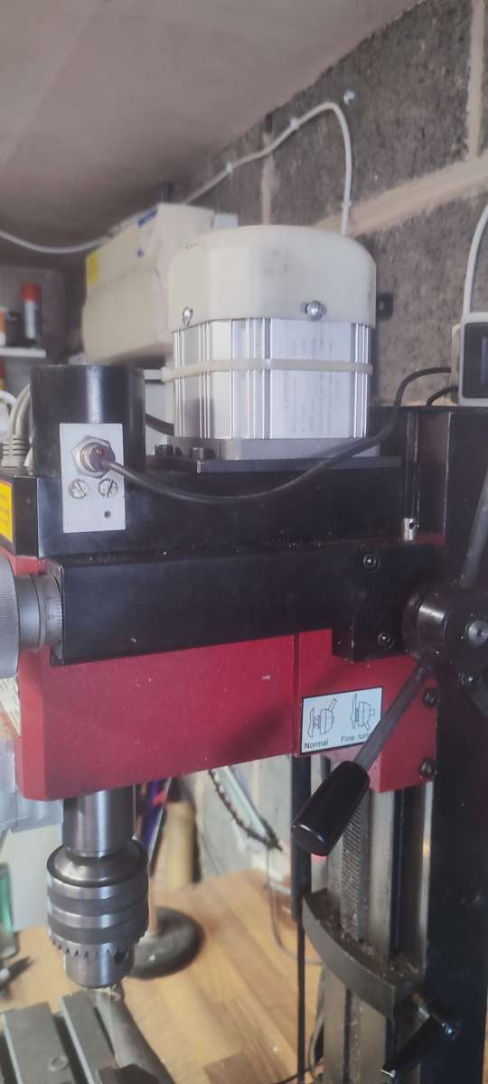

      Now this is where it gets interesting, on the original motor it is bolted to a bottom plate with tapped holes, the new motor has tapped mounting holes, hmm! Didn’t expect that, so I now need to drill out the threaded holes in the mounting plate, these holes also need countersinking as new countersunk screws are needed to sit flush with the bottom of the plate, The original cap head screws would prevent the plate sitting flush.
      The old motor had a 60mm boss which fitted into a 60mm hole in the mounting plate, the new motor had a 65mm boss, no problem, mount the plate in the 4 jaw with jaws reversed and bored to the new dimensions,
      This job done and the motor with mounting plate now sit properly on the top of the mill.
      The next job is the drive pulley, the new motor has a 15 mm shaft the old one was 14 mm, the shaft is also longer as it has a 12mm threaded section.
      I had two options here, buy a new drive pully or modify the original, I chose to bore out the original as this one is the right length to mate up to the toothed belt driving the main spindle.
      The pully now fitted onto the motor shaft(it is keyed like the original) but still leaves the extra length to deal with,
      A 12mm nut is supplied with the motor, I suppose to keep the pully on the motor shaft, the original motor had a shorter shaft (no threaded part) with a 6mm tapped hole for a washer and 6mm countersunk screw.
      I attempted to drill and tap the new motor shaft but managed to break the tap!(B****R!) so had to resort to using the supplied nut.
      This nut is too thick so reduced it on the lathe to about 3 to 4 mm and when fitted the shaft does not bottom out, so all fine.

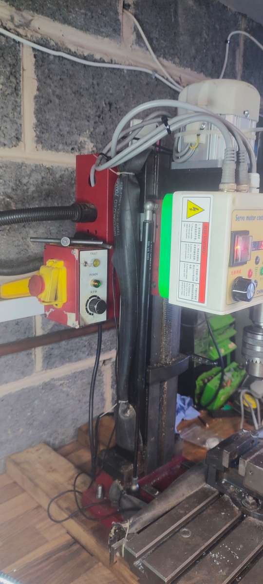

      So I decided to keep the original control box and no volt switch but move it back about 6 inches and mount it on the box at the back that held the main board. I also decided to keep the mains filter board, can’t do any harm, and wired the mains cable from the new unit into the rear box and connected the wires to those from the no volt switch.

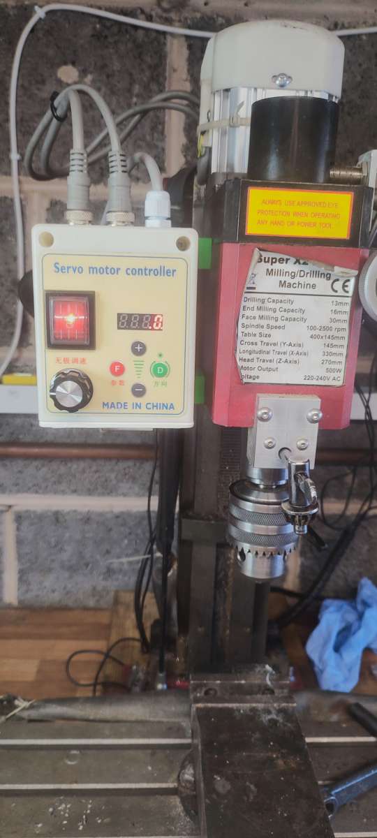

      Now I only have to mount the new control box somewhere convenient, some searching on Bambu labs site produced a bracket that I could resize to suit the new control box.
      I intend to mount the bracket where the old no volt switch was located, drilled some holes in the bracket to mount the control box and looked for some suitable screws.
      Now! Would you believe it, I had thought that the mounting holes at the back of the control box would be 6mm, well they looked that size….. no way would 6mm fit, 5mm too small (B****R once again), so what ‘expletive deleted’ thread have they used?
      I suspect it is an American thread ( I don’t have any at all) so a search through my ‘might come in handy one day’ box and found that 1BA fitted perfectly, I have not done any research but I am sure someone on hear will tell me what the thread is.
      The bracket was fitted to the mill via a couple of 5mm screws into new holes tapped into the side of the mill where the no volt switch used to be.
      Everything connected together, switched no volt switch on, switched new unit on and….. nothing. Oh! Dear.
      Silly me had not put the fuse in, low and behold I now have a working SX2P with more power than the original, for a very reasonable amount of money and a little bit of work.

          a few images as requested.

            Please however make some kind of cover for the two connectors going to the motor. They are not safe for the voltages on them. And being a plastic case they aren’t grounded. Just something to stop you touching the metal parts.
