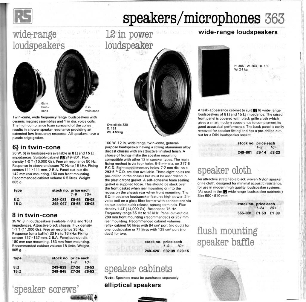

        This is a little job that some may find useful.
        Back in the late 70s I made some 'rough and ready' loudspeakers using some rather nice twin-cone 6" speakers from Radiospares. One got damaged and I replaced it, on 4 January 1981 (the date was written inside the box).
        I found them in my dad's loft, but the surrounds had almost completely perished. It took a month or so to arrive but for not much money I got a pair of replacement generic surrounds. Note that the coil suspension on each speaker was intact.
        I fitted them to the cones using contact adhesive, then glued the hard rubber mounting rings in place to hold the cones in alignment (some careful pulling was needed to ensure the coils weren't rubbing).
        I recycled the crude boxes and will make nice new MDF ones the same volume (I measured the old ones).
        If anyone has a late 70s or early 90s Radiospares catalogue, the item number is 249 031, 6" 8R wide range dual cone speaker. I'd be interested to see any information about them,

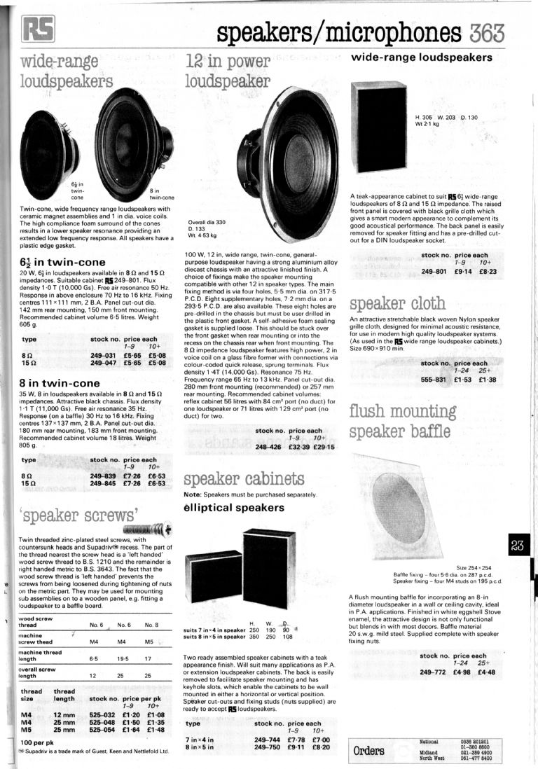

              Neil, here you go, they were still selling them in 1985, this is from the July-Oct catalogue.
              And one of the whole page.
              I can email you higher resolution scans if the forum has compressed these too much to be legible.

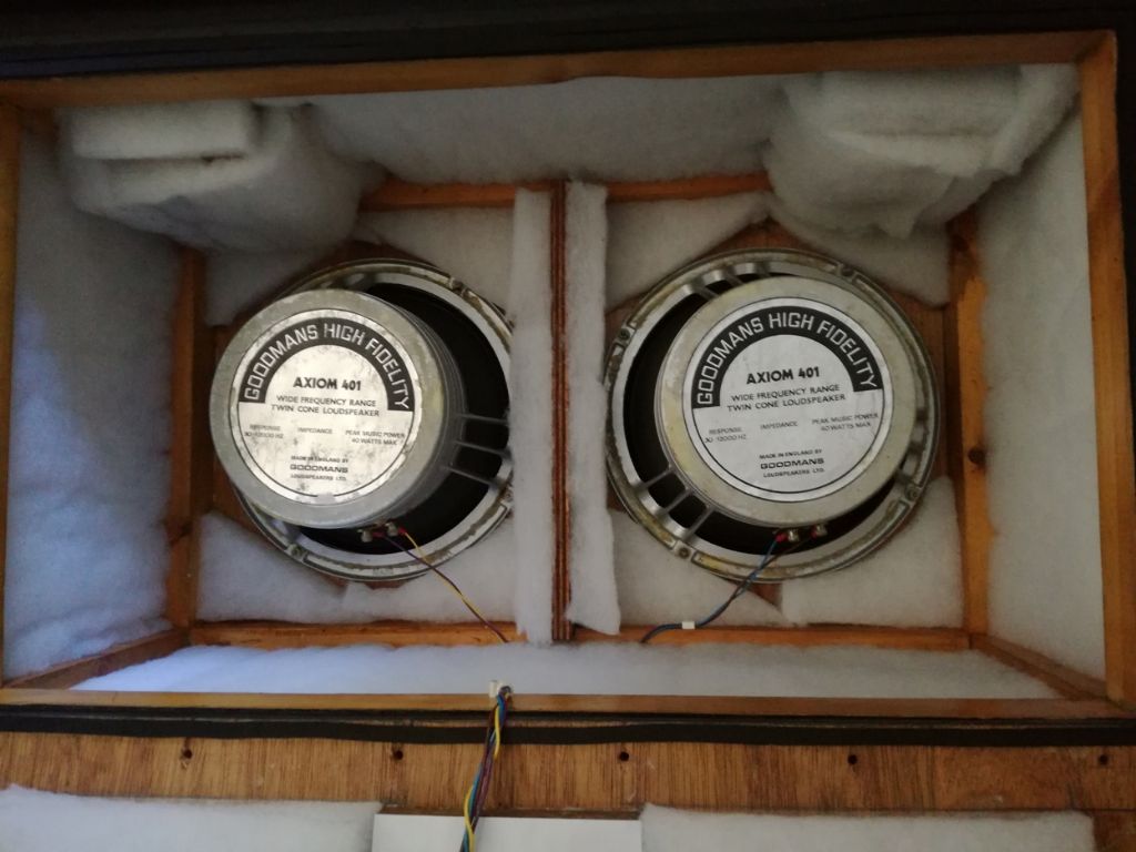

                          Hi, I relined my disco cabs with new and better quality acoustic wadding back in 2019, what I put in them when I first made them was a cheaper compromise as the better stuff was quite expensive back in the early 70's. My late brother and I, bought the loudspeaker units at a special price of £12.50, which were advertised in Practical Electronics by G.W. Smith & Co (Radio) Ltd. in Tottenham Court Road London, they were advertised as Goodmans Axiom 301, but were actually 401, we got a couple of new Garrard SP III decks for £10.25 each as well while we were there.
                          At the same time as renewing the acoustic wadding, I decided to take off the front grills to inspect the cones and the surrounds and clean any dust that may have accumulated, but after 47 years they were still in good order.
                          They still sound good after nearly 49 years and are improved by the new wadding, just sad that my late brother never heard a sound from them.

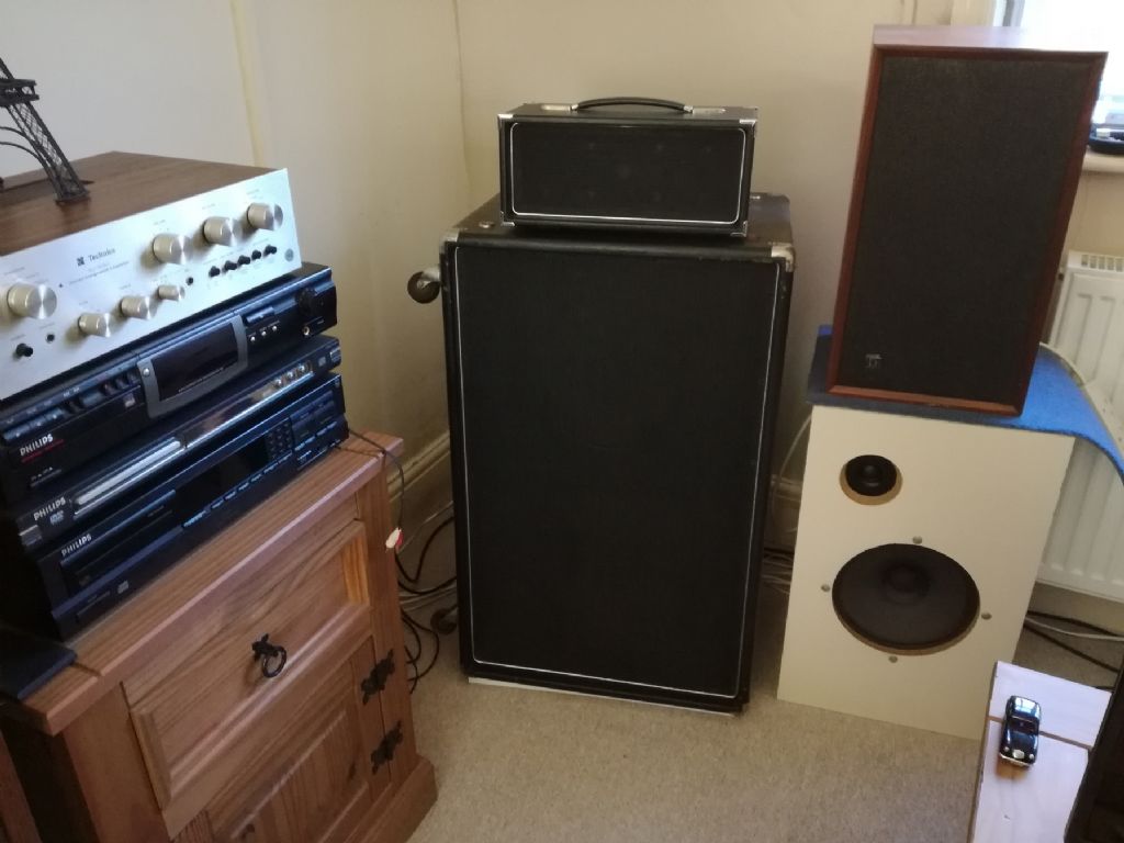

                                Hi Neil, looks like good gear and the way they are stacked reminds me of days in the early to mid 70's, when going to see some of the top bands of that time, playing in our local Corn exchange, one of which was Status Que who I saw twice, their stacks of WEM speakers and 100W slave amps, on both side of the stage, were quite impressive, there were others like Hawkwind who I saw a year or so after their Silver Machine release and Wizzard, who were extremely loud but worth the attendance, but I can't remember the gear either of those used. Many of the bands used Marshall gear and some had Orange. Like your the guitars, I did have a bass guitar once as I do like a good bit of bass, but soon found out that I could never get the hang of playing it, so I sold it and bought a CB radio when they were all the rage.
                                Now I'm not embarking on a battle of speakers or anything, but I do have a fondness of them and here's a photo of my left hand cluster, which together with the right hand side, contain 18 speaker units in all, which are all driven with a Technics SU-3050 amp but this is not to make the loudest sound possible, although they can be deafening, but the speakers may well all cover the same frequency, but produce some different tones, or a colouration of the sound if you like, and one song I like to play fairly loud through them, because I really like the guitar work, is Tina Turner's "Better Be Good To Me" which to me brings out every aspect of the guitars sound and how it's played and I think it really feel as if I'm listening to them as a live performance.
                                In the cluster are my Axiom 401 Disco cab on top of which are Fane J44 horns which also contain the crossovers for 4 or 16 ohm configuration, the cream one with an Axiom 10 and a MCM Audio Select: 53-1080 tweeter with crossover inside and fixed at 8 ohm, on top of which is one of a pair of Dynatron three speaker system with crossovers inside at 8 ohm, which were given to me many years ago, these are connected in series to produce 16 ohm configuration, which in conjunction with the Disco cabs and horns at 16 ohm give a load to the amplifier within the minimum allowed. The amp will allow all speakers to be used, or just the main Disco cabs & horns alone, or the Dynatron & cream ones alone. The Disco cabs can be used without the Fane horn and crossovers if so desired, by just connecting straight to them.
