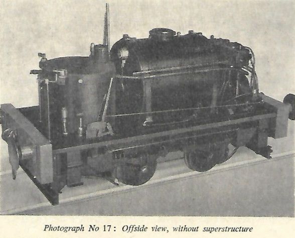

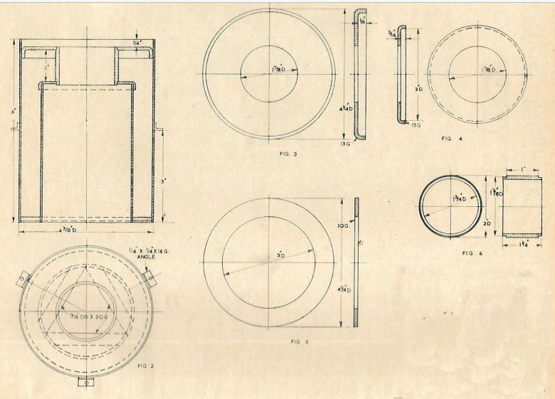

      Hi and advice please,
      I've been building a 5" guage Sentinal 0-4-0, Sirena which was published in ME in 1961. The chassis is nearly complete, boiler and the D10V are well in hand and I'm hoping to have her running about Easter time. Whilst maching some parts a silly thought entered my mind, I'd really like a 7 1/4" loco, but…. Then it occured to me 5 x 1.5 + 7.5. So perhaps it would be possible to build a 7 1/4" guage Sirena. It wouldn't be exactly to scale, but close enough. The lengthwise plans would work and minor adjustments to the width to meet 7 1/4" standards it should be possible.
      Stuart Turner even do a suitable engine, the Twin Launch engine. The one area I am concerned about is the boiler. multiplying everything by 1,5 seems a bit risky to me, especially as my club will want to know the calculations or designs before they even look at testing it. The firebox is 3.5" dia x 4.5" 16g copper.with 12 angled tubes 7/16" x 20g, the shell 4 3/8" dia x 6" 16g with plates from 13 and 10g copper. I've added the plan below.
      Advise please on resigning this so it is still vertical feed and aprox 6" dia x 9" tall.
      Thanks

                              If one treats the shell and firing tube as girder stays, the span in the original design is pretty much bang on what is allowed by the AMBSC (issue 6 is my latest). I'm sure this is fortuitous rather than by design, but it is at least reassuring. If I then make the shell 6" * 10swg and the firing tube 2.5" * 10 swg, make the top plate 10 swg and drop the operating pressure to 95 psi I get the same happy result, but I'd be happier if someone familiar with AMBSC checked over my ruminations before the OP gets his cheque book out. Any volunteers? pm me your email address and I'll send it across.

                                Is there a chimney and associated draughting on the 5" boiler – if not then i seriously doubt (infact am certain) that it wont make steam. Scaling it up would just make it worse. No fire tubes, water tubes or cross tubes? I must be missing something – but to answer your original question yes its a simple scale up. As JB has said you might need to look at the flat areas but increasing the thickness will sort that. Ive made lots of 5" and 6" dia verticals and they dont require any stays – but I do work everything out in cad first to ensure I comply with the build codes and safety margins. If you follow the ozzy codes you will comply with the rest of the world. UK codes are fine for UK but lack detail.
                                #576505
                                  Nigel, bottom left of drawing shows the water tubes as hidden detail making up the "triangular shape"

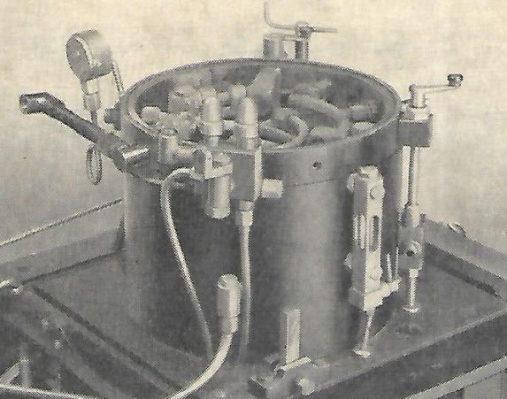

                                    image8.jpgimage6.jpgimage4a.jpgimage10.jpgFizzy, There are cross tubes, twelve of them in three banks of four, all slightly sloping upwards. They are near the top of the firebox and the top row are almost touching the flange of the firebox top plate.
                                    I only posted the main boiler drawing as I feared it might complicate things if I included the lot. But there is a steel smokebox ring that fits above the boiler and has a hole centrally with a lid to drop fuel in and towards the front is a 1" diameter tube that is the chimney base.

                                      Steve, is that a water tank between boiler and the D10?
                                      #576572
                                      Steve Bright 2
                                        @stevebright2

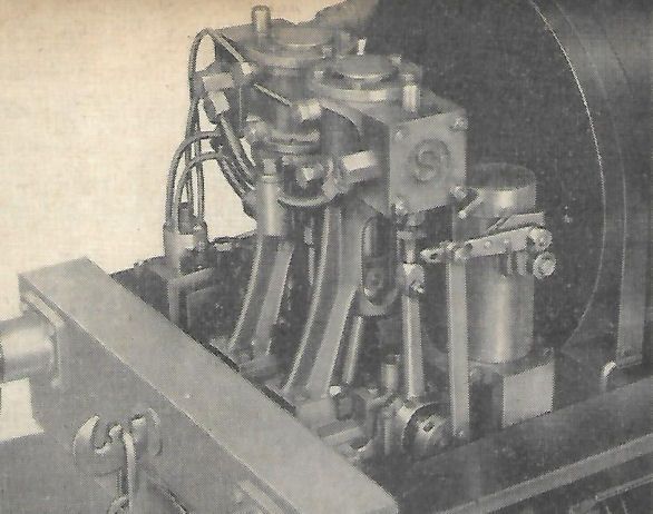

                                        Yes, 5 1/2" dia x 5 3/4" with the usual manual, mechanical pumps and an injector.
                                        The D10V is modified to slip eccentric valve gear, the mechanical lubricaror is home made and enclosed in a 1" brass tube, the drain cocks are just visable in the side photo and as they wouldn't be accesible with the bodywork in place all 4 come to one valve operated from the cab. The engine is mounted on it's own base so is a complete assembly removable easily.
