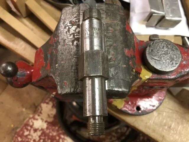

      Hi all.
      Im looking for a record Cylinder head holding plug.
      Anyone any ideas please?
      2015-06-13 23.31.01chhps-l1600
      #753400
        Item 6. on the parts list says it all doesn’t it ?
        The only thing that surprised me was it being described as steel [presumably a trick of the light that the one in the photo looks more like brass]

            The threads will be 18mm or 14mm ( I think ) eg spark plug sizes so weld an old plug to a bit of stock having smashed out the insulator. You can now make all the modern sizes ! Noel.

                  To machine from scratch 20 mm hexagon bar ! Noel.
                  #753460
                  noel shelley
                    @noelshelley55608
                    On reflection and in the cold light of day in an imperial world 1″ hex looks a better choice. Noel.
                        When I read your earlier post, I thought your original choice was inspired by your mention of 14mm spark plug threads and thought it a clever suggestion.
                        To me, it would be sensible to make the hexagon the same as that of the spark plug, so you could use the same plug spanner to install it.
                        I had to go and look it up, but it appears modern plugs use 20mm A/F.
                        Always a dilemma: do you make it period correct so it fits nothing modern or make a copy to suit today’s threads and A/F sizes?

                          Noel – Agreed. To scale off that photo it’s approx 21mm (7/8″?) – Is 7/8″ available? So, will have to be 1″. And prob 4 1/2″ long.
                          Clive – there are a lot of them about actually. You’ll have seen on eBay people trying to get £100’s for them LMAO. All the parts are available incl. period correct paint, spring kits, missing parts, jaws, pipe clamp. You could spend between £25 and £ 100plus on this project so buy wisely. There is no money in restoring it, just a decent vice if you need another.
                          DC: Good points mentioned. I think the threads today would need to be as mentioned above 18×1.5mm and 14×1.25mm. Does anyone know of any US&UK imperial plug sizes?
                          Of course, simple to turn – so could make both as easy as making one (with the right dies).
                          BTW: The cheapest (BGS) dies seem to be approx £7 each; +1″ MS Hex bar (£10-20). So, approx £30 + time?
                          Then I’d have to buy something with a knackered engine to even use it.
                          Back to square 1, I think.

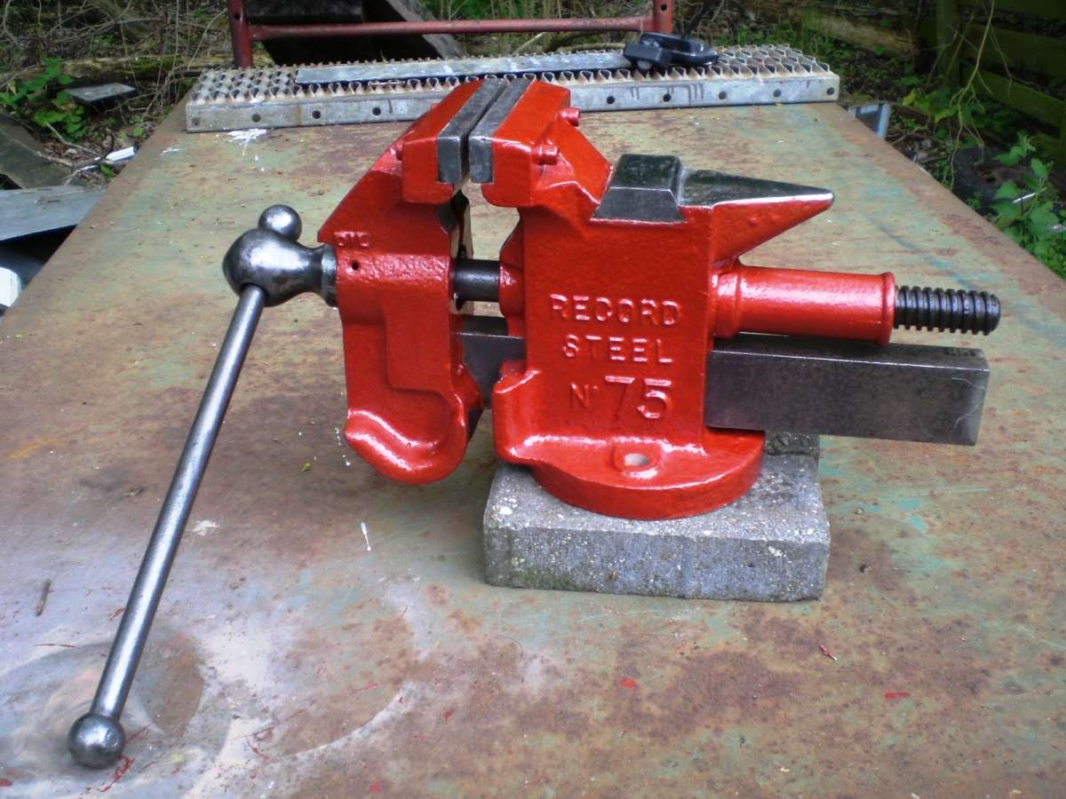

                            Hi, I’ve got a Record Garage vice No. 75, which is similar to the 74, but a little larger.
                            Record 75 catalog page-XL (1)
                            I refurbished it 17 months ago, and it can be viewed Record No.75 #1 and Record No. 75 #2
                            Vice#75
                            I don’t have the cylinder holding plug, and it seems to be one of those things that often go missing, either by being lost, damaged or by others that didn’t know there was one associated to these vices.
                            Regards Nick.

                                      Look at the 18 mm thread ! + 1.5 or 2mm both sides =21/22mm + the step to the hexagon 1mm on both sides ! so 24mm hex or 1″ or 15/16″. 22mm or 7/8″ is to small. As for other sizes, There’s 10mm,motor cycle, there’s taper seat eg ford pinto engine, vauxhall I think used 5/8″ taper seat. Hex sizes, there are many, 5/8″, 11/16″, 3/4″ 13/16″ are some.  Noel.

                                        Noel, you may be correct. looking again the shoulder on at 18mm end looks to be 24mm. So 1″ it is.

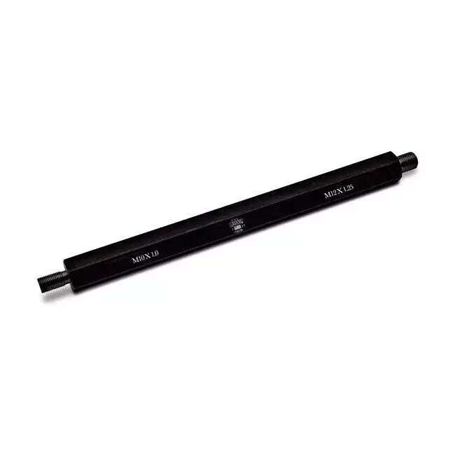

                                          modern equivalents for bikes I believe:
                                          With 10mm & 12mm threaded ends. cost £92
                                          92s-l1600
                                          With 12mm & 14mm threaded ends (for Harley?). cost £62
                                          62s-l960
                                          #753731
                                          Grindstone Cowboy
                                            @grindstonecowboy
                                            Amazed at those prices!

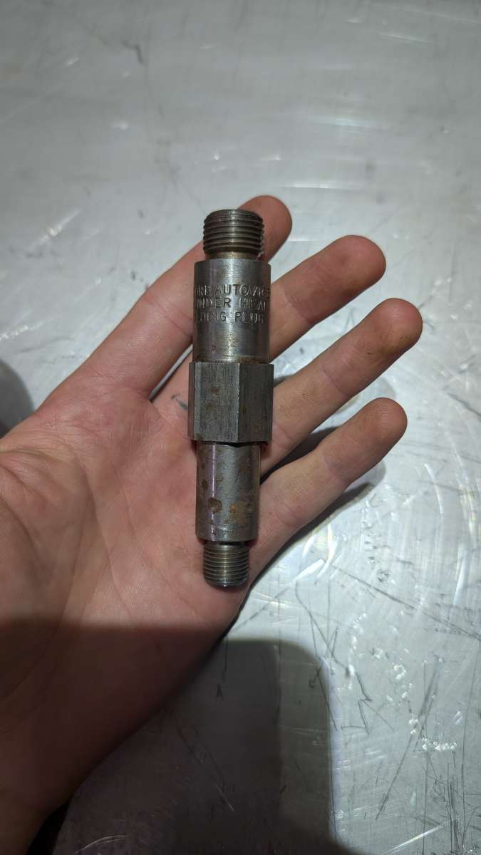

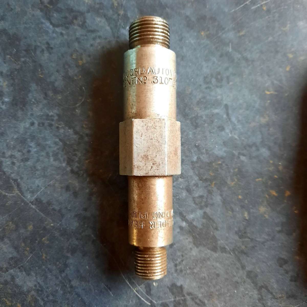

                                              Hi Danni,
                                              Just set up an account so I could reply. Are you still looking for one? Because I have an original here for you! PXL_20250727_092122939.MP
                                              #809419
                                              Danni Burns
                                                @danniburns84841
                                                Thanks again Tom. Very much appreciated.
