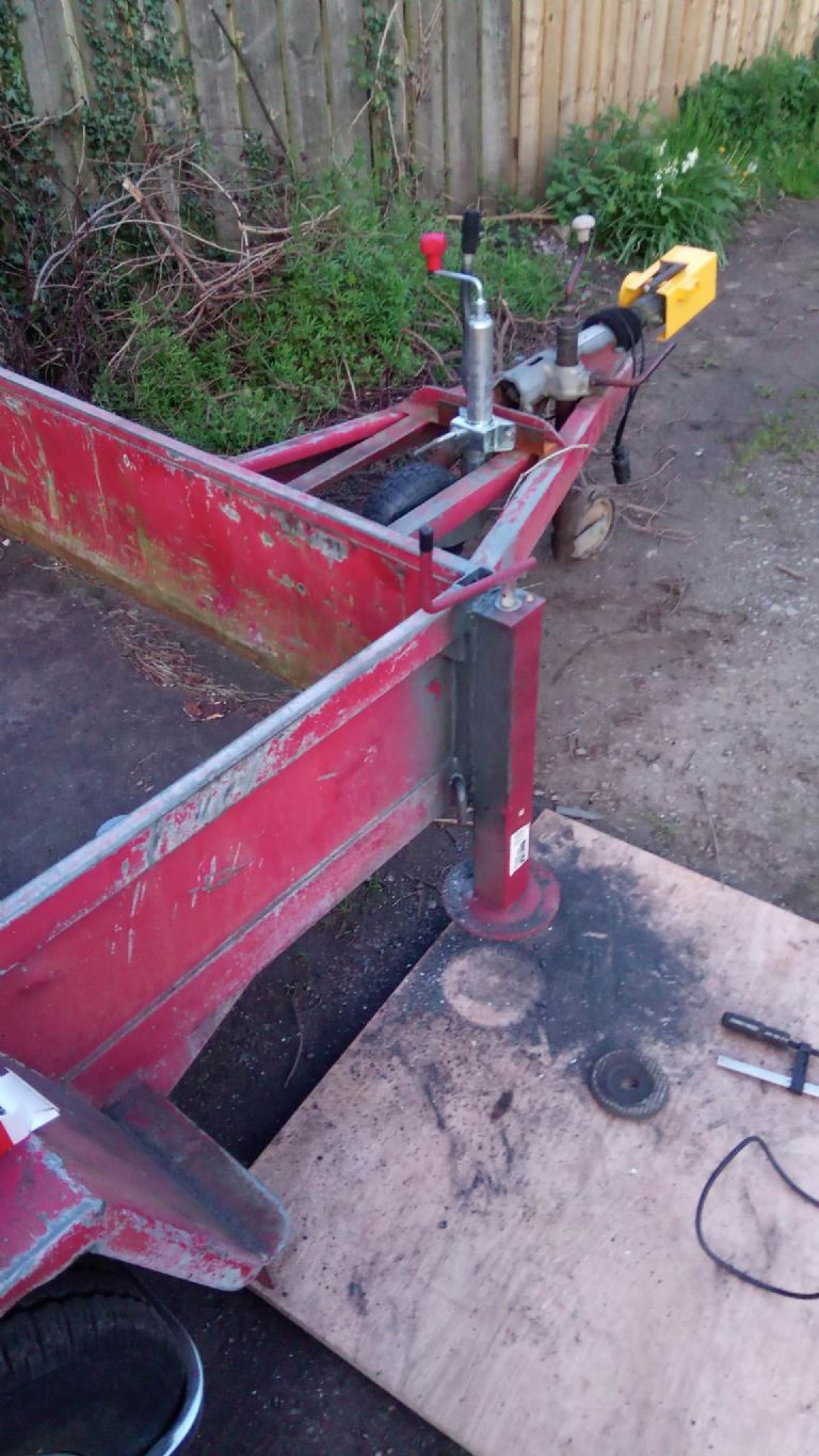

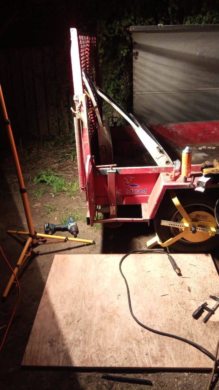

                  Fitted 2 of 4 of the Weld-On Jack Legs on the trailer.
                  02-05-22 Front Trailer Leg
                  I have to admit that I was a bit out of practice on my vertical uphill with the arc welder, as can be seen from the copious amounts of grinding dust, I had to gouge back several portions of the root and reweld before I was truly happy with the job, but got there in the end.
                  Just as well I got the practice in there, as there's a lot less weld area available fitting this one, I think I want to do a weld along the bottom of the mounting plate too before I'm really happy with it…
                  But will wait for daylight and the other legs to be fitted so I can raise the whole thing up, welding in the overhead position is hard enough as it is without having to contend with access so tight I can barely get my hood underneath.
                  Probably going to want to inject some lanogard or waxoyl too once it's all done as the internal hot dip galvanising definitely burned off in places.
                  But this should make it a lot more secure for moving machines going forward, just need to sort the electrical issue that causes a fuse to blow in the truck every time I tow it now.

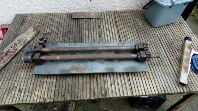

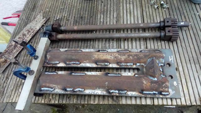

                    I never did the job a cheap bead roller was acquired for, and it was abandoned outside for several years. It resurfaced as part of my recent Grand Clear Up, so I decided it was time to make it usable.
                    I cleaned the worst of the grot, freed off and lubricated the shafts, and replaced the crappy hardware:
                    These are cheap for a reason: the slotted 10mm steel plate twists as soon as you apply some tension, and gets even more out of shape as you roll the workpiece through the machine. It needs to be a lot more rigid to do some real work.
                    Fortunately, The Grand Clear Up also provided some grotty angle iron that had been fence posts for about 50 years, and wasn't usable for anything important. A few minutes cutting and welding, with the ends clamped parallel, sorted the rigidity problem:
                    I ought to make a stand for it – some scrounged gate post, welded to a wheel is likely – but it does work clamped in the vice. A sliding fence for the workpiece will be easy to make, as are some tipping dies.
                    And a small 12v winch motor will save the need for another pair of hands to use the thing properly.

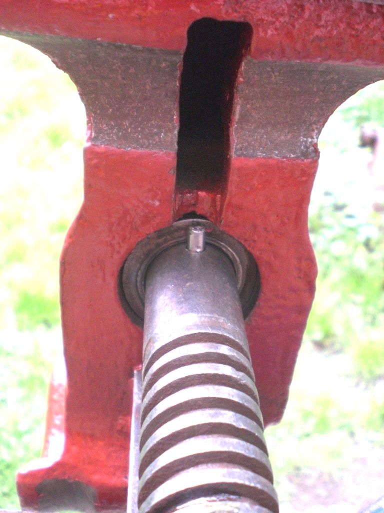

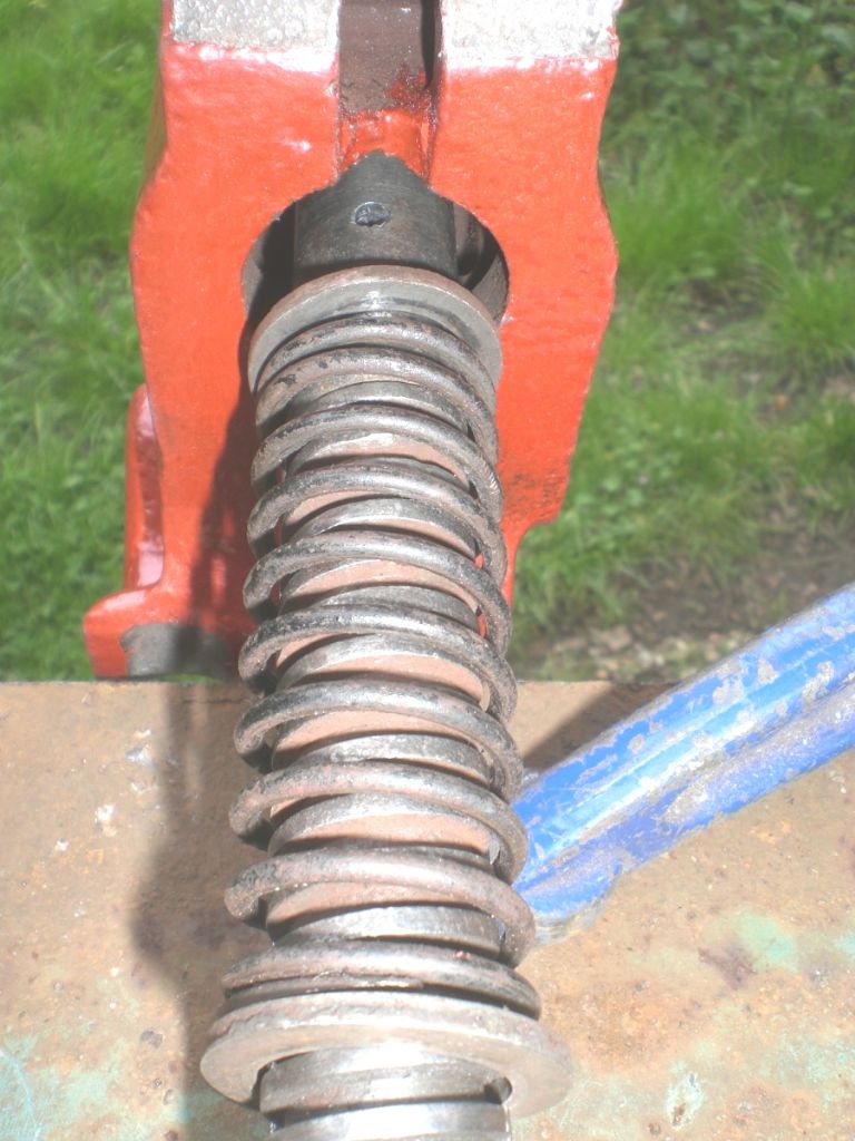

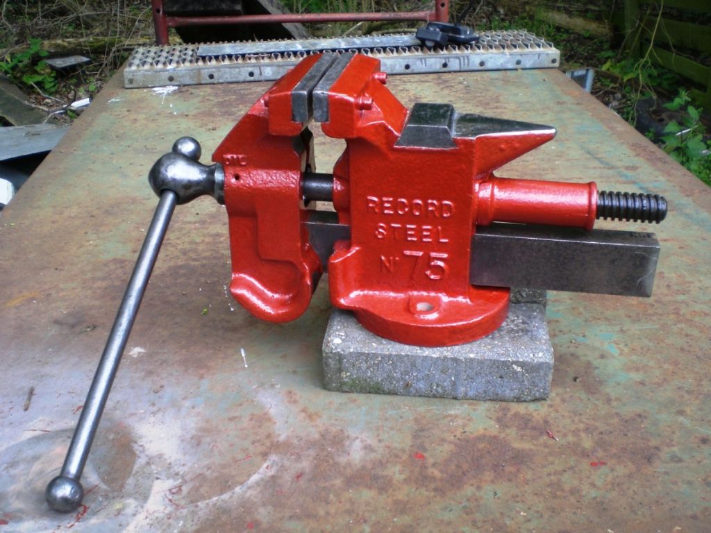

                                Hi, a little job today was putting the screw back into the moving jaw of my Record No. 75 vice which I took apart, cleaned up and painted. This wasn't as straight forward as one might think, as a washer, a fairly strong spring and another washer, all had to be compressed to enable a new pin to be put through the plain part of the screw.

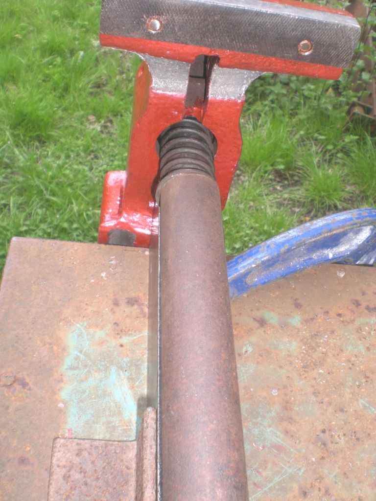

                                The only way I could think of doing it without spoiling the paintwork, was to clamp the bar that slides through the vice body, to the bench and use a piece of tube to push on the outside washer, which then had to be compressed by 40mm or so.
                                This of course, then covers over the hole that the new retaining pin has to go into. Not wanting to hack this piece of tube about, as once you cut a decent length of tube, you know you may well need it to stay the length it is for a more permanent job. so I found a short piece of tube the same size, and cut a slot on both sides, so the pin could be fitted.

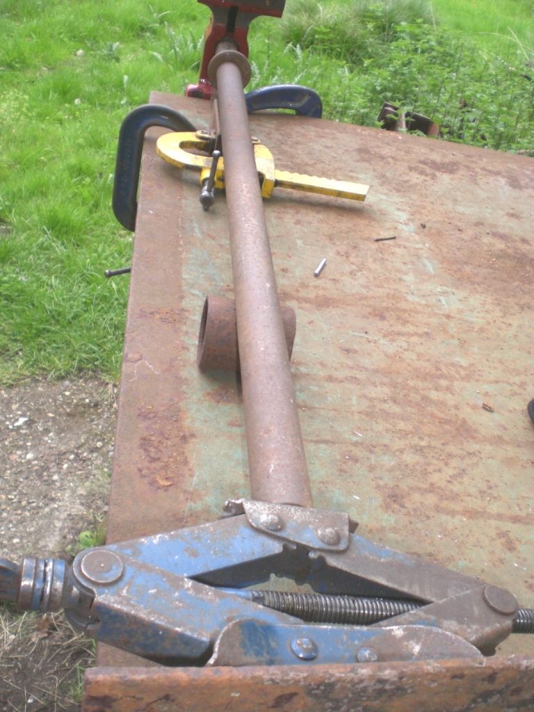

                                Although I could compress the spring enough to get the pin in, I couldn't do both at the same time, and so I clamped a large piece of angle iron to the bench, with my old scissor jack placed between that and the other end of the tube, which left both hands free to put the pin in the hole with a long pair of nose pliers, and then tap it home with a pin punch and hammer.

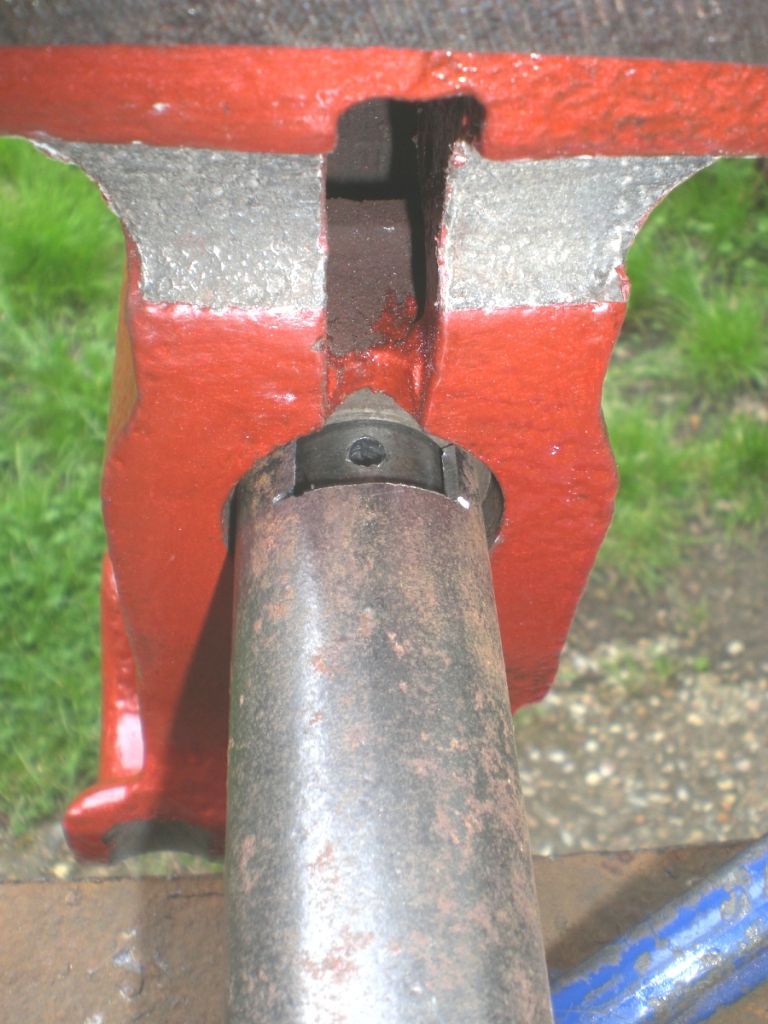

                                The small dot punch on the pin, shows the position it had to go into the hole.
                                Just got to paint the base that the vice swivels on, and the job will be done.
                                Regards Nick.

                                  Nice work, Nick!
                                  Useful things these scissor jacks!

                                              Hi Howard, thanks, yes that scissor jack has done many jobs besides jacking up cars, it's a nice size one and quite a strong one, and it was with a second hand Bedford HA van that was just three years old when I bought it in 1975.

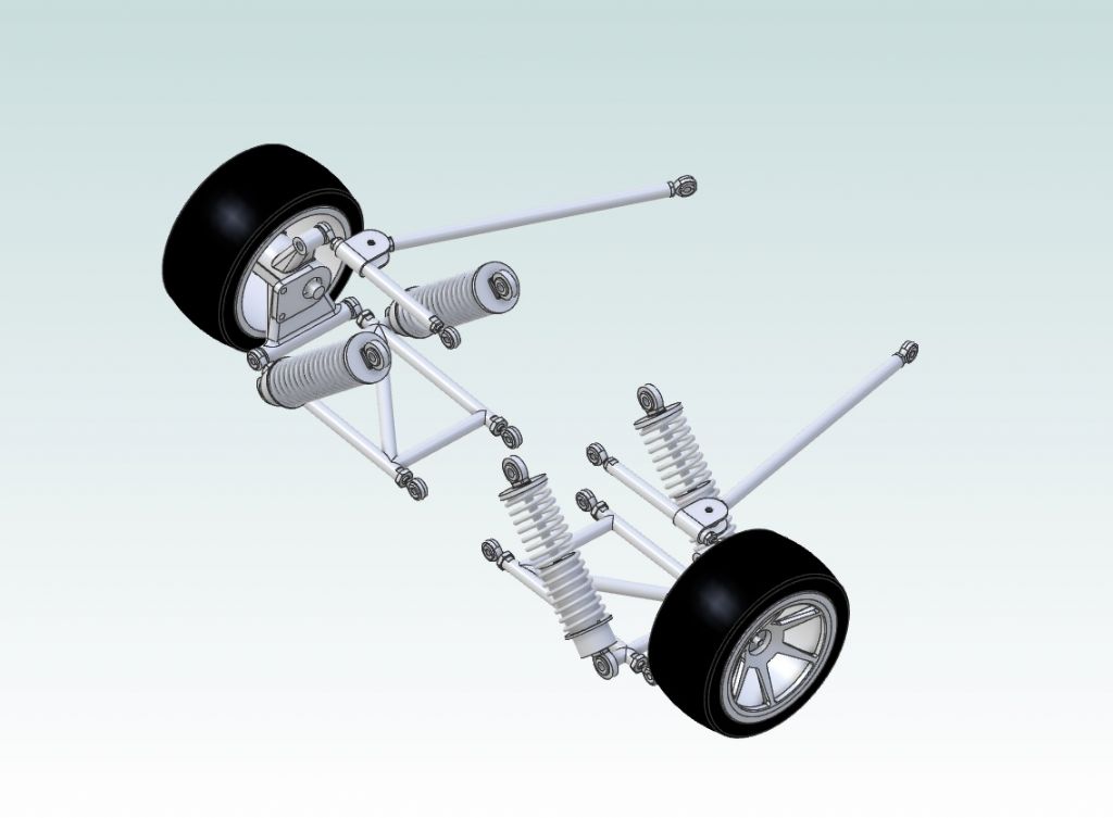

                                                    Spurred on by the "Alibre – A first attempt thread", I have over the last day or two carried on with the CAD exercise that I set myself to model the suspension of a mythical sports/racing that only exists (and only will ever exist) in my mind's eye. Plans are afoot to tackle the front suspension, too, but I think I will have to reduce the width of the front wheels to make it "look" right.
                                                    I modelled the left hand rear corner first and then altered the upright for application to the right hand side, before assembling both corners and then amalgamating both into one straggly assembly. I have yet to determine the exact positions of the chassis mounting points.
                                                    Here's the picture so far:
                                                    Both rear suspensions
                                                    Fasteners not included.

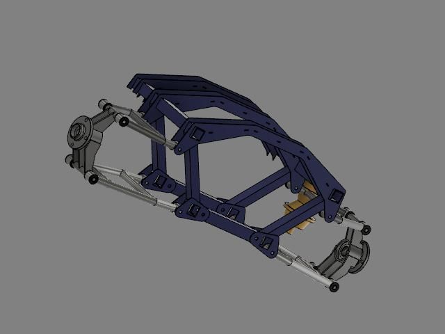

                                                      John, here's my virtual mock up of a hotrod IRS using MGF hubs, brakes and wheel bearings. The flat components are to be laser cut to save time and effort and make better parts
                                                      The rest of the frame, using MGF front uprights and geometry
                                                      I do intend to build this at some point. It's a mock-up because various parts need to defined better. And the IRS has several degrees of camber gain, which need to be designed out…
