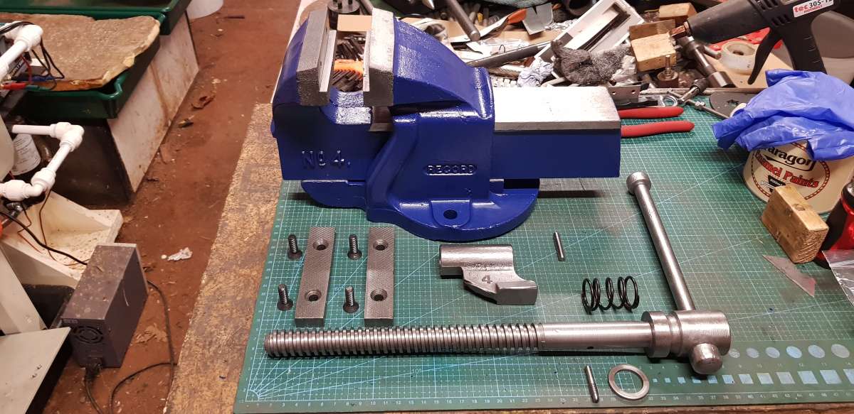

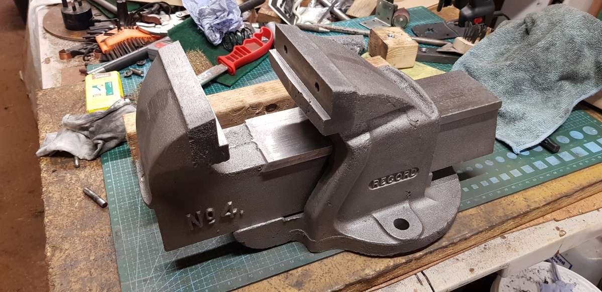

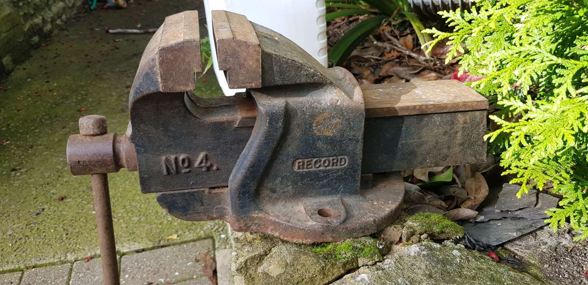

      Just finished cleaning up a Record No. 4 I acquired recently.
      20231028_120047
      20231112_115340
      20231117_092511
      20231118_150407

        Nice job Andrew, helped it would seem by being in very good condition to begin with

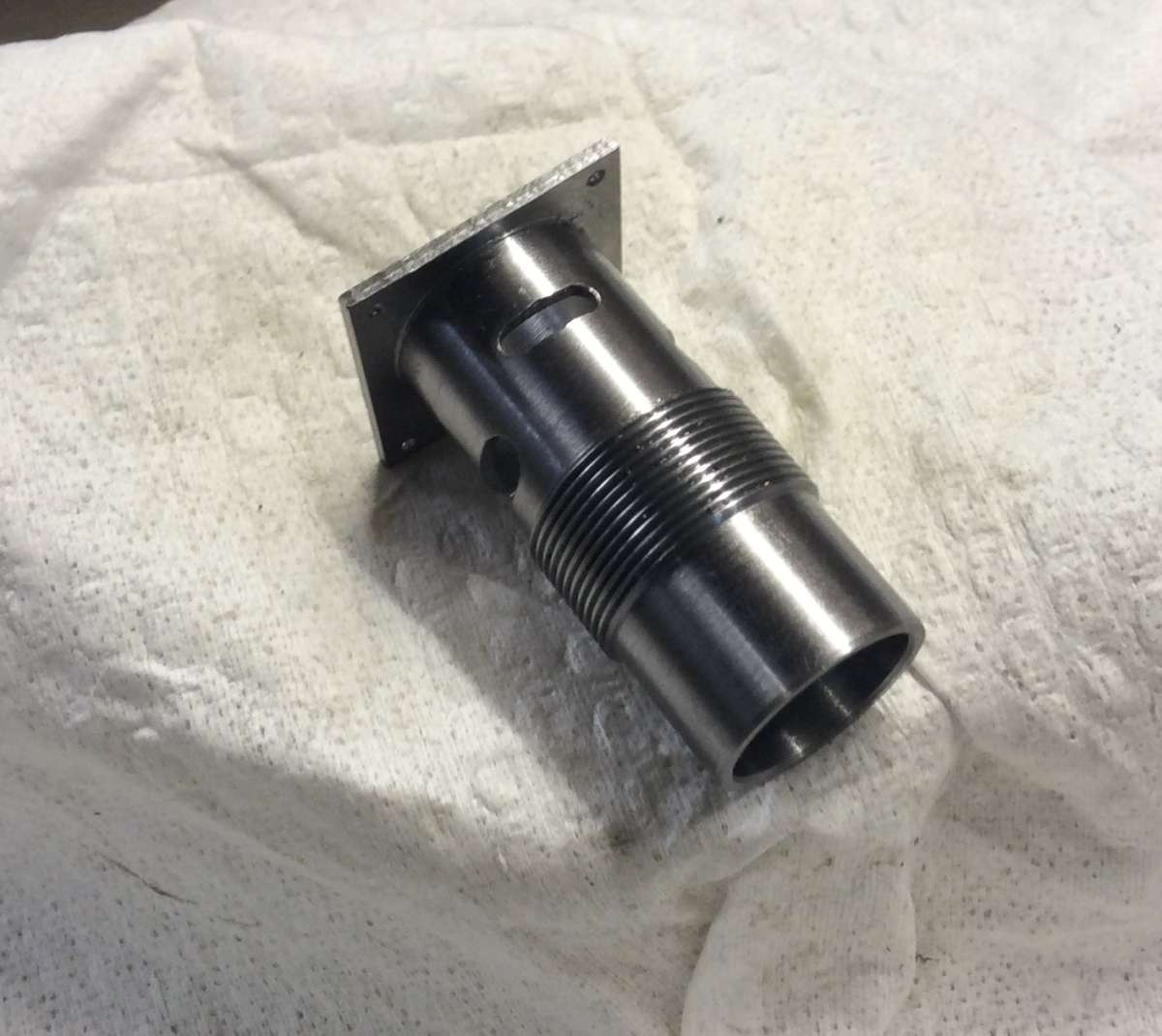

          after a few hours in the workshop over the last few days, its a Sparey diesel cylinder.IMG_3261

            Nice Work Bernard, I thought you only made tools.  You will be building a loco next!

              Sad to say Brian there is a 3/4 built gauge 1 in the workshop somewhere!

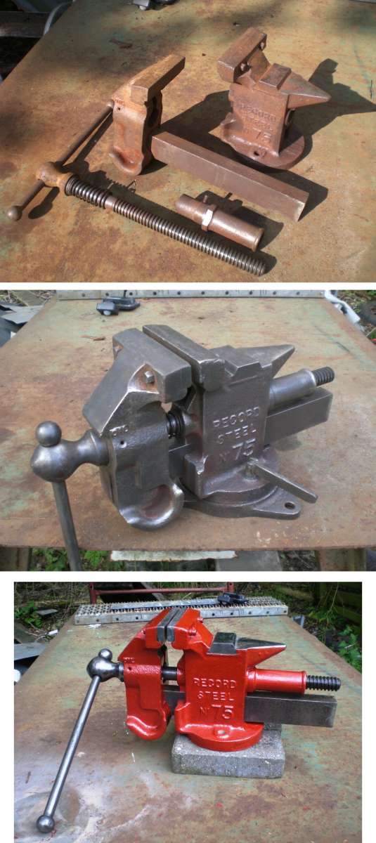

                Hi AdrewD, it’s so satisfying when you refurbish old tools to somewhere near their original state, and your vice looks really good.
                Here’s a Record No. 75 I did earlier this year.
                VICE75#A
                Regards Nick.

                  Excellent.
                  It tells a lot about a man/workshop when you see something like that stuck to a bench.

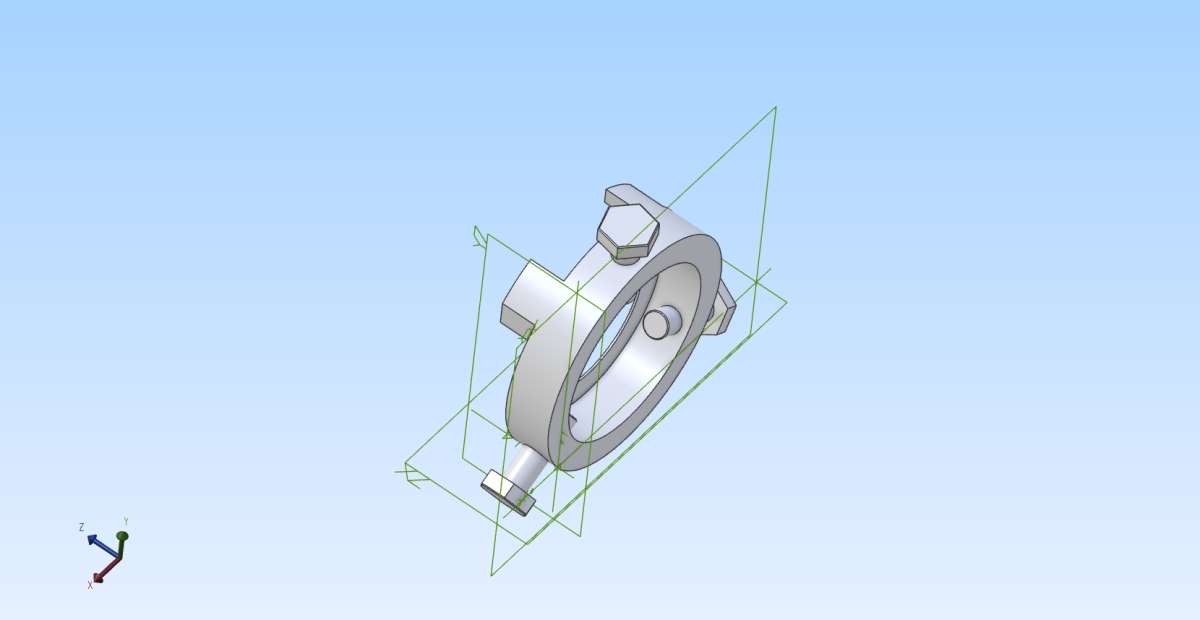

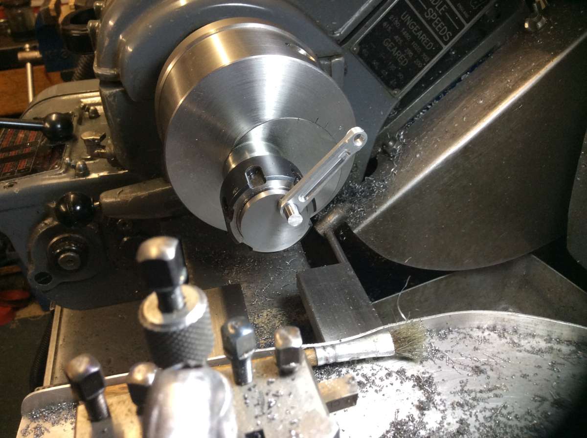

                          Completed a bell-type lathe drive dog.
                          It’s designed to be used with a temporary soft centre – a point on the end of a piece of ordinary m.s. bar held in the 3-jaw chuck, so that one of the jaws drives the dog.
                          Hemingway intend you use a temporary centre with their between-centres boring-bars kit, which I made. I am not sure it gives any advantage over using a normal headstock centre.
                          Though this was initially for turning my steam-wagon connecting-rods, whenever I make a jig or fixture I try to think of possible future work similar but not necessarily identical.
                          Then drew it as a CAD exercise! (I didn’t try to represent the screw threads…)
                          Outer diameter about 2.3″ ; central bore 1.2″ ; the two lugs about 3/8″ high. The three screws are 1/4″ X 3/4″ . A thin wall gives stiffness and if all is set up on a large diameter bar with the lathe centres on axis, it may be trapped between the work end and the jaw faces.
                          The overall diameter and thickness (~ 1/2″ body, lugs about 3/8″ high) was set partly by the oddment of bar I used!
                          The gap between the lugs is generously Harrison chuck-jaw width but I envisage using it on the Myford lathe just as easily.
                          The connecting-rods have long, slender shanks tapering from about 3/4 down to 1/2″ diameter over about 5″ , so I used the set-over tailstock method, and on the Harrison lathe. I may be wrong but I am not sure how the set-up behaves: does it try to oscillate the dog as the chuck rotates? I noticed a curious pattern develop on one rod – subject of a separate question.

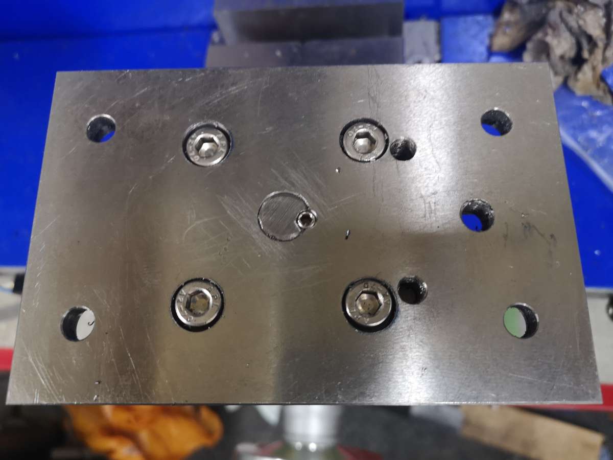

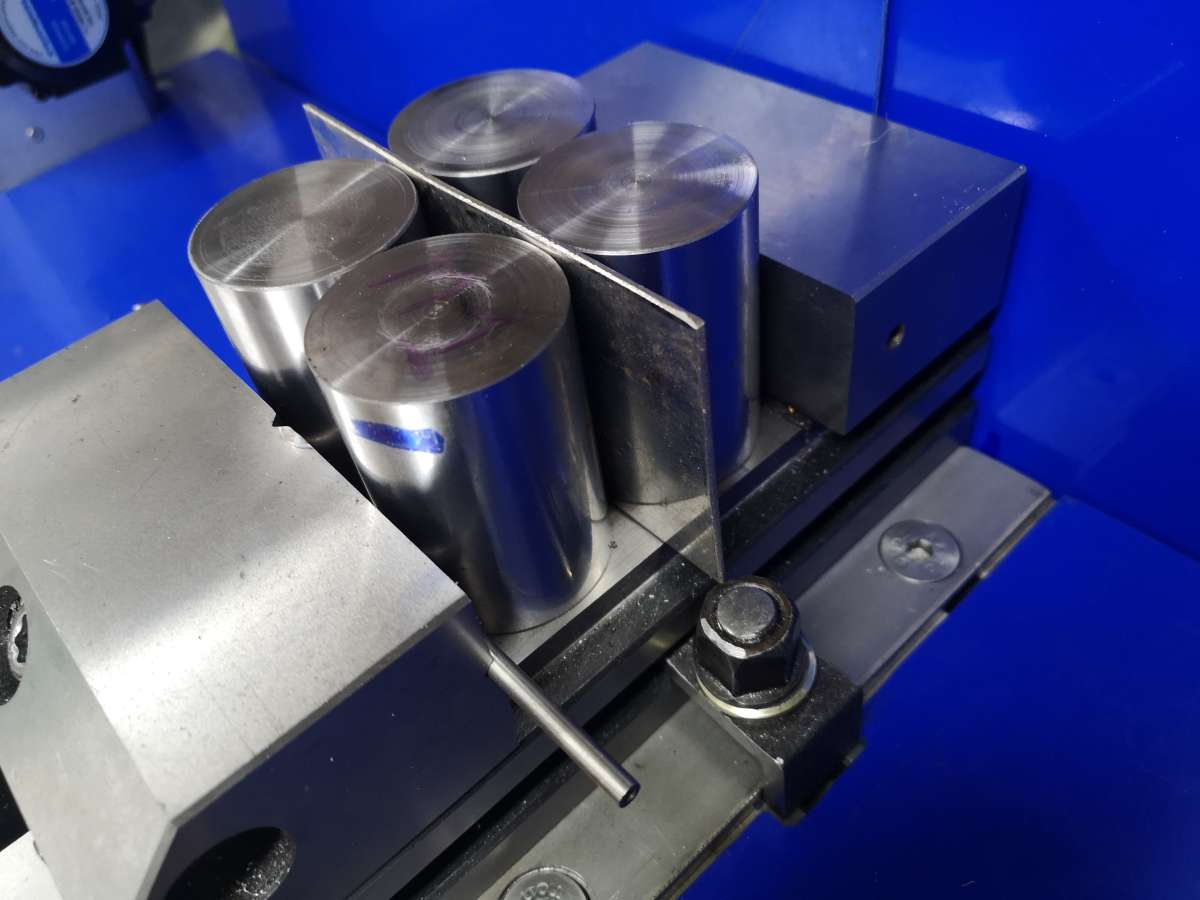

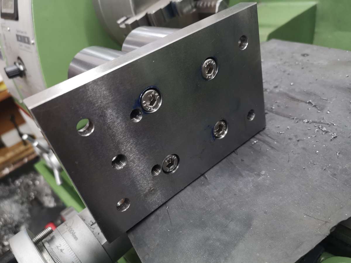

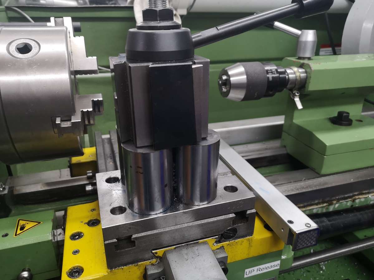

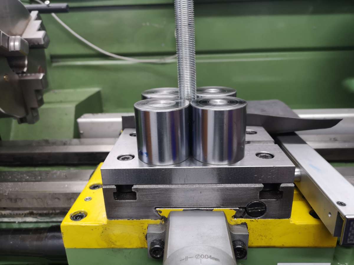

                            I decided that since, on its fifth anniversary, I had only cut a taper twice on my Warco WM290 lathe, I would sacrifice the compound slide’s “usefulness” in favour of more rigid turning and parting. So I started searching online for a 4″/100mm square block of solid steel 65mm thick and was amazed to discover it would cost me anything from £75 to almost £200 depending on the size of the selling company. I really didn’t want to make up a steel sandwich from bench blocks which may have been a wee bit cheaper.
                            Then I started sniffing around my junk pile for alternatives and discovered a 45mm diameter 3 feet long chrome plated steel roller from a scrapped machine in an old pal’s factory, long since gone. I do like unique-ing stuff.
                            My trusty Makita cold saw managed to whip four 65mm slices off this thing which has a rock-hard outer shell that stays that way for the first 8 or 10mm before softening slightly towards its centre. It really did give my carbide tips a workout and later destroyed my HSS fly cutter. Oh, and when will I learn to wear ear protectors?
                            IMG_20231214_124517
                            Anyway, I drilled a few holes, tapped a few more and got my four pillars mounted on the original 150x100x15mm rear tool post mounting plate that came with the lathe. I marked and drilled a hole between them for the 5/8″ UNF toolpost clamp bolt and tapped that, but not before it chewed up my taper tap. Plug tap finished it nicely though, but very slowly. The 5/8” threaded rod took some online trawling to find at reasonable cost.
                            IMG_20231216_170200
                            I sank the pillars’ allen bolt heads into the bottom of the base plate and screwed in the QCTP clamping bolt flush with the underside before up-ending it on the mill and drilling/tapping a hole for a 6mm grub screw to lock the bolt in securely.
                            IMG_20231220_113652
                            I also stuck a 16mm thrust washer under the top nut to make clamping a little easier and it all looked like it might work, fingers crossed!
                            IMG_20231220_114105
                            Measure twice, cut o…
                            Oh-oh, ’twas only then I discovered a BAD THING. I had failed to take account of the base plate depth, as I had originally planned to mount the pillars directly onto the cross slide, but then decided that would run me into next summer. On assembly, the lowest I could get the tool tips was about 4mm above centre height, that’s when I twigged!
                            So after refreshing some carbide I lopped 15mm off each of the pillars, this time with my ears covered, and did a quick assembly check before removing the pillar bolts and applying Loctite 243 to the threads. Result – smaller, neater, faster than a speeding bullet.
                            IMG_20231221_150258
                            Now for the test run, sparks will fly.
                            Please ignore the fact that I immediately snapped my favourite parting blade, fools rush in, too fast too furious etc.. However, facing and turning are greatly improved, so much that even a heathen like me can tell the difference.
                            Merry Christmas everyone, and thank you to all who have offered advice since I joined up.
                            ***Comments welcome, or “what HAVE you done?”  🙂

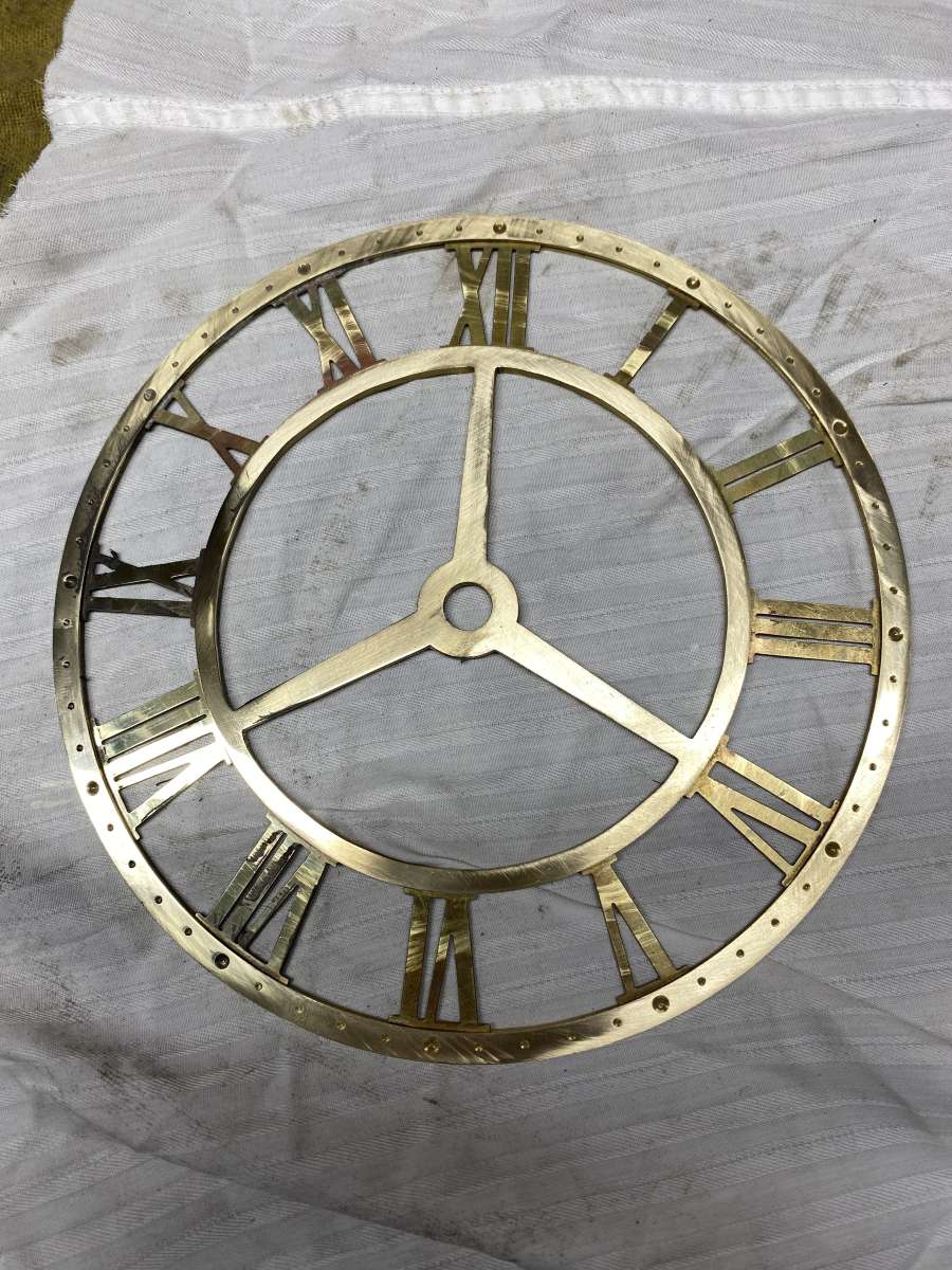

                              IMG_0452
                              Finished the dial for the epicyclic clock, just needs a polish.

                                That looks nice David is going to be slivered or just polished?

                                  Thank you Bernard and thank you for the thought too, I hadn’t thought of silvering.

                                    Terry – I had no idea what you were up to at first. I get it now.
                                    I was thinking of making a parting tool holder to fit directly to the cross-side when I realised the cost for lumps of metal – seems it’s well worth the effort.
                                    Also, what is the practice of using a round bar for clamping work in the vice called?

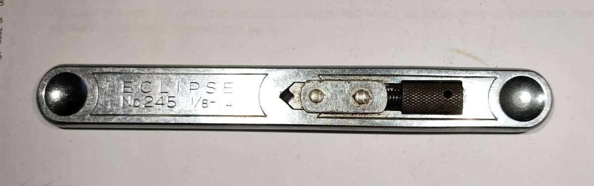

                                        Chrstmas visit to The Tool Shop, Wallington. Got this lovely thing for less than £5

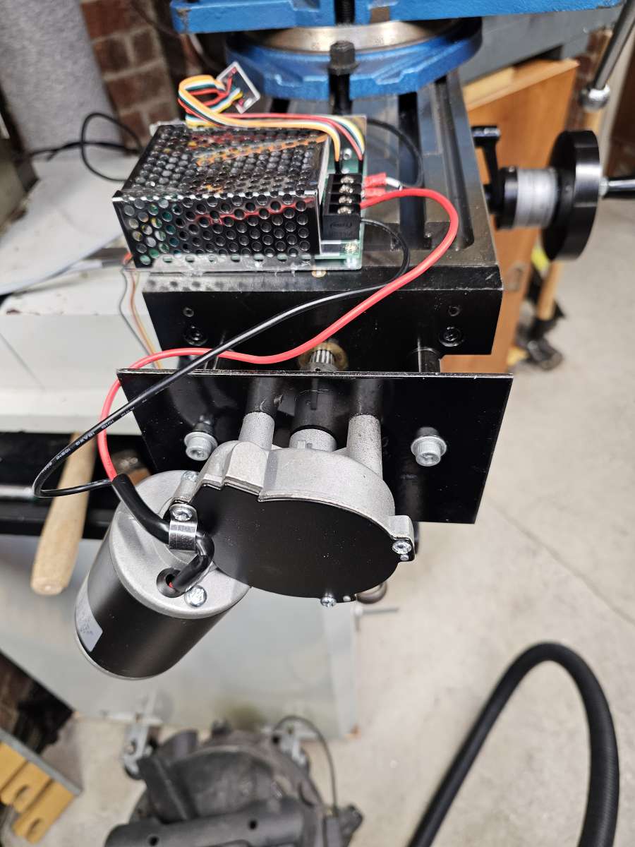

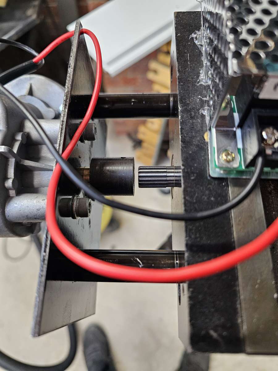

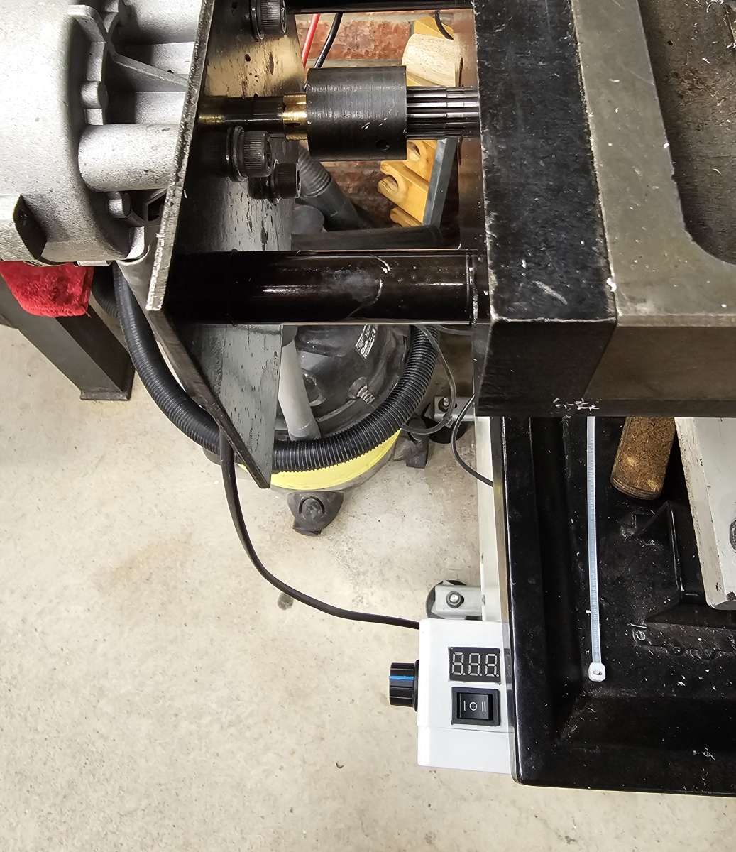

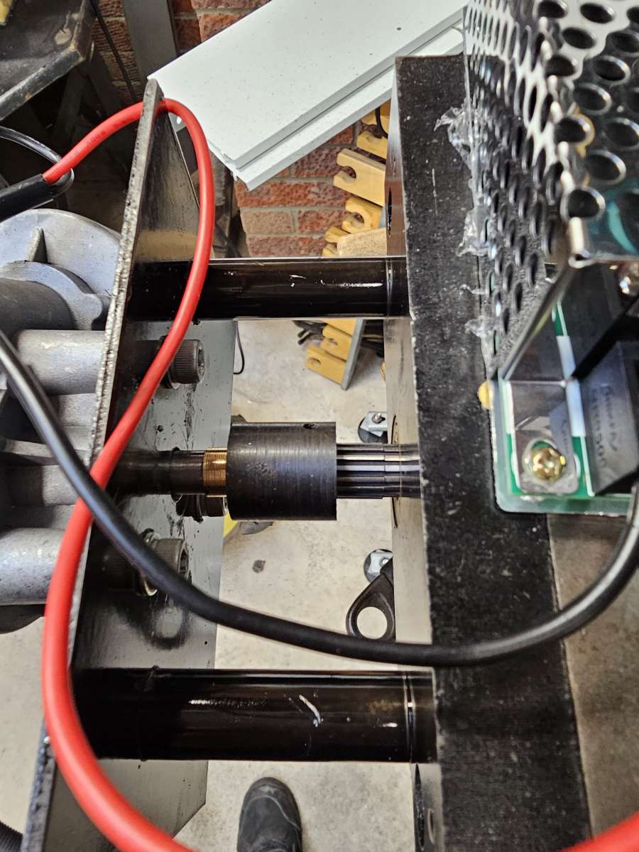

                                          Just finished the motor drive for my sx3 mill.
                                          Here is the lash-up to test
                                          20231217_133555
                                          The drive coupling engaged /disengaged
                                          20231217_13374020231217_133756
                                          The finished job showing the direction switch and speed readout (in %. 100% =~ 400mm/min) and the potentiometer for adjusting the speed20231221_135826

                                            Hiya Danni. Yes indeed raw metal is very expensive now.
                                            For anyone as scared of parting off as me I think a rear mounted tool is safer, or really take your time and keep it lubed. But I am the opposite of “expert” 🙂
                                            As far as the round bar thing goes I don’t know if it’s a named procedure, I picked it up from Blondihacks on YouTube and have seen it used elsewhere too. She is extremely well clued up and reckons it stops the back vise jaw pushing the workpiece high when you tighten it hard. I think I have that right, was some time ago!
