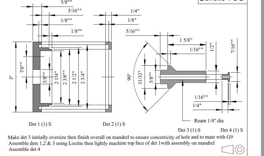

                      This is how the rotaing base is fabricated for the Bonelle T & C grinder
                      Ian

                          When I made mine (From the Book) I did it in two parts similar to that shown by Ian J. I have not had chance to refer to the book before writing this but could it be that the design in the book is the modified version. The only other change I can remember is the variation on the stops around the perimeter where instead of T slots there are a series of tapped holes. The stops themselves are made with adjustment slots to cover the range between the tapped holes.
                          regards Martin
