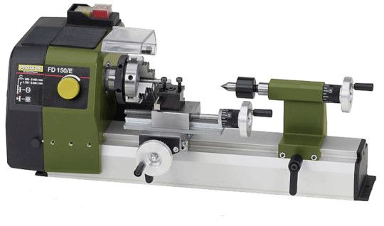

      HI I am new to this forum but it looks like it will be fun and helpful
      I have just got a Proxxon lathe FD150E lathe.
      But when I press the on button the chuck starts to turn quite fast
      even when the rotary control is in off position should it do this.
      Can anyone tel me the value of the rotary control so my friend can make some changes to make it stop or slow down a lot.

            I too don't know the lathe from direct experience, but the Axminster website quotes the speed range as 500-5000 rpm.
            500 rpm is "quite fast" in lathe terms and will appear so to the eye. Having said that, modification to the control circuit by a knowledgable person might be possible for a fairly small reduction. Or perhaps different pulleys if you really need a lower speed.

              Not familiar with this tiny lathe but the advertising suggests that the speed range is from 800 to 5000rpm. It is quite usual for variable speed controllers not to go to zero, my WM250 does not stop if the speed control is right down. It would seem likely that this is the case with your Proxxon. There might be some additional trim-pots on the speed control board to set upper and lower limits. Suggest contacting Proxxon for details.

                  The control doesn't appear to have an "off" setting, in fact no clue as to speed at all:
                  The label for the pulley change, just to the left of the speed control does however say:-
                  • range 1      800 – 2400
                  • range 2    1700 – 5000
                  Which might be a bit of a giveaway! Neat little lathe though.

                      Could be an example of the wrong tool for the job I'm afraid. High-speed as provided by the Proxxon is just what's needed for turning small metal objects, whereas coil winding is a slow process. Running an electronically controlled motor at below design speed risks overheating whilst not producing enough torque to wind the coil. Better to gear the motor down, perhaps with belts and pulleys rather than toothed gears. How practical that is depends on how the Proxxon is built: can you take the end off the headstock and photograph the two-speed gearbox inside?
                      I've used a mini-lathe (min 150rpm) to wind bobbins, not comfortably because 150rpm is still too fast, making it hard to control. Starting and stopping is particularly tricky, because the lathe controls are designed to set speeds rather than vary them continually, while tension control is awkward.

                        You could buy a small planetary gearbox with a ratio to suit your needs. Make a suitable jig to hold it on the lathe bed and work towards the tailstock end. Just need some way to hold the workpiece in the gearbox output.
