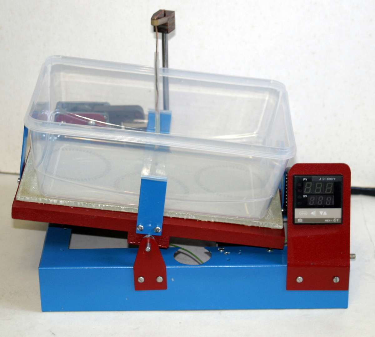

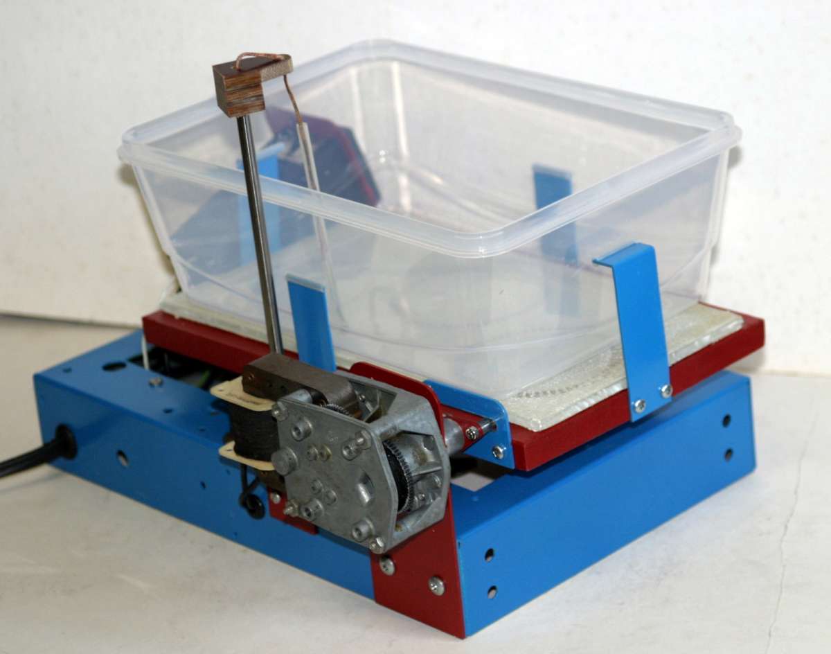

      While not exactly model engineering, I cobbled this together after getting tired of standing rocking a tray of etchant while making PC boards. I had, many years ago, made a hot plate to heat the etchant using a surplus glass heating plate from an old photo copier and a light dimmer to control it. While it worked it was finicky to get the temperature anywhere near constant and I still had to manually agitate the etchant tray .
      I used the original hot plate unit but replaced the light dimmer with a PID controller/ “J” thermocouple that I had been given and added a old rotisserie motor from our 40 year old kitchen stove that had given up the ghost ( never did use the rotisserie function!). The motor rocks the tray back and forth on a 6 second cycle. The rest was just bits and pieces I had in stock. The only thing bought was the plastic tray from a “dollar store”.
      The gaudy colour scheme is only because I had two almost empty spray cans of paint, neither of which I thought would complete the job!
      JohnEtchant Rocker 1
