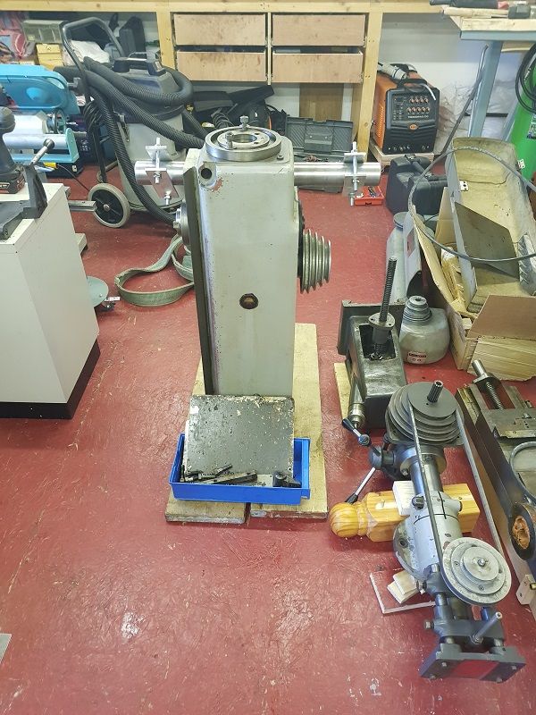

        Right, after much thinking time I decided I couldn't do without a quill on a new mill so I went for the Elliot Omnimill 00. The machine arrived this afternoon and has been stripped in to its main parts with most of it in my workshop except for the base. I`m going to power wash it first. Electrics have been removed as they are going to be fully replaced. This looks like a pretty good bit of kit and I`m looking forward to getting it running.

          I had one of those. Very versatile machine and ideal for home use. Let’s see some more pictures when it’s up and running.

            They look like really good home machines, I second that I'd like to see more of it as it progresses, the top left of the casting in the first picture, is that damage, a hole? or are my eyes deceiving me?

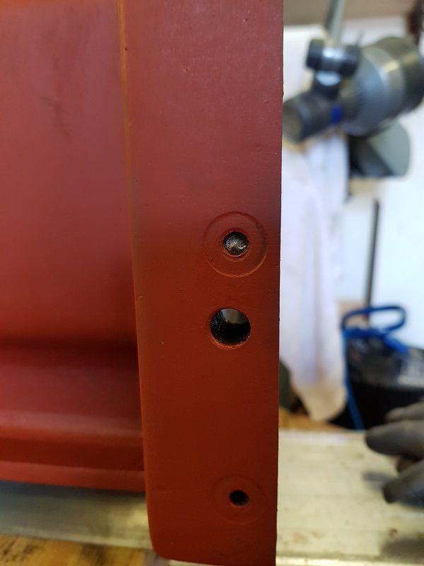

              Peter, the hole in the casting is meant to be there. Not sure whats its for yet though.
              #407668
              Pete.
                @pete-2
                Posted by Ian McVickers on 03/05/2019 21:50:11:
                Well that's good then, what are your plans? are you repainting it?
                      Think its for the overarm locking widget.

                            Clive, thanks the hole is indeed for the locking clamp. I will need to make one of those.

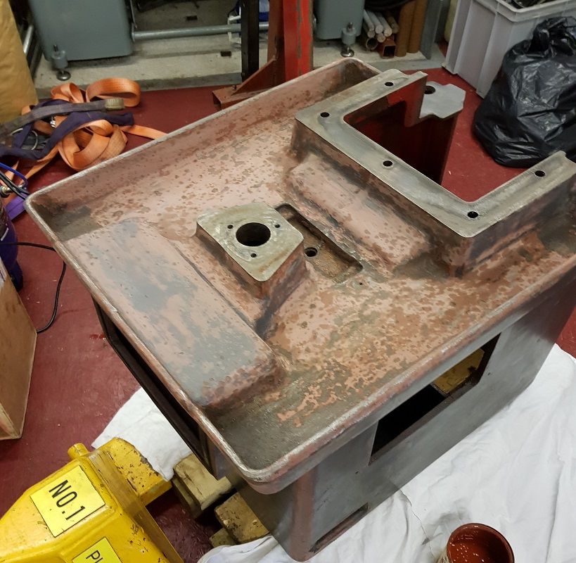

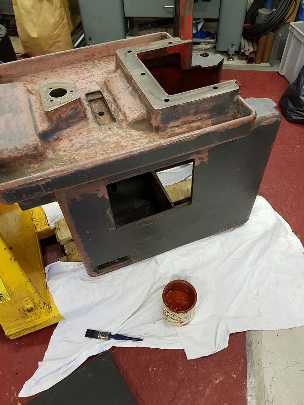

                            Base for the machine was power washed, done over with a cup wheel in my grinder and cleaned down with degreaser. Base coat of red oxide has been applied.

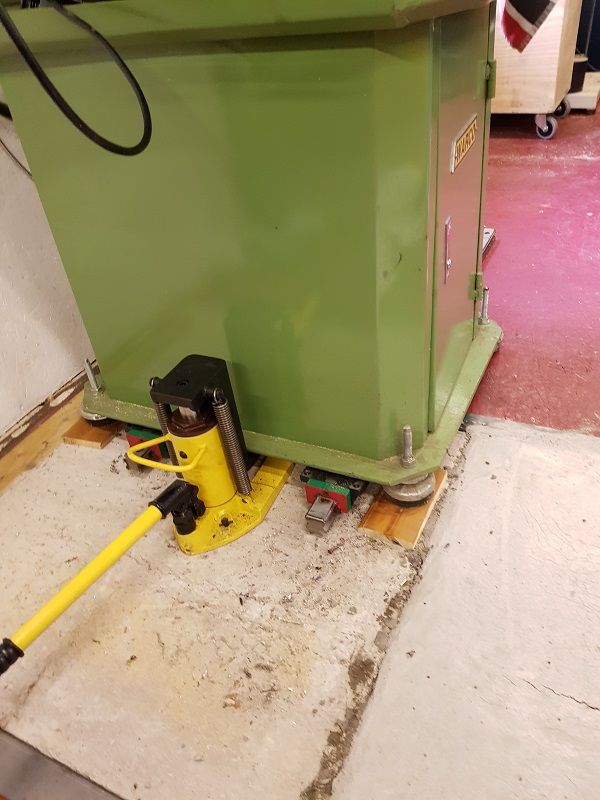

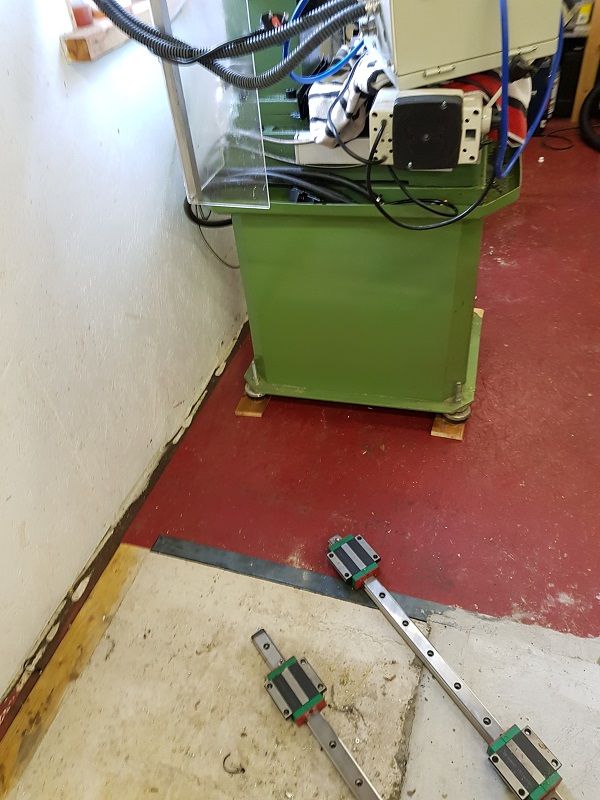

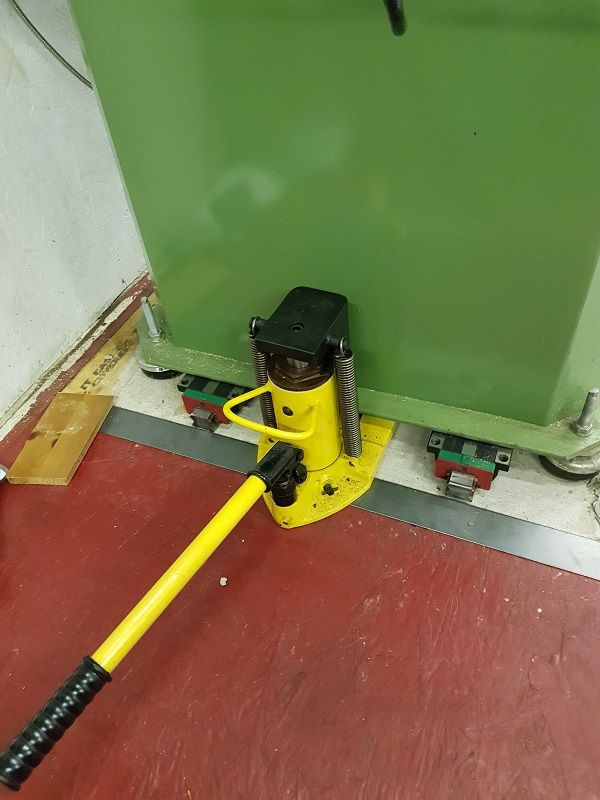

                                    Busy day in the workshop today. Warco mill moved off the concrete block. I thought this was going to be difficult but had an idea to use some large linear rail and bearings that's been lying around for ages. One of the things that you never really need but don't want to throw away.warco mill move 1.jpg
                                    So lifted the mill with my toe jack and set the rails and bearings, lowered the mill and a gentle push moved it along. Repeat 3 times and the mill is in its temporary home till it gets sold.

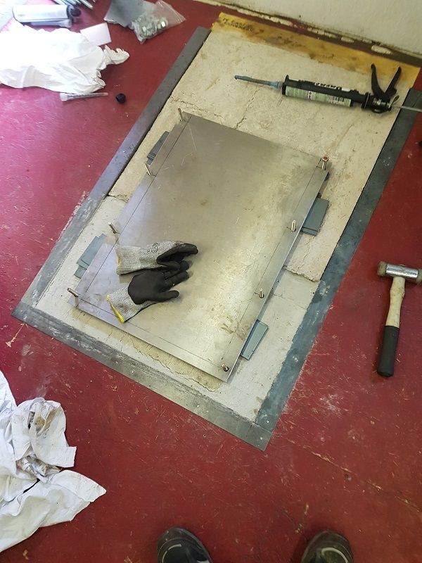

                                    Aluminium base plate cut to size and resin secured bolts fitted in the block, packers fitted and plate levelled.

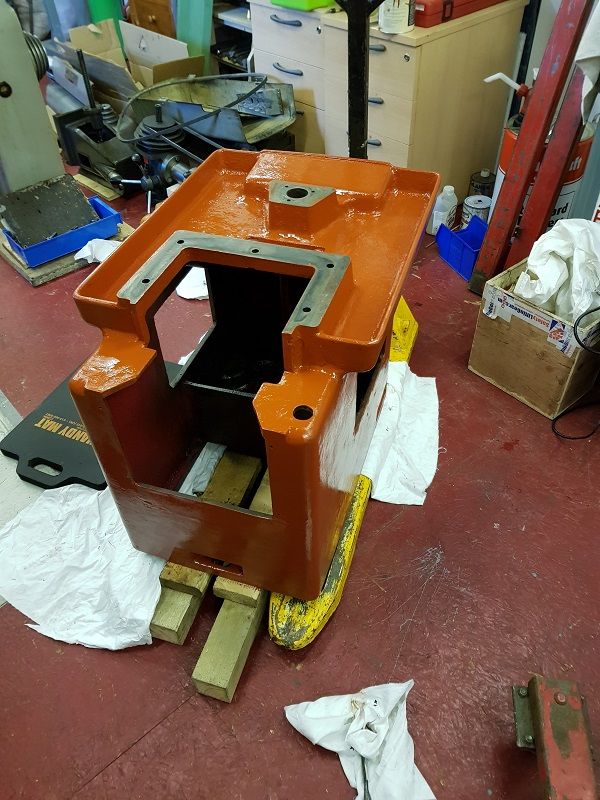

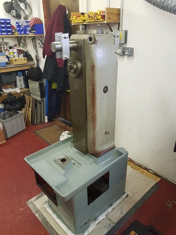

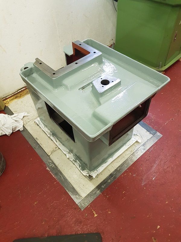

                                    Omnimill base in position and painted. Had to make some 40mm diameter 6mm thick washers for securing the base to the plate.
                                    Column fitted to the base.
                                    Hopefully tomorrow I can get the column rubbed down and base coated. I don't have enough top coat so will need to order more and also need to wait till Tuesday to order the resin grout for finishing off the base. I would like to get the overarm back in position as well to look at what motor sizes I can get in.

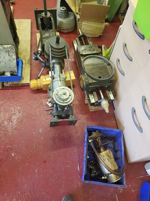

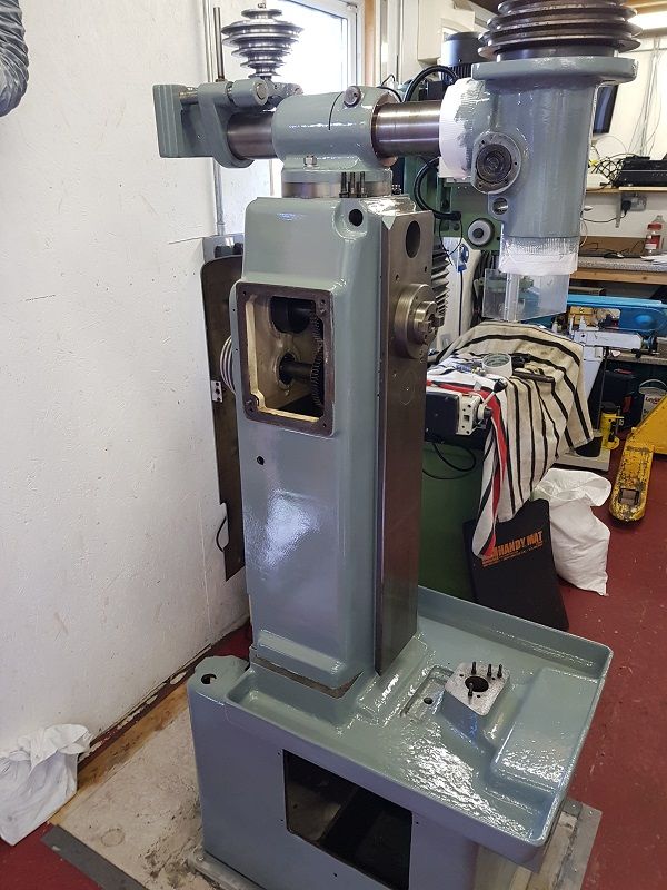

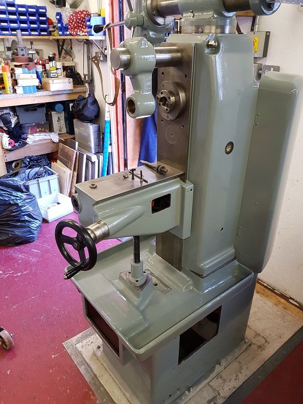

                                        Managed to get some more cleaning and painting done.
                                        Snapped grub screw in the knee gib adjuster but thankfully it wasn't stripped or jammed so came out easily with a small point punch.
                                        Also managed to clean up the aluminium pulleys but found a crack in one and had to remove a small part of the pulley but I don't think it will cause any issues.

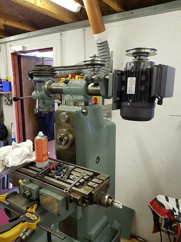

                                        Ive decided not to go with inverter drives for the horizontal or vertical so both motors have been ordered and should arrive mid week. I have a 400 Watt servo and amplifier so Im thinking about using it for the table drive. Still cant find any info on the net about the original drive motor fitted to it.

                                          Ian, that's coming along nicely, could a I ask you what method you use to clean up non painted cast surfaces like the gibs and the entire front section?
                                          #408868
                                          Ian McVickers
                                            @ianmcvickers56553
                                            Peter,
                                            I gave them a clean down with grease cleaning wipes. Any remaining stubborn bits got a gentle rub down with wd 40 soaked scotch bright pads.
                                            #408869
                                            Pete.
                                              @pete-2
                                              I to used some fine scotchbrite, but with Jizer, but it's nice to know what methods others use, looks good, looking forward to seeing it progress further.

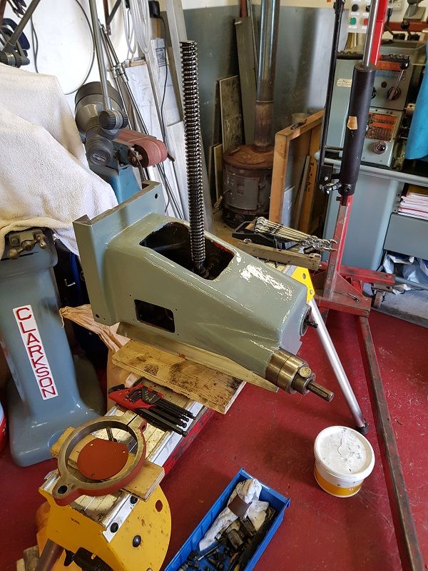

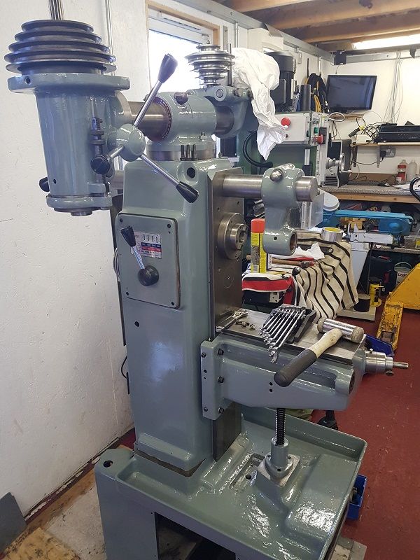

                                                    Knee refitted today but I need to get another screw to replace the snapped one so that's tomorrows job. Also found the over arm support lock in the box of bits.
                                                    The rest of the parts on the head have been painted and fitted as well. Gear box cover replaced and oil changed.
                                                    Started cleaning up the table now.

                                                      Table has been put back on the knee but gibs are not fitted yet. There is quite a bit of backlash in the long travel screw but that will be a job for later. Both vertical and horizontal motors have arrived. Vertical motor has been fitted via an adapter plate to measure the length of drive belt I need then removed to get the adapter plate painted. The new motors have 24mm diameter shafts and I have bored out the vertical one to fit the shaft but I don't have an 8mm keyway breach so thinking about making a boring bar type one and either cutting the keyway on the lathe or on the mill.
