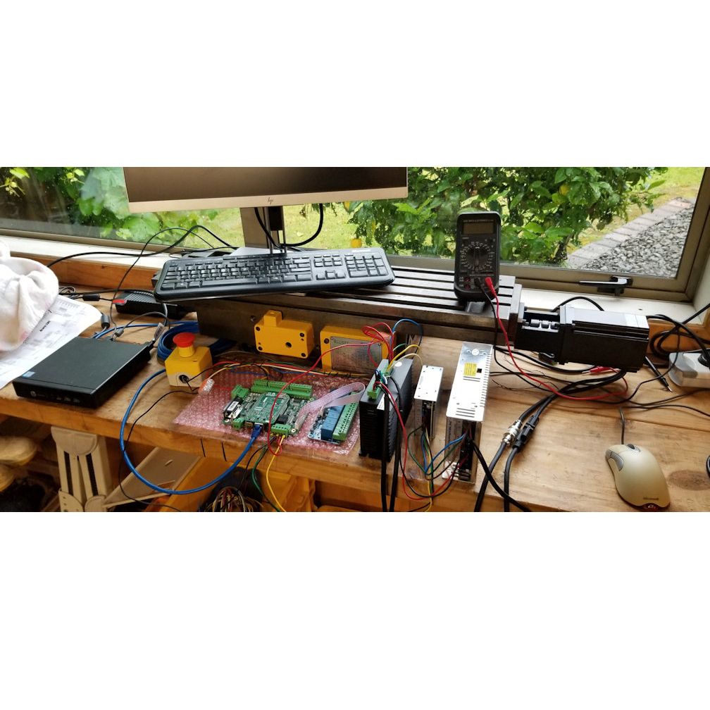

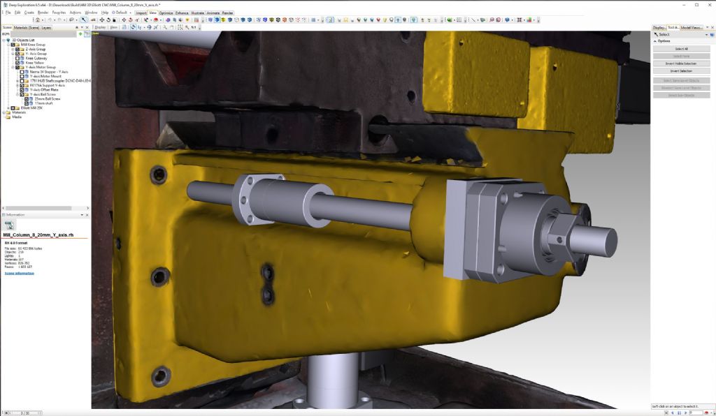

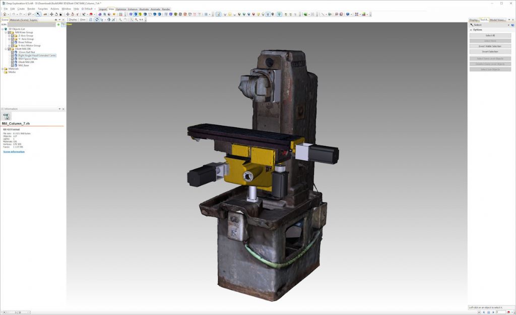

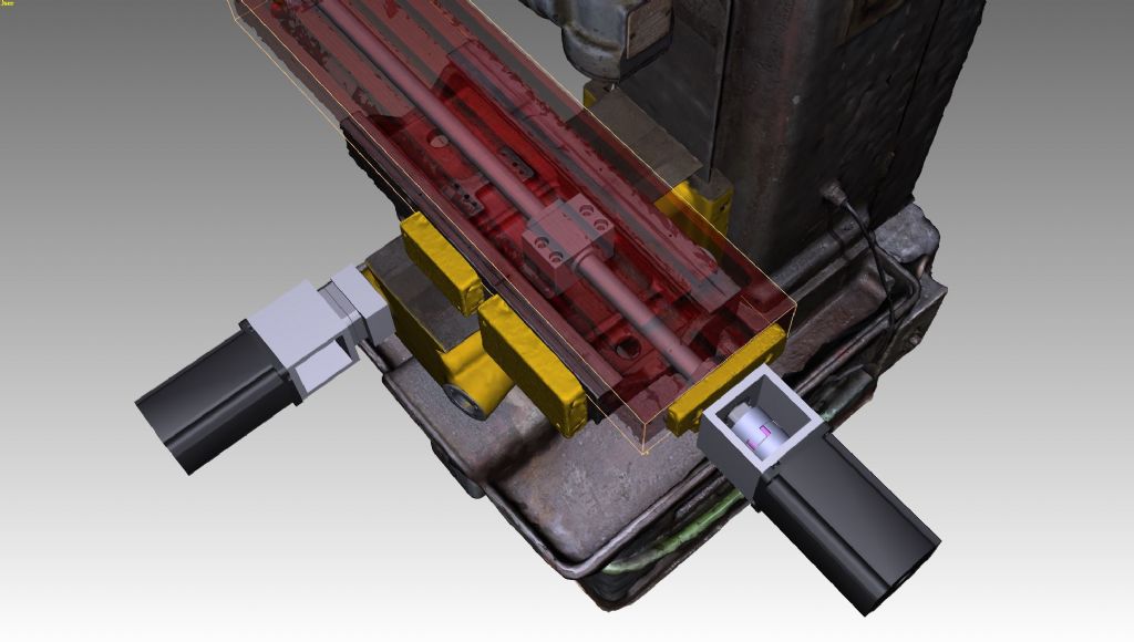

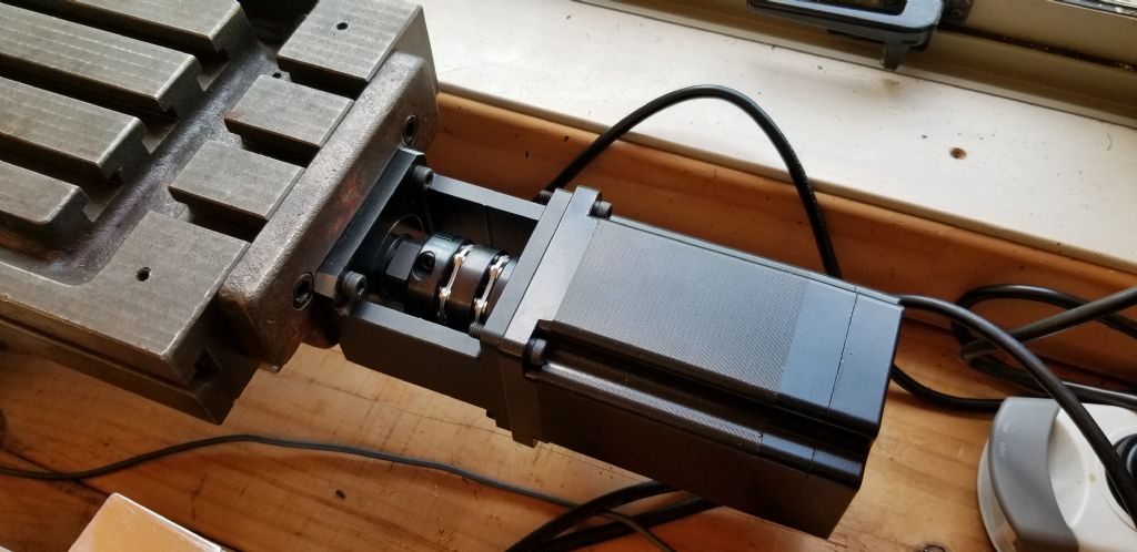

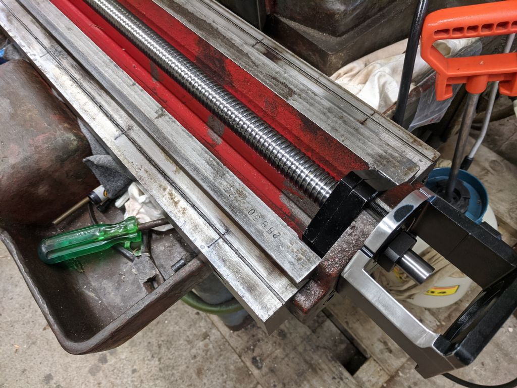

                  Hi Ian, just discovered your posts on the refurbishment of your Elliott Omnimill, spectacular job.
                  I picked up an Elliott 181 in need of restoration about a year ago and it is going through a full CNC conversion at the moment. I was lucky enough to pick this up with the "double swivel" vertical head.
                  Ball-screws on all axes and stepper motors on all drives. Feed motor can now be deleted completely.
                  Control system is a Centroid Acorn.
                  Standard motor on this was a 1.5HP, 3Ph (460V). This will be replaced with a 1.5kW-3ph (220V) so I can run off a single phase supply with an inverter.
                  To make sure everything was going to fit I scanned (Photogrammetry) the whole mill into my computer and could then "trial" fit everything virtually.
                  Its still a while away from being finished but felt very inspired by your restoration and now will have to up my game wink

                    Nice one Dean. Keep us upto date with the rebuild, I would really like to see this one running. I going to change my table acme to a ballscrew. Ballscrew has arrived but havent had a chance to anywhere near it yet.

                      I'm very impressed with your photogrammetry, I've had only limited success with geometric objects (as opposed to, say, statues). Would you be able to tell us what software and scanner/camera you used?
                      Adrian
                      #582546
                      Dean Anderton-Gough
                        @deananderton-gough95897
                        Hi Adrian, thanks for your kind words.
                        The software I used was 3DF Zephyr, see link below…
                        https://www.3dflow.net/3df-zephyr-photogrammetry-software/
                        There is totally free version of it that allows you to use up to 50 photos to build your model. Great for experimenting with and you can still export an object with it. I bought the Lite version as it allowed me to use up to 500 photos.
                        More photos = better accuracy but I've gad some great results with 50. Zephyr have a bunch of excellent tutorials on YouTube as well which really helped.
                        The camera I used was just the one on my phone, a 5 year old Google Pixel XL. A better camera and consistent lighting would have made the results even better. Good enough for my purpose however.
                        cheers, Dean

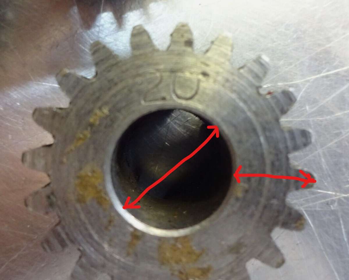

                                My Omnimill 00 is missing the 16T table feed gear. If anyone happens to be near their mill with a caliper in their hands.. (come on, it could happen!) could you please measure the bore and the distance from the bore wall and the top of a tooth or two?
                                I want to try my hand at making a gear, thanks for your help in advance.
                                Wade
                                Measure gear
                                #703774
                                Bazyle
                                  @bazyle
                                  Puzzled a to why you don’t calculate it from the DP. And surely the bore is the same on all the pick off gears? Or you could work it out from the centres distance and the size of the 48 gear.

                                    Well, I am in Brazil with work right at the moment, preparing to make the gear when i arrive home. Otherwise I would do as above.
