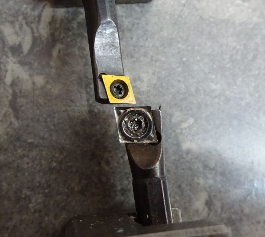

                                    #212661
                                      Kwil it was the ones at the bottom of the page I was refering to which have a "Mini CCMT" tip which would equate to about an 04 size rather than the more common 06 and 09 and as far as I know they only come in MT though with an almost non existant tip radius so don't get pushed away too much. If I remember I'll bring one along on teh 28th if you are going.
                                      EDIT
                                      Pic of the "miniture CCMT" against a 6mm shank holder with CCGT 0602 tip
                                      J
                                      Edited By JasonB on 16/11/2015 17:28:19

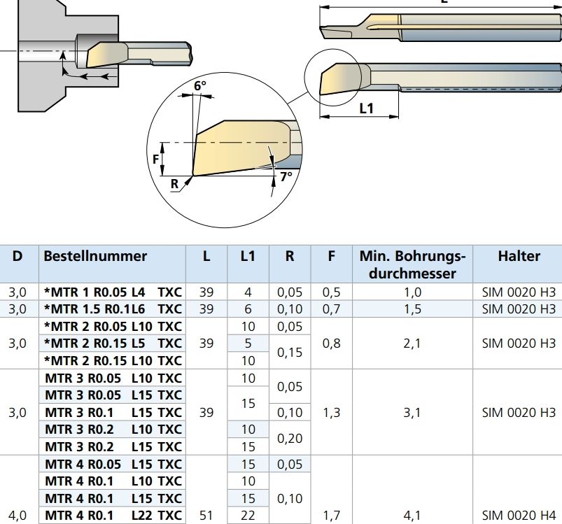

                                            Versaboss
                                              @versaboss
                                              Posted by Brian John on 16/11/2015 13:32:50:
                                              UPDATE : minimum hole is 9mm for the 6mm indexable. Does that mean it will fit in a drilled 8.9mm hole ? I really need to know what size holes I have to drill to take the tool.
                                              As you usually use a boring tool to make a hole bigger, I don't see what you mean with this question. Do you want to open 8.9 mm up to 8.95? For anything bigger your question makes no sense.
                                              Anyway, when you (or someone else) wants to bore really small holes, there are wonderful one-piece carbide tools around. Like these e.g.:
                                              Regards, HansR.
                                              Edit: this is just part of the catalogue, the diameters and lengths go up from this…
                                              Edited By Versaboss on 17/11/2015 10:40:40
