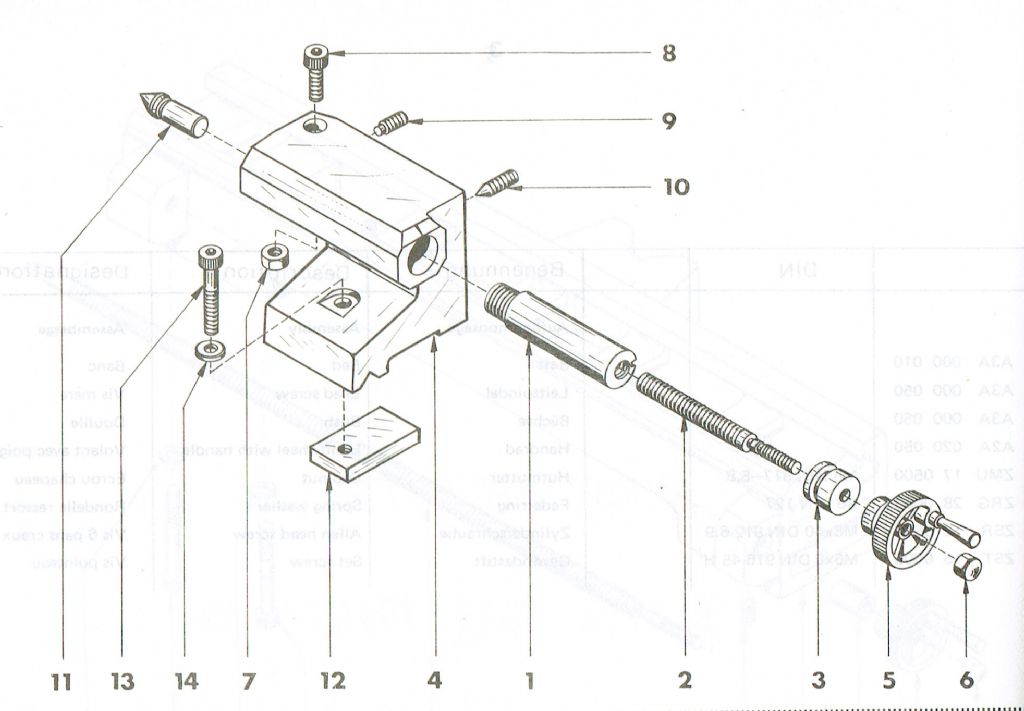

                                  Posted by JasonB on 26/03/2016 08:01:48:
                                  Funny enough I just looked at my Unimat 3 parts drawings and that uses exactly the same construction. Mine and many many more have given years of trouble free service so that can rule out feeble design.
                                  I havent looked at a Unimat in over 20 years, but a quick net search shows me only a much more substantial bushing than the Optimum. The Unimat bushing, show below, appears about three times longer than the Optimum, and has a positive locating hole drilled in it for the grubscrew to poke into. A much better set up than the Optimum's radial groove which I think was done that way because it is easier to make quickly. Simply turn the groove and part off. The Unimat style would need putting in a drill press to drill the hole, a second machining operation that would cost more money.
                                  The cheaper to make Optimum bushing has the nasty drawback of allowing the bushing to rotate in the housing and in the process get burred up by the pointed end of the grubscrew.
                                  The very nice looking Unimat tailstock bushing:
                                  #232024

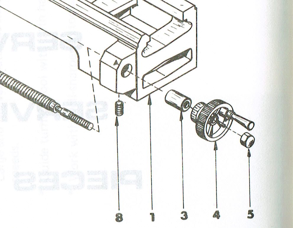

                                    I was going by my parts diagram as I've never had it apart to see whats inside, looks very similar to Brians and done far more work than his.
                                    Same with the leadscrew bush, I have had that out a I seem to remember that needs to be done when fitting the power feed.

                                          #232413
                                          Hopper
                                            @hopper
                                            Posted by JasonB on 28/03/2016 07:44:04:
                                            Judging/guessing from your parts diagram, I would say the Unimat bushing is three times the length of the Optimum's, making it sit squarely in the bore with out canting over and jamming. And the Unimat's grub screws for both the bushing and the quill anti-rotation guide are at least double the diameter and length of the Optimum. The Optimum has tiny little 3mm grub screws there (or maybe even 2mm?), whereas the Unimat appears to have grub screws the same size as the quill clamping bolt, ie 6mm.
                                            Likewise, the plate that goes under the bed to clamp the tailstock appears in the Unimat drawing to be three times thicker than the one on the Optimum, which was roughly press-cut from a piece of maybe 2mm flat steel, almost sheet steel but not quite, ie manages to fall just short of being totally useless.
                                            So same but different. Smaller size fittings all round. Thinner metal. Poorly finished. Cheap and nasty.
