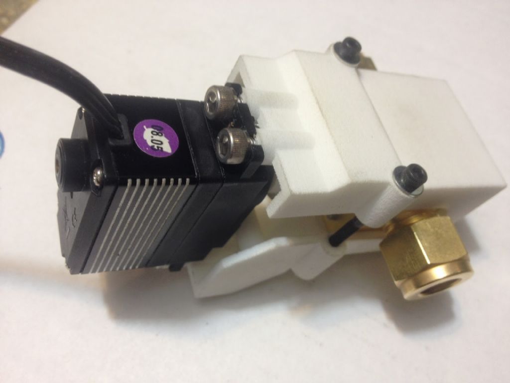

                                      #189391
                                      Carl Wilson 4
                                        @carlwilson4
                                        Just something to inspire you. Hitec metal geared servo driving 3/8 swagelok 1/4 turn valve mounted in a 3d printed frame. Not mine, sadly…built by Rocket moonlighting.

                                              Clive Foster
                                                @clivefoster55965
                                                Carl
                                                Thanks for that very inspirational picture. Close to one of the things I was considering. Nice to know that the concept works and can be done neatly.
