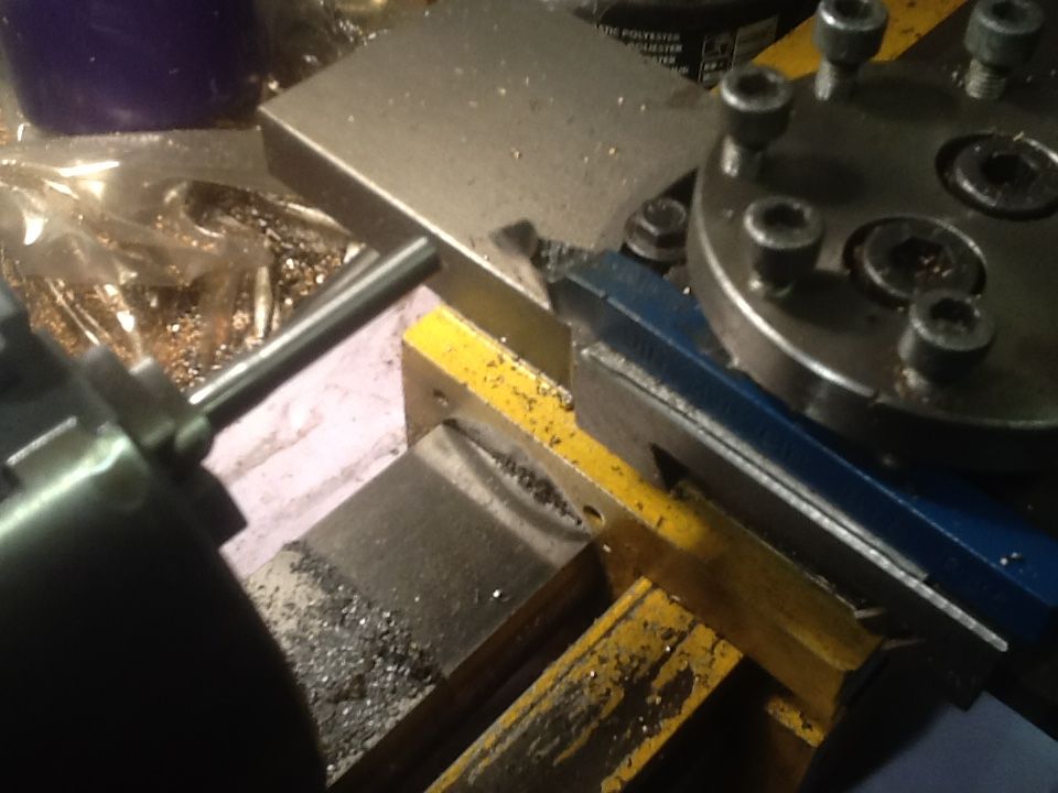

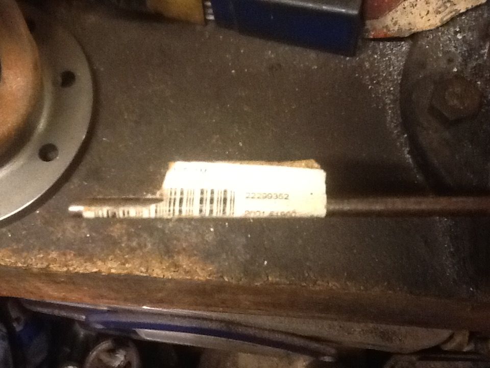

      Was doing a little job this afternoon for a mate extending 2 keys to fit in a lock in a thick door. Needed to make a couple of extensions an inch and a half long to braze in. As I was turning the extensions down it rang some bells on various comments I have seen on here re unknown material quality (stuff from scrap bins and DIY stores) and brazed carbide tooling.
      The steel was an offcut of 6mm B&Q steel from their metal racks bought for a fabrication job ages back, still has the ripped bar code label on the end!
      B&Q steel
      I turned it down to 5mm over 1" (so length roughly 5 times diameter) but total projection from the chuck 1 1/2". Used a brazed tip tool sharpened on a green grit wheel without further honing or polishing and no tip radius to speak of. Speed was 500rpm (no science, too lazy to change) and feed around 0.003" per rev.
      Brazed carbide
      As there wasn't much to come off depth of cuts was 0.005". Surface finish was perfectly acceptable although not a mirror finish, taper over the 1" was maybe half a thou on one, which for a key shank was niether here nor there and the other came out parallel as close as I could measure.
      So for the doubters it is possible to get a reasonable finish from "odd non graded" material with brazed carbide tooling even on small diameters with a long overhang. These tools are as cheap as chips and you can grind them whatever shape you like.

          Hi Paul I agree. The brazed carbide tip tools need grinding from new as usually there is insufficient clearance and wrong shape to get a good finnish. I use them for roughing out and braze my own if I need a special shape or type of cutter. As for the steel from B and Q if you just need a bit of steel without any special property's no problem.
