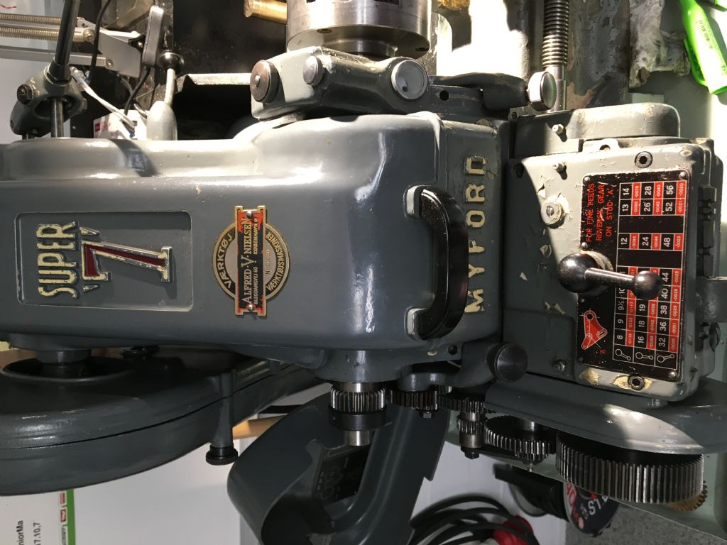

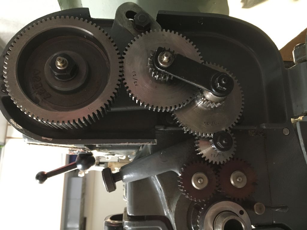

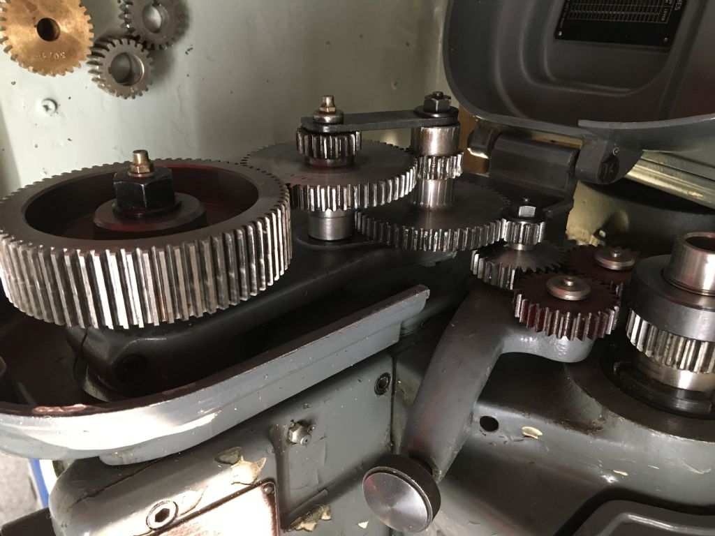

      Dear members
      40 years has gone since my education as a fine mechanical engineer and also 40 years away from machining I just bought a Myford Super 7 anno 1955-56 (2 years older than me) for making various bits and pieces. First job was to make a nut with an internal thread M62x1,25 for my Arboga Milling machine. Made in Stainless steel all turning and slotting went very well but the pitch wasn't accurate
      The super 7 is delivered i July 1956 to Greenland, Serialno SK 4986 with gearbox serialno QC 1942. I just have the fitted gears
      From spindle: 30, 30 and 28 fibre, 30T/12T, 57T/19T, 57T/19T, 72T(on the gearbox)
      Main priority is metric threads but I also need some inch cutting.
      I'm obviously are missing some gears; have read in here about a 33T and 34T but assume it won't fit my machine – or if – where to fit and where to get them
      I hope for some useful help – all the best from Jesper in Denmark
      I didn't figure out how to insert picture

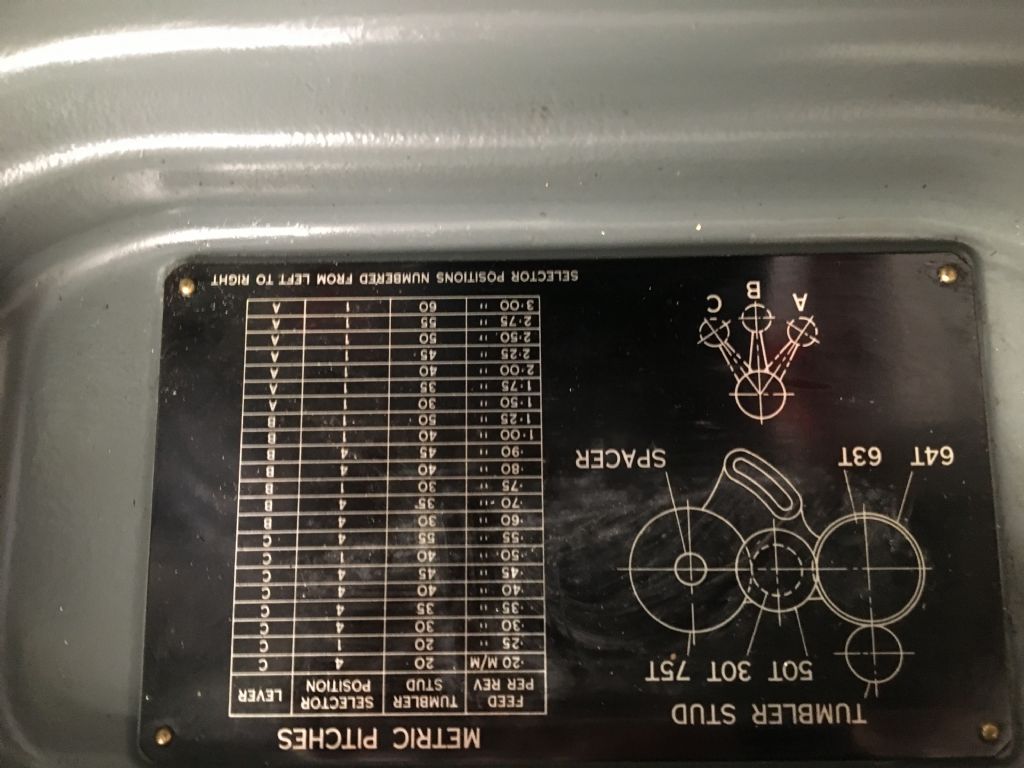

                                  Ah ha!
                                  Hello again Jesper, and thanks for the pictures. You obviously sussed out how to load them!
                                  But…….
                                  The plot thickens! Because the label you show from the inside of the gear cover isn't the right one! That label belongs with the standard Myford metric banjo kit, which was marketed to go with the NEWER gearbox, not the one you and I have got. The 2:1 gear reduction factor has to be taken into account.
                                  So here is a picture of the label inside the cover of the gearbox I have.
                                  If you have followed the links I showed earlier you will have realised that this is irrelevant, as using the 17 or 16-1/2 compound input gears sidesteps this problem.
                                  HTH Simon
                                  #438604
                                  Roderick Jenkins
                                    @roderickjenkins93242
                                    My best guess is that the gearbox is a later addition to the lathe, it certainly looks similar to the gearbox on my S7. If this is the case then the 33/34 T system will work.. The gears are available from RGD **LINK**
                                    This table shows the actual pitch of threads that can be made with this arrangement:
                                    Rod

                                        #438682
                                        Roderick Jenkins
                                          Hmm. Jesper's pictures seems to show a manual for the later type of gearbox as well as having the later plate in the cover. The 1680 gearbox is the same as retro-fitted to my S7. How can we determine which gearbox Jesper actually has?
                                          Rod
                                          Edit.  I've  just had a look at Tony's Lathes site and I see that 1956 was the year of change to the newer style gear  box.  Could Jesper's be some form of transitional box , old externals but new internals?
                                          Edited By Roderick Jenkins on 24/11/2019 23:25:16

                                              Jesper – good evening. Firstly my apologies for not picking up your questions sooner, I've been out of touch for a day.
                                              So, if I may I would like to summarise what we think we know, and answer your question about obtaining the requisite gear.
                                              I believe we have established that you have the older type QCGB, that's what the photo's of the lathe indicate, and the fact that you have a 30/12 cluster gear in the gear train on the mandrel gear suggests the same. What we don't know for absolutely certain is whether the lathe cuts the threads as indicated on the gearbox label. It's just possible that there is a mismatch here, and the gearbox cuts either twice or half the threads per inch that is indicated. This of course is when you are cutting an imperial thread such as 20TPI. The label inside the gear cover sows a seed of doubt in my mind, and I would just like to be sure we know where we are starting from before telling you what to do next. Can you try cutting a thread with the gearbox set up for (say) 20TPI – it needs only be a scratch pass to prove the gear train – and confirm that it is 20 TPI that you get.
                                              I chose 20 TPI because it is the same thing as 1.27 mm pitch – and if the M62 nut you were trying to make is only fairly short you may find that using a 20 TPI thread instead of 1.25 mm pitch gives acceptable results. After all the error is only 0,02 mm per revolution – so if your nut is 10 mm thick the thread error is still only +/- 0.08 mm.
                                              However, we can do better. ASSUMING the gearbox IS the old one, the gear train you have identified starts with a 30 tooth gear with a 12 tooth gear married to it to make a compound gear. This gives the thread per inch selection as per the label on top of the gearbox.
                                              If we change the 12 tooth gear for say 18 teeth we'll get a different set of TPI values for each position of the gearbox selector levers. In this example the gearbox output is speeded up by 50%, so our 20 TPI setting will now cut 13.3 (Edit – I got this wrong in my initial post – it's less TPI because the lead screw is running faster.  OOPS!)  TPI. Using other input gears gives us control over the threads on the workpiece over and above the "normal" (standard settings.
                                              One such choice is a 17 tooth gear. If we change the 12 tooth gear to be 17 teeth, and set the gearbox levers in the positions for 24TPI we get 16.94TPI, which equates to 1.499 mm pitch. The arithmetic is simple pro-rata gear ratios, but work it out in TPI and then convert to mm pitch last.
                                              So that's a nice accurate answer for 1.5 mm pitch. also 3mm, and 0.75 which is an oddity but it shows the principle. How do we go about getting 1.25 mm pitch.
                                              Do the same arithmetic, and you find you need a 16-1/2 tooth gear. Now whatever I've said before, I haven't worked out a way of making a single non whole number gear. But it isn't a single gear we're working with , it's a compound pair. The other gear of the compound pair was always 30 teeth, giving a 1 : 1 ratio with the chuck, but it doesn't have to be.
                                              16-1/2 : 30 is very close to 16 : 29, so if we change the input gear to be 29 teeth meshing with the tumbler gear, and now 16 teeth driving the otherwise standard gear train going down to the gearbox input we get jolly close to 1.25 pitch. And 2.5, also 0.625, another size we're likely never going to want!
                                              Enough for a moment, this post is long enough already, I'll continue in a second instalment.
